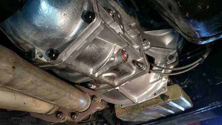

    Hi, can anyone help me to identify this gearbox please? Its taken out from my 240z. By looking at the box, would it be able to tell what is the ratio? The previous owner mention he did something to the gearbox during early 90s, but couldn't remember if it was changed or overhauled. Thanks!

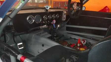

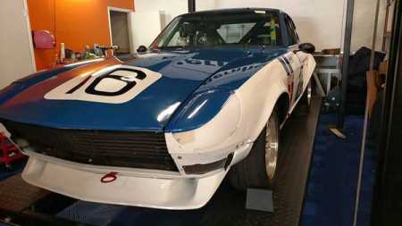

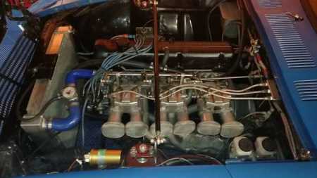

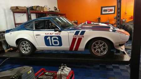

  9. https://www.motorsportauctions.com/category/358/Historic-Touring-Cars/listings/38939/Datsun-240Z-Historic-Macau-FIA-Race-Car.html 66,950 usd

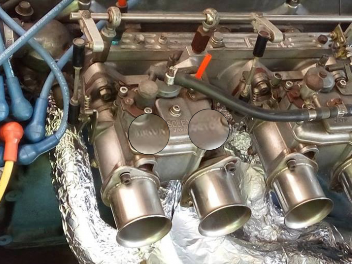

  16. Gav, you Should start a tread on mikuni solexs identifications..
  17. That q-style prices are very crazy..hehe food luck. I notice something also while searching for your type. Both are type 4, but one with "mikuni kogya" wording another without.
  18. Gav, Try this site. They do sell standalone carbs. http://www.q-style-cab.com/3.html I believe yours is called type 4 in japan. Kameari catalogue has a list of parts and identification. http://www.kameariengineworks.co.jp/Catalogue-v3/catalogue-068.pdf Got 1 set here http://www.jauce.com/auction/h202938622
