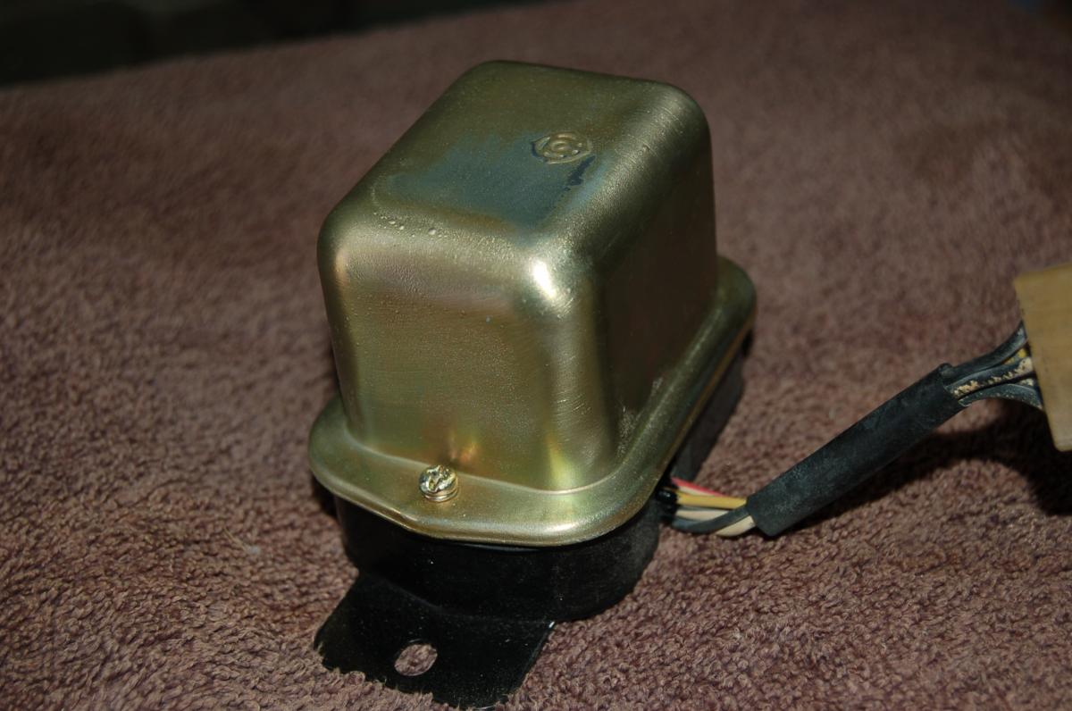

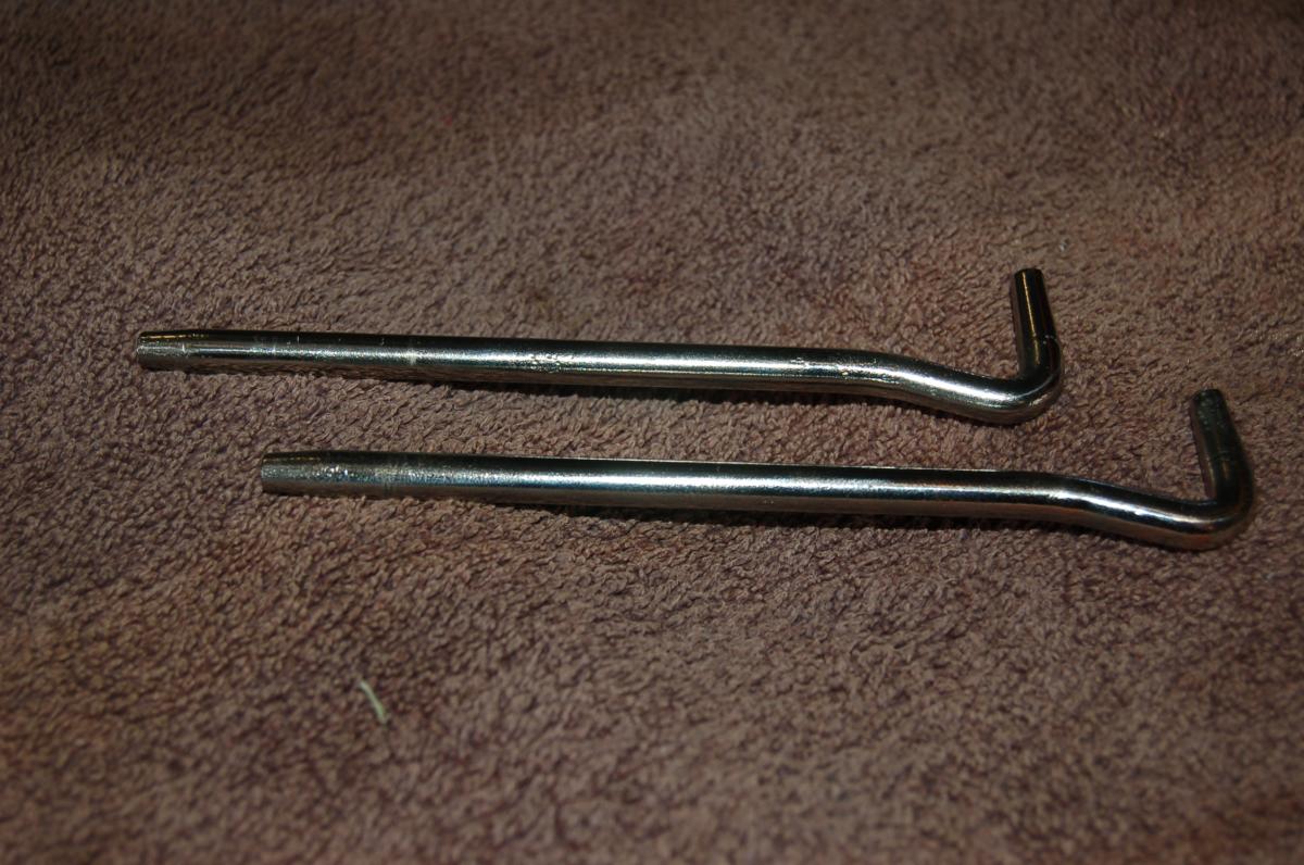

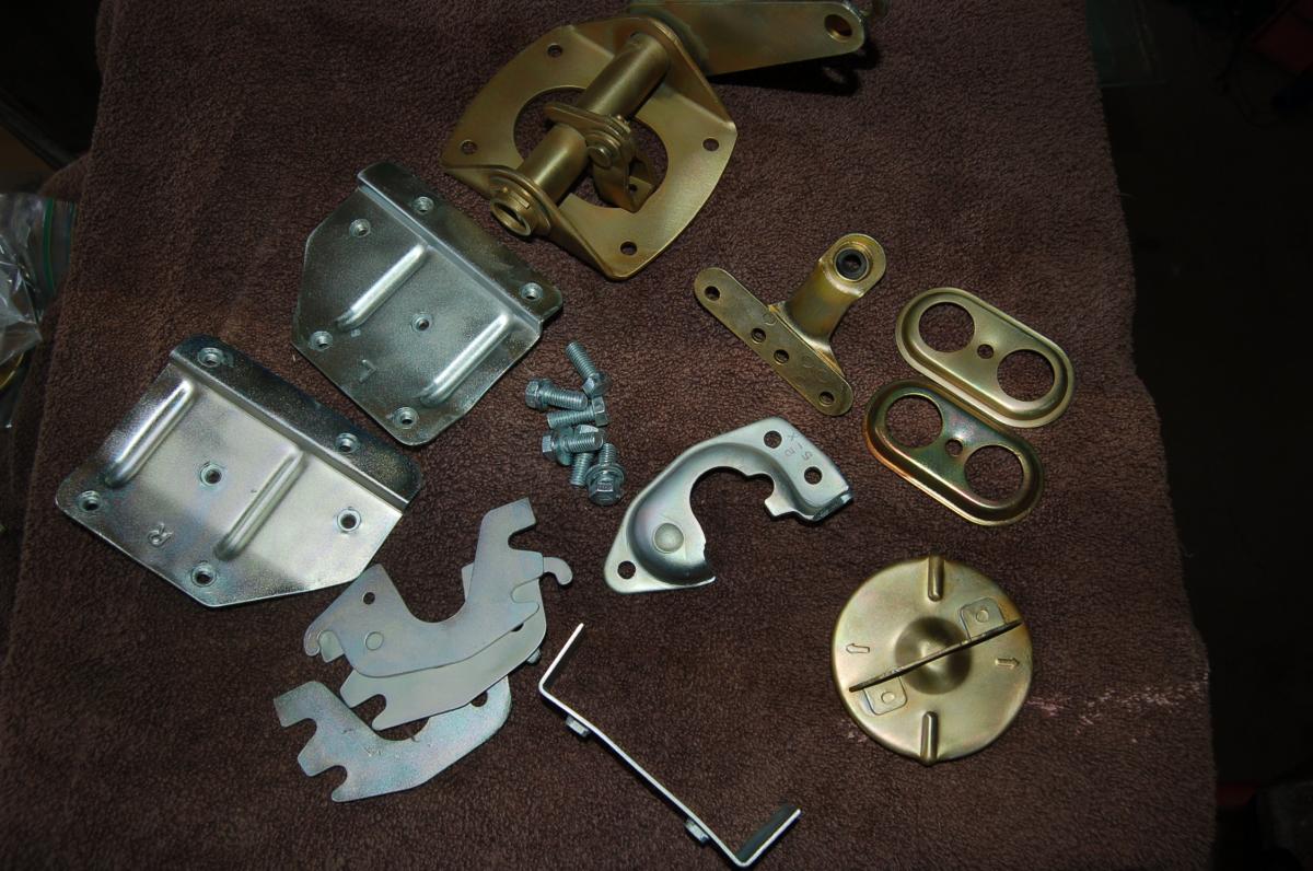

    i am unable to post a photo as I cannot work out how to do that on this site. If you send me an email to bsharp05@outlook.com I can reply with a photo and details for my address.

  23. Before I sold my engineering business 4 1/2 years ago we used to get large quantities of bits zinc plated in Brisbane. They would only do silver zinc. Excellent work but on occasions they did loose parts. In some cases I think they left them in the acid wash too long and they dissolved. I have actually fitted 3 45mm DCOE Webbers to my vehicle but I am rebuilding the Hitachi's just for the experience of doing the zinc plating. I'll probably offer them up for sale when they are done.
