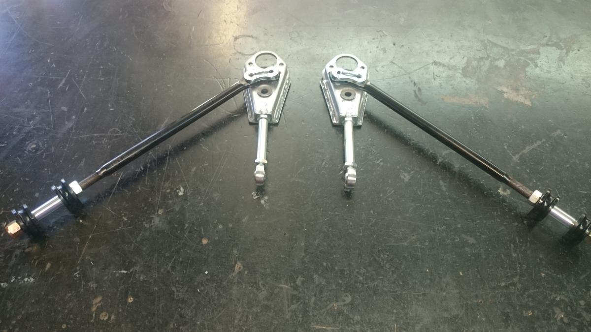

  17. Just completed my second car show on Sunday with around 600 other entries and took out best 70s modified car. Lots of positive feedback on the build and the kids enjoyed the scene. The mod on the suspension has made the car handle awesome definitely a good thing. It has allowed me to square up the wheels and adjust every thing front and rear.we the

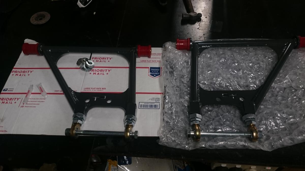

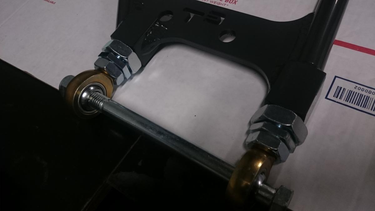

  18. Just a few new bits to bolt on from TTT. They will definitely make the rear wheels sit in the correct position now unlike the factory slightly forward and offset position. Very nice piece of kit. Just sucked that the Aussie dollar is so crap right now.

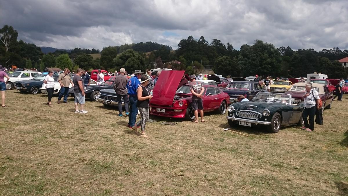

  20. Built. Not bought.

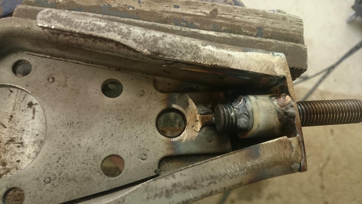

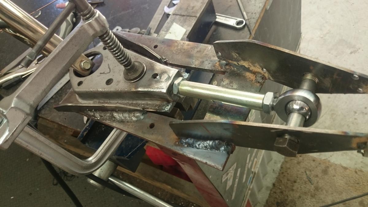

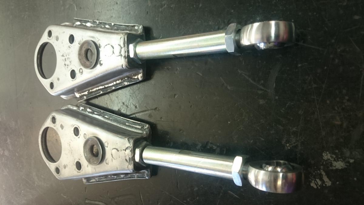

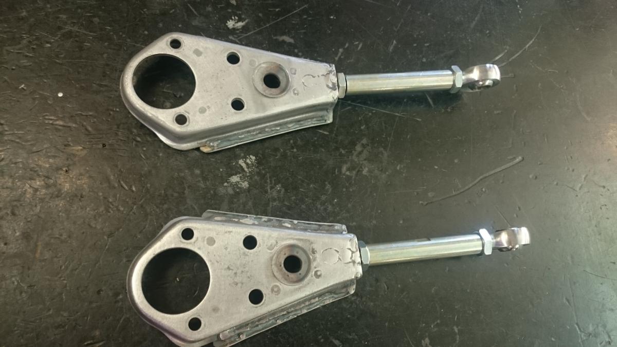

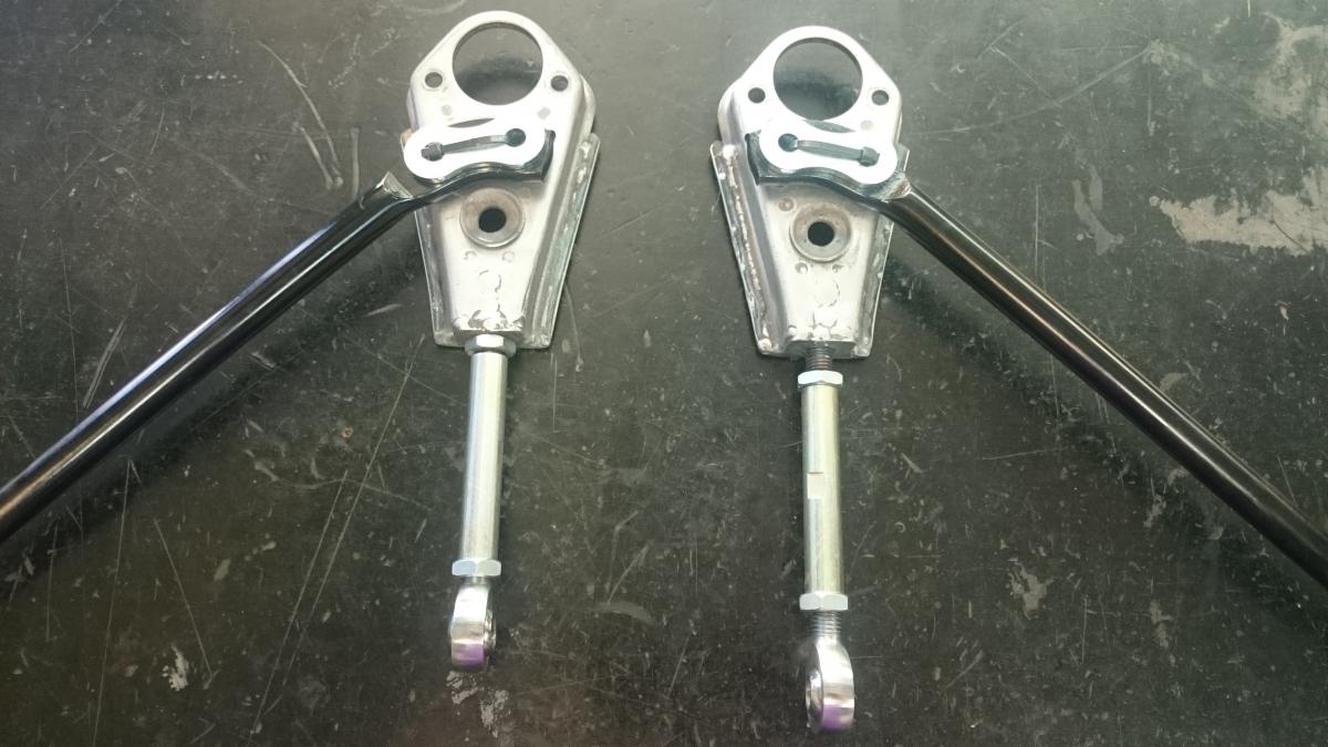

  21. The parts arrive from the UK the other day and spent half of the day cutting, grinding and tig welding the pieces back together to make a set of adjustable on car lower control arms. This is my first real attempt of tig welding and I am quite impressed with the results. Alot cleaner than mig and very controllable. I will send them off to the powder coaters tomorrow. The under side of the arm and rear were replaced with a lot thicker guage of steel than the original, and the gig that I made worked a treat. Just waiting for a few more new bits to turn up before the install.

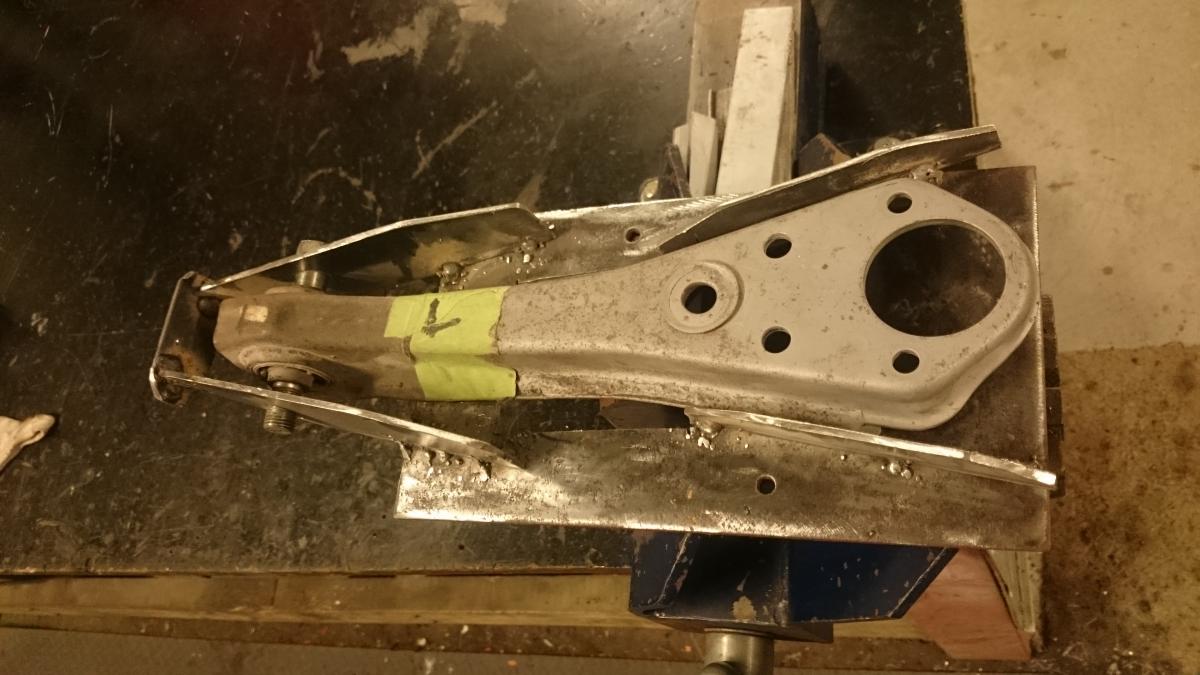

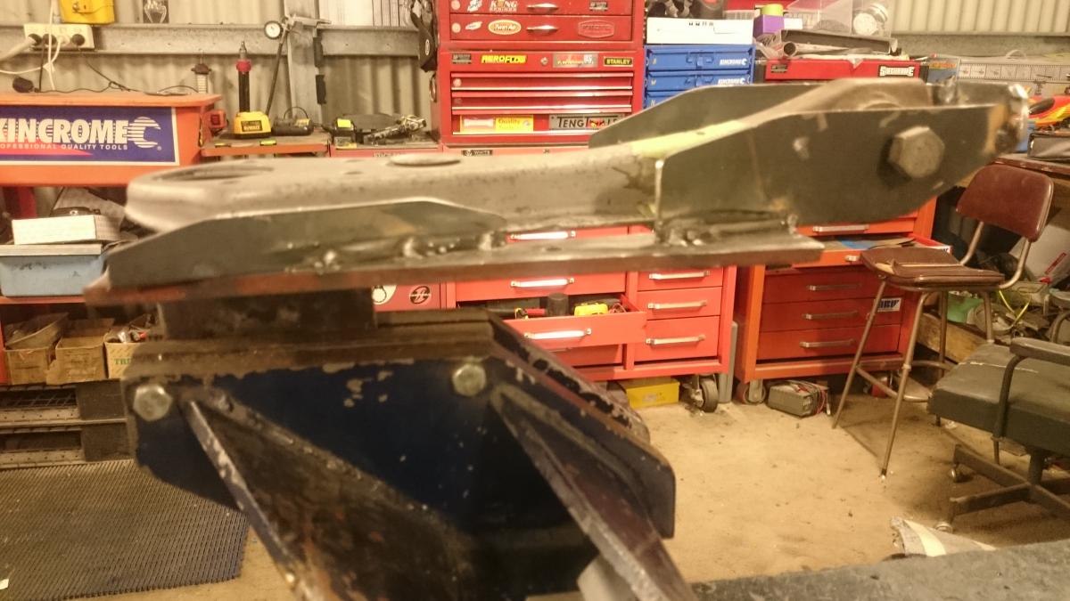

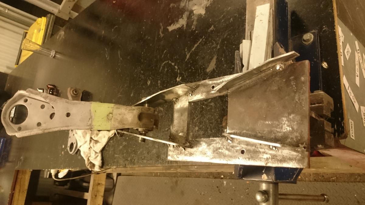

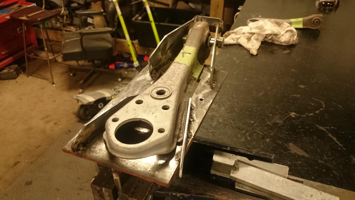

  22. It is time to make the car handle a bit better now as I have a lot of power pushing the front around. I have purchased a set of adjustable front tension bars from sw motor sport and they are a lot larger in diameter to the z bars. I am currently in the process of modifying a set of front lower control arms from my donor z while still enjoying driving the beast. I made a jig to hold the arms in place while I cut and join an adjustable thread and rose joint to them like the TTT units you can buy. The parts should arrive later this week, more photos to be posted upon progress. I am always wanting to refine this car into something awesome and the shed time is therapy.

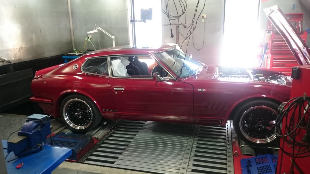

  24. The car goes like a rocket now. Before the tune the computer had a basic run program and was 147kW. After the tune it was 250kW. It was a hot day and ambient air temperature didn't help but the difference is amazing. The LS1 is also stock so lots more power to unlock if required. The torque is 600nm and it pulls like a train.
