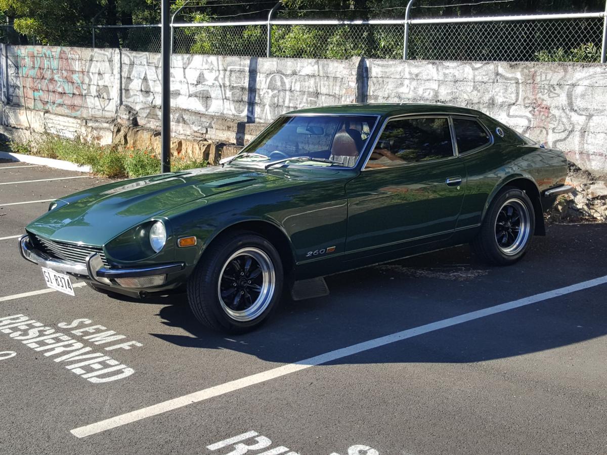

  1. Thanks guys. They are the old school xxr 513 in a 16x7 plus 14. The rears could have been much wider as the 2+2 archer's are massive.r Tigers are a 205/55/16. Front is 3mm clear of strut rear could have run a 225 easy.

  4. Guys i finally got some rims for the Z, they are a 16x7 +15 XXR513. Question, rims fit perfect so no issue there, wondering what width tires to get 225/55/16 or 215/55/16. WIll either rub on a 260z 2+2 Car is in the tire place as we speak so any answer woudl be good.
