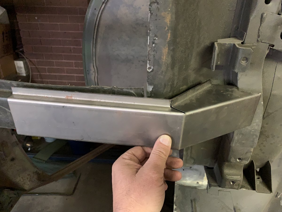

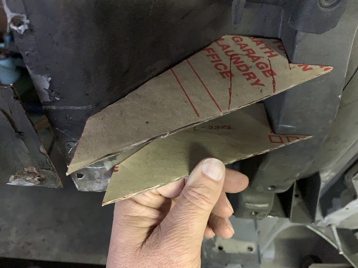

  6. And now for the rear profiles
  7. So you go to crank up the mig after 18 months and it’s cactus ! So off to the store and its like the Gods are looking after you Bossweld reduced from $650 to $270, happy days, and this thing welds effortlessly So on with it, first rail front profiling done, later an inner and outer contoured reinforcement plate will be added to finish it off cheers John

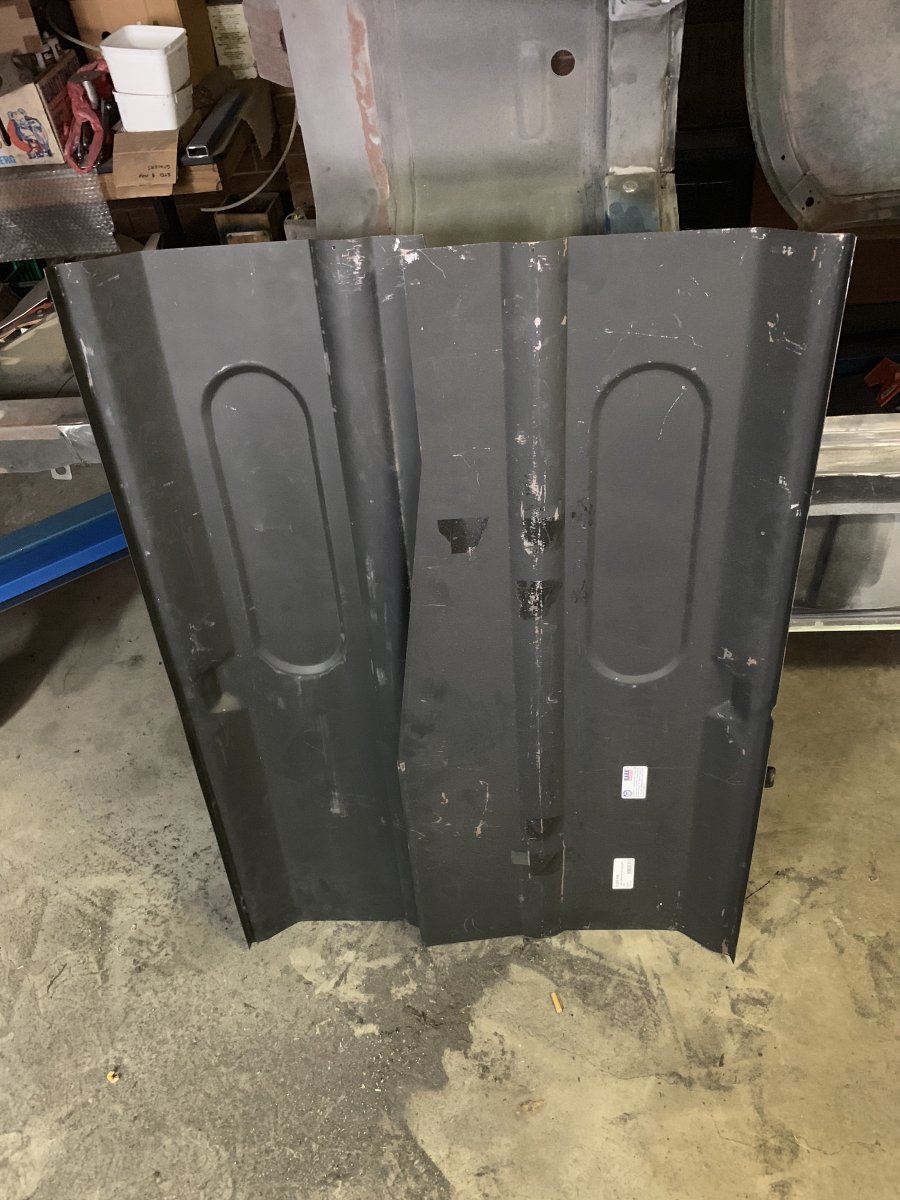

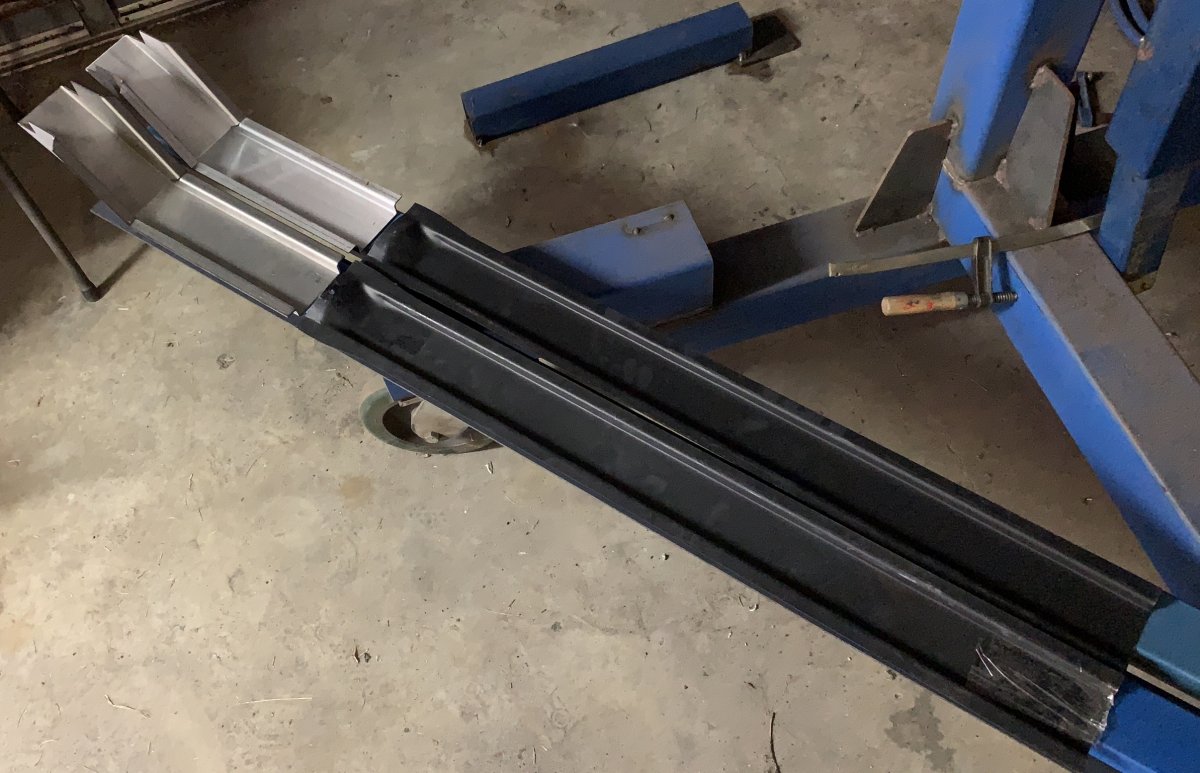

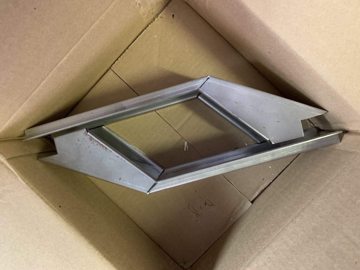

  10. Ok so I’m back on the tools but no have some items surplus to my needs I imported the U.S. made Bad Dog 240Z rail extensions, masterfully made but due to the rear sway bar set up on my car I’d rather not hack and modify them so I’m going down the custom fabrication path instead  Also left and right hand Rare Spares floor pans and rails, they sit fine but once again my manic state tells me to go custom pans and rails considering the tunnel mod So all in all around $850 worth of metal up for grabs as a complete fit out shipped for $750  Merry Christmas all  PM if interested
  11. Ok so I’m back on the tools but no have some items surplus to my needs I imported the U.S. made Bad Dog 240Z rail extensions, masterfully made but due to the rear sway bar set up on my car I’d rather not hack and modify them so I’m going down the custom fabrication path instead Also left and right hand Rare Spares floor pans and rails, they sit fine but once again my manic state tells me to go custom pans and rails considering the tunnel mod So all in all around $850 worth of metal up for grabs as a complete fit out shipped for $750 Merry Christmas all PM if interested
