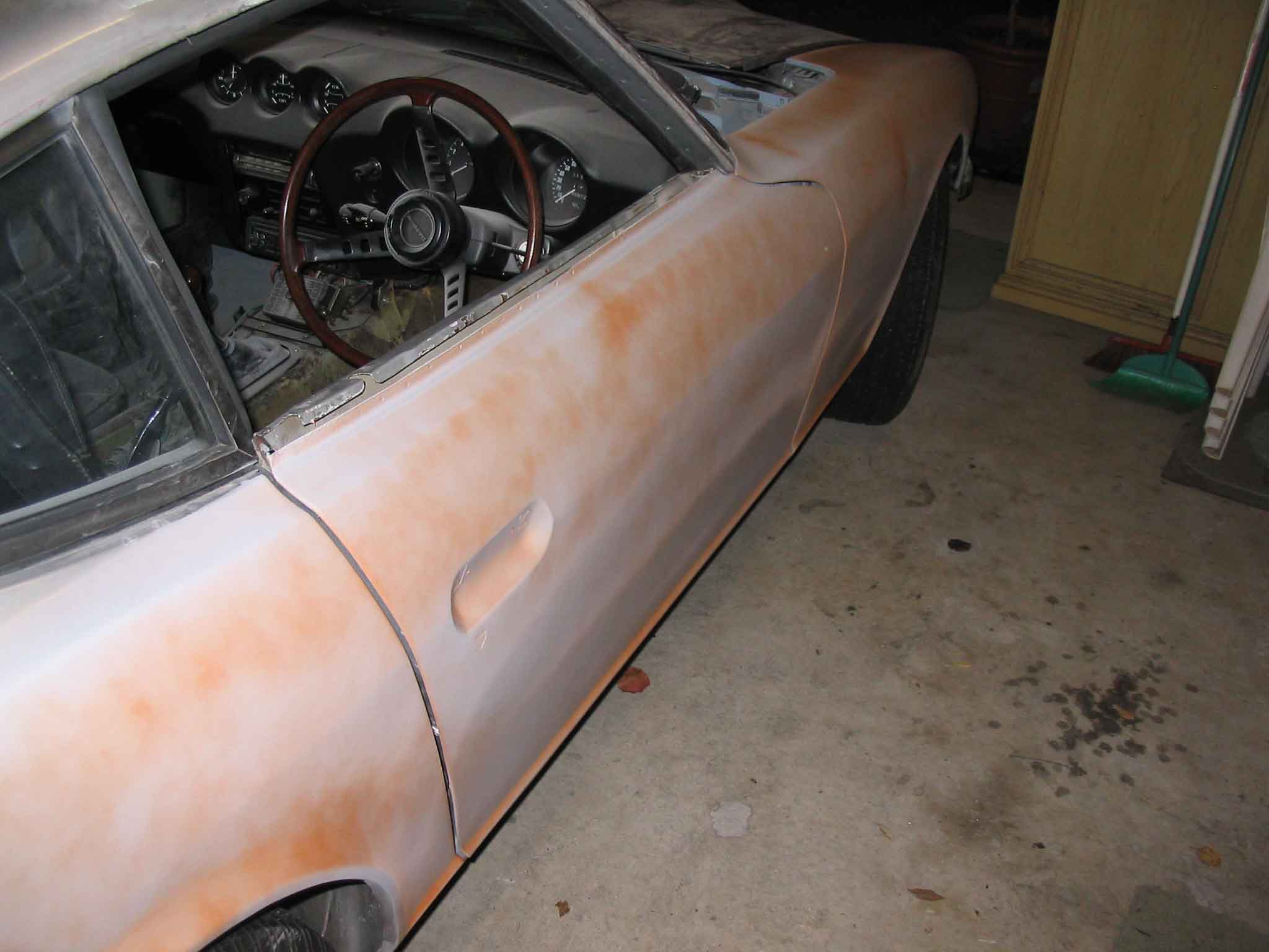

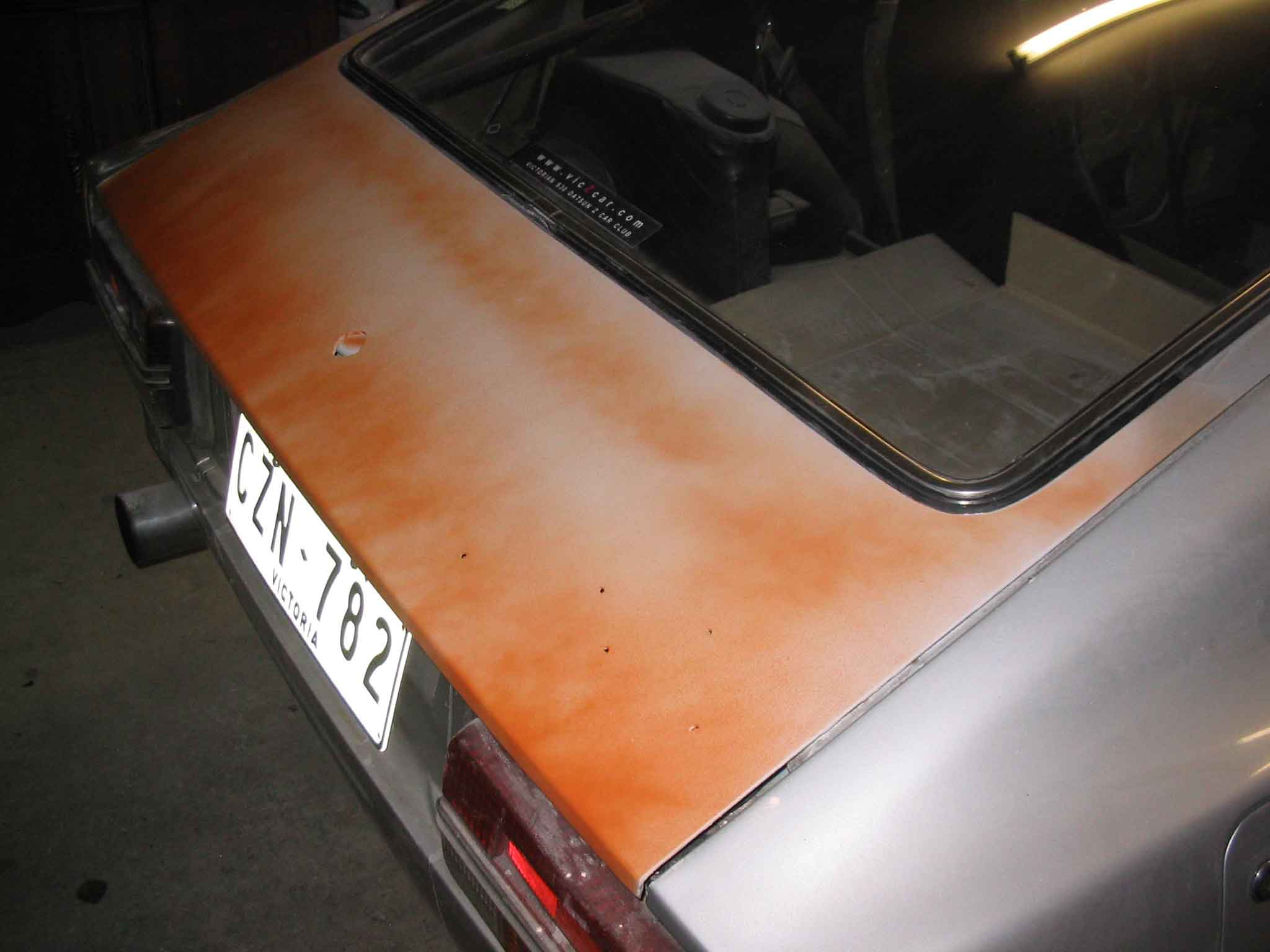

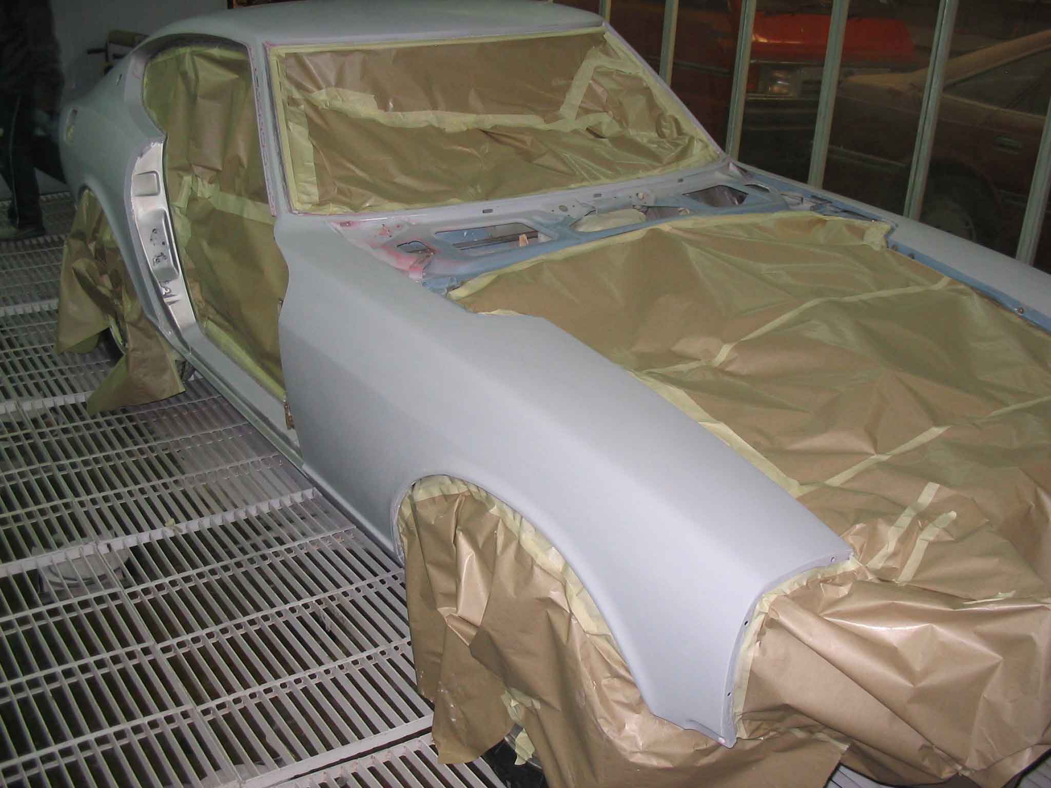

warrenz Posted June 26, 2007 Posted June 26, 2007 Got the 240 back from the body shop today after 5 weeks. This is what was done:- New door skins fitted and primed, I painted them with POR15 on the inside before they went on. New dog leg rust repair panel on the passenger side and primed, once again treated with POR15 on the inside. New Hatch Panel welded in, underside and the body treated with POR15 before being welded in. Holes in hatch from spoiler fitted by PO welded up and hatch primed. Front guards primed as they were rust repaired by replacing the lower section some time ago and zinc dipped. All panels aligned ready for paint. Next up..... I will remove all glass, lights and any remaining bits and it will be delivered back to the same shop for complete respray in same silver colour Nearly there... at last Cheers Warren Quote
nat0_240_chevZ Posted June 27, 2007 Posted June 27, 2007 all rust gone??? but glass is still in? bit sus, as we all know wait til the glass is removed, opening another can of tin worm!!! specially the 1/4 windows, up top under they factory lead fill on the rear pillars, just a word of warning!!! nato ps 240 is now awaiting a metal finisher i know to bring it all up ready 4 paint also another 4-5 weeks till he starts, (probly another 15 years till im finished lol, nah said it should be turned around by xmas, but i still got a massive surgery to happen b4 then, anyone after some medical grade titanium???) Quote
warrenz Posted June 27, 2007 Author Posted June 27, 2007 That thought has crossed my mind but I am banking on the fact the rust was only in some of the normal places and not that bad, but I decided on replacement repair pieces to do it properly. I hope to I can prove you wrong. Warren Quote

warrenz Posted July 2, 2007 Author Posted July 2, 2007 The Side quarter windows are out as wll as the from windscreen and not one spec of rust The rear window is proving a little stubborn, I do not think it has been out since it was manufactured in 1973. Rubber is brittle. Today I ordered new windscreen rubbers for front and rear from AllZparts in Sydney so can attack the rear rubber with a knife. Here are a couple of pics that I could not post before due to upload problems. Cheers Warren Quote

warrenz Posted October 23, 2007 Author Posted October 23, 2007 Nearly there, should get it back this Friday, fingers crossed Warren Quote
