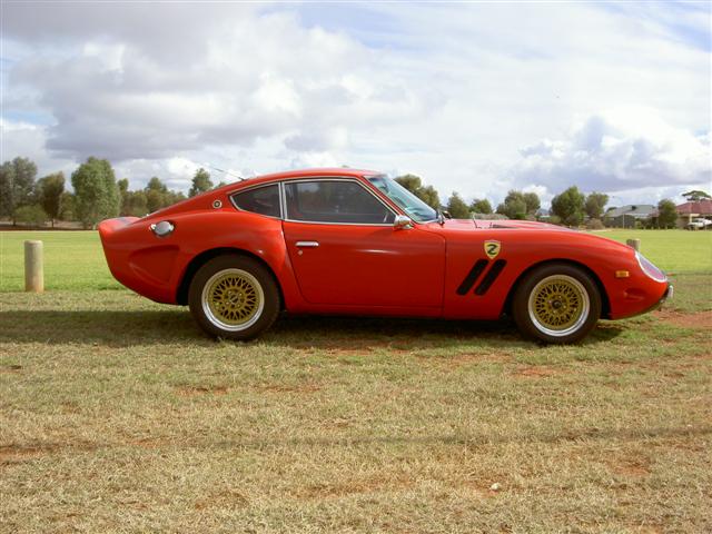

Enzo Posted July 5, 2012 Posted July 5, 2012 Hello, http://www.classicrevival.com.au/ Check out Classic Revivals web site. I have included a picture of my 1976 260z with the modified side windows. Good luck if you decide to go this way as a lot of time and effort is required. But in the long run, you will have something different. Quote
Zedback Posted July 5, 2012 Author Posted July 5, 2012 Thanks all for your input, a member has contacted me and unless something miraculously pops up in Bris (ie. Z-Shop) I'll take his - just have to figure out how to get it up here from Sydney! enzo250GTO that's a nice looking ride. No matter what route I choose it's going to be a lot of work, but I like the lines of the kit I think to minimise the engineering compliance issues I'll patch up and weld the rear quarters back on. If I get anywhere with this I'll post it up in the project thread, though at the rate I go that might be six months or more Quote
