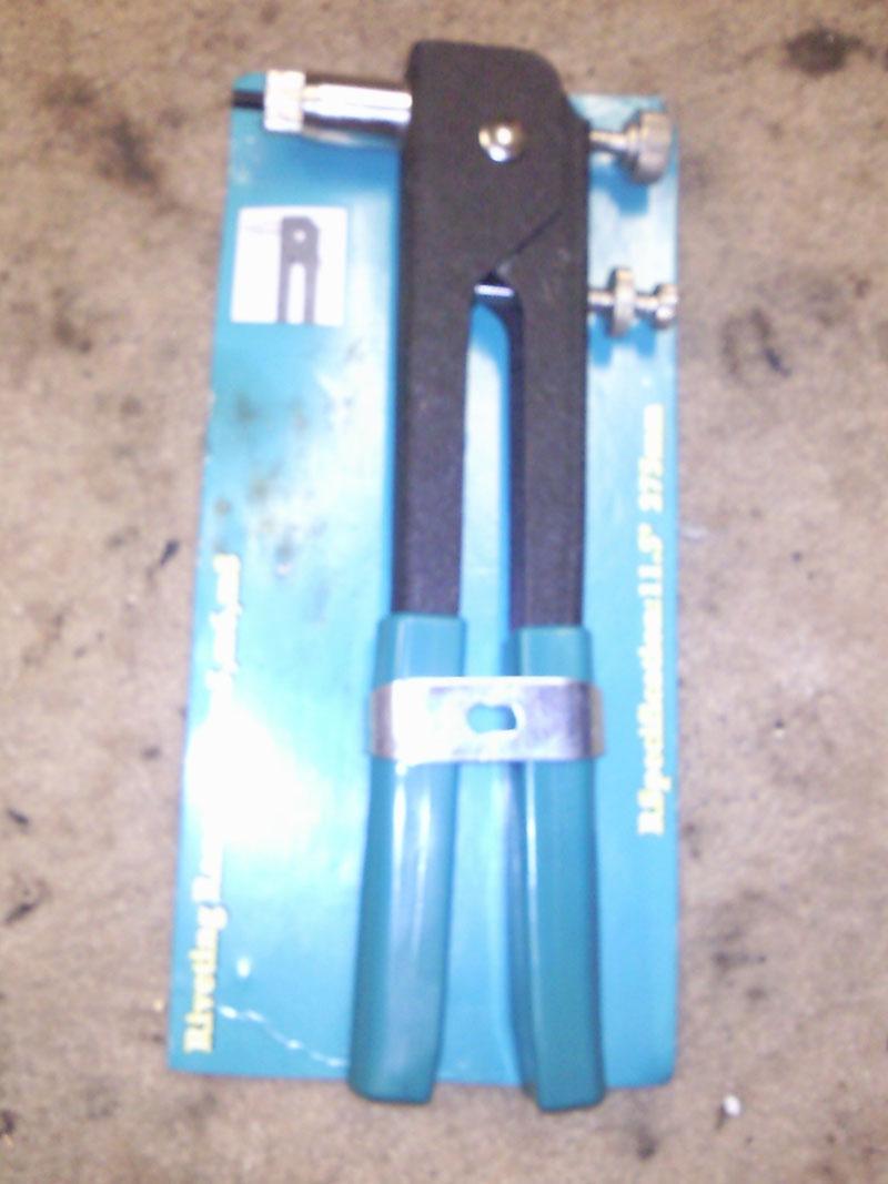

zzzzed Posted June 8, 2012 Posted June 8, 2012 Mine cost me $25 I made it from a standard pop rivet gun. It is very simple to do. I have fit two sets of flares with it already and it works well. If any one wants know how to make one I will post up a short how to thred. Quote

zzzzed Posted June 8, 2012 Posted June 8, 2012 But when it is as simple as it is to convert a pop rivet gun it is very worth it just for the convenience. Quote
handsandwhich Posted June 8, 2012 Posted June 8, 2012 Here ya go if you want to go full Magyver styles and make it from scratch. http://www.fjr1300.info/howto/rivnut-tool.html Quote
