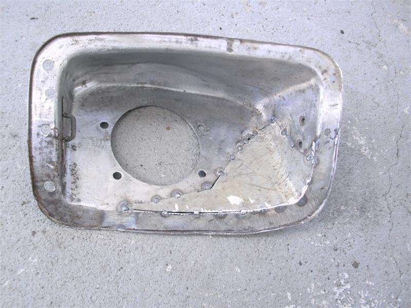

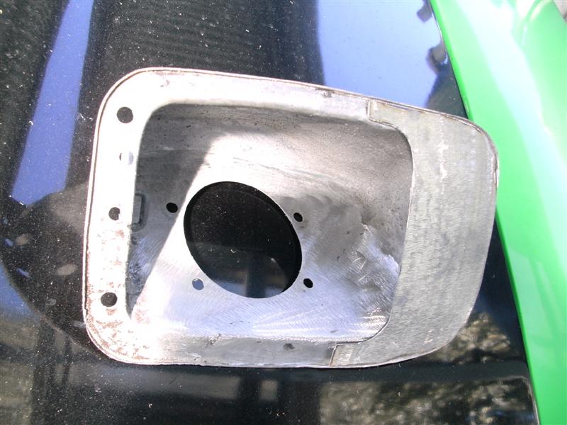

nizm0zed Posted March 30, 2012 Posted March 30, 2012 How will that get finished off Scoota? Full weld? lead wipe? Because as we all know, bog doesnt handle petrol very well. Quote
Scoota G Posted March 30, 2012 Posted March 30, 2012 How will that get finished off Scoota? Full weld? lead wipe? Because as we all know, bog doesnt handle petrol very well. Full weld finished in metal. I'll post up a pic when i finish it today. Good thing about this part is you don't see much of it. Quote
Scoota G Posted March 30, 2012 Posted March 30, 2012 With a good join and a proper weld you should need next to no filler anyways. Just ask Lurch his work is superb! Quote
