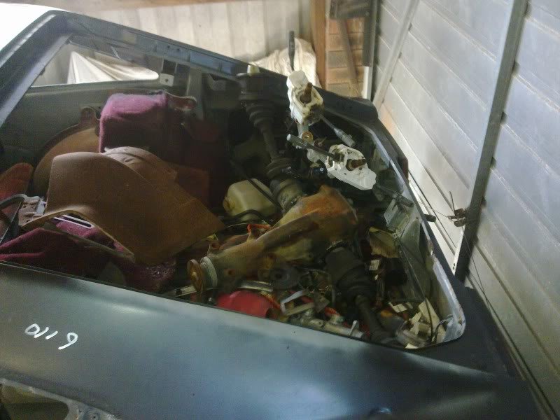

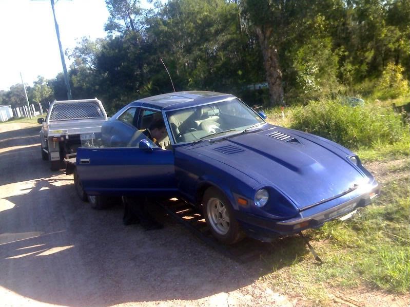

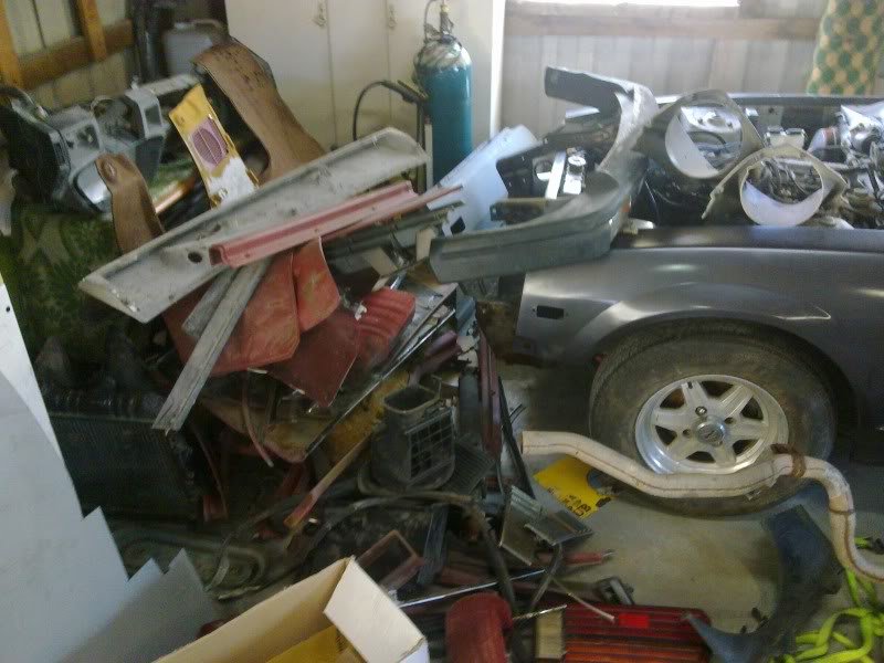

When we picked it up

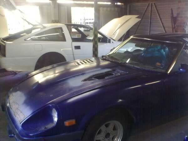

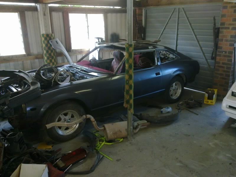

The 280 and my 300 in the same garage
After about 30 minutes of having it here

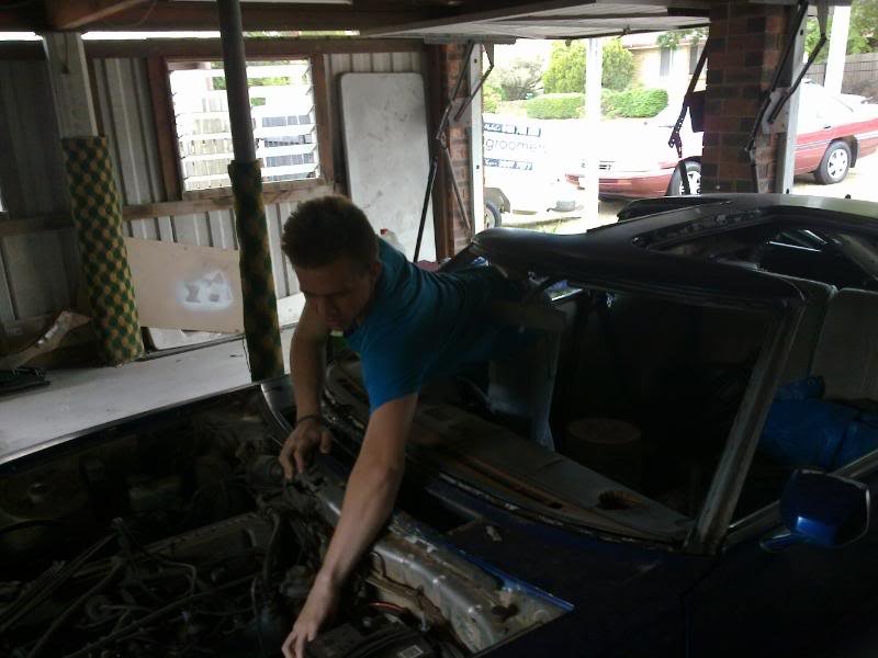

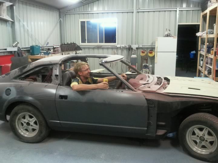

Random shot of Michale trying to reach something while he was in the car

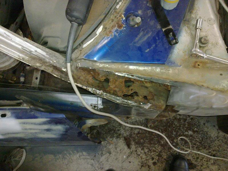

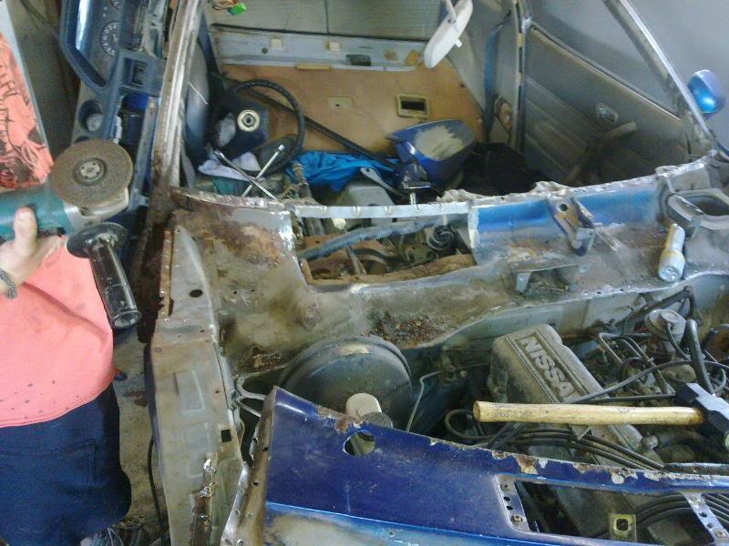

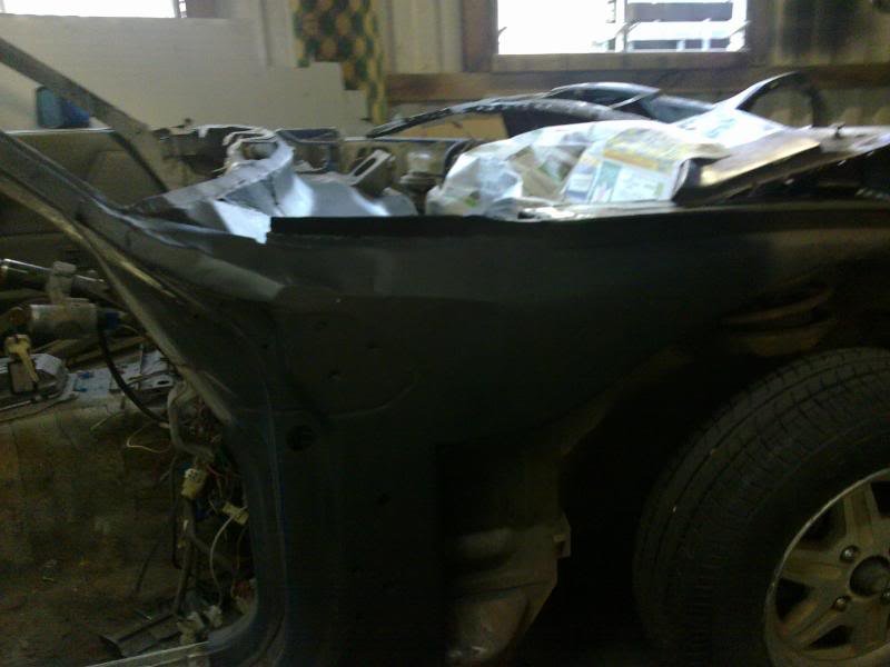

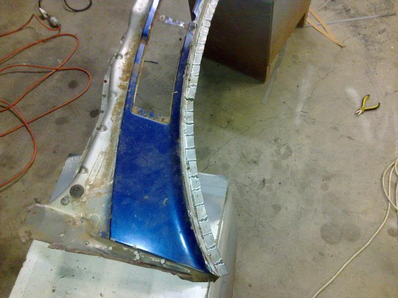

Now the fun begins

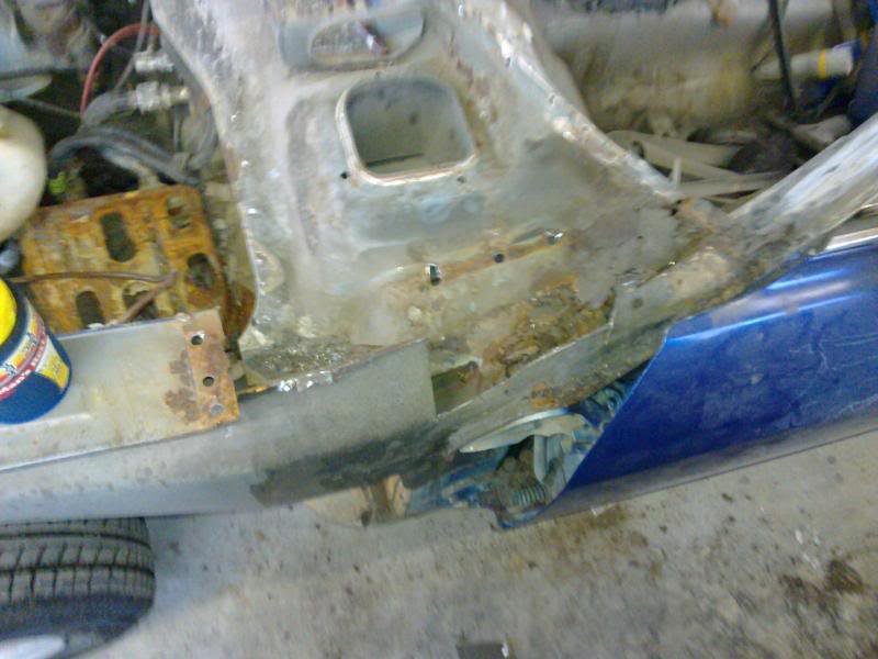

And is was here we went 'oh **** this is going to be fun'

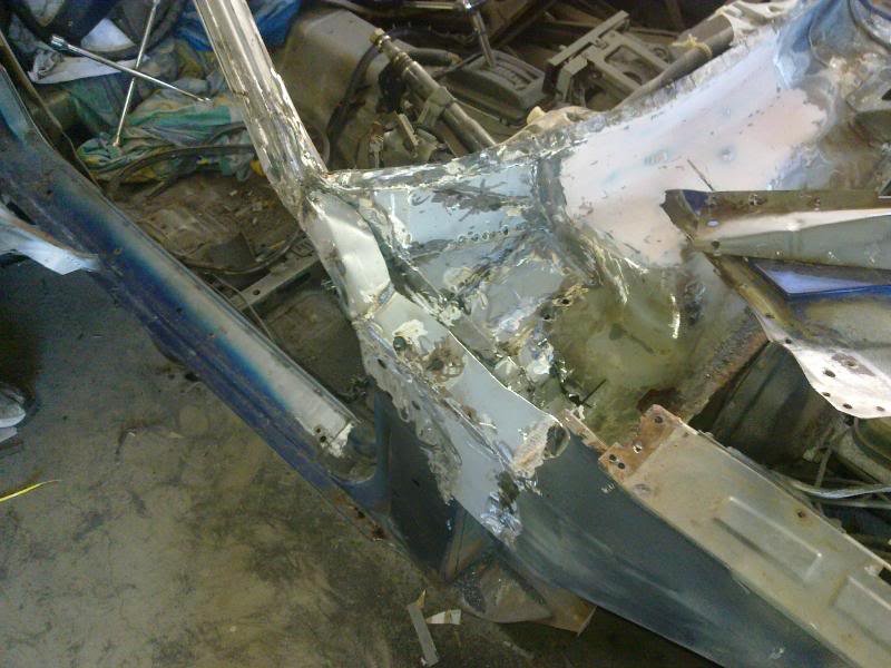

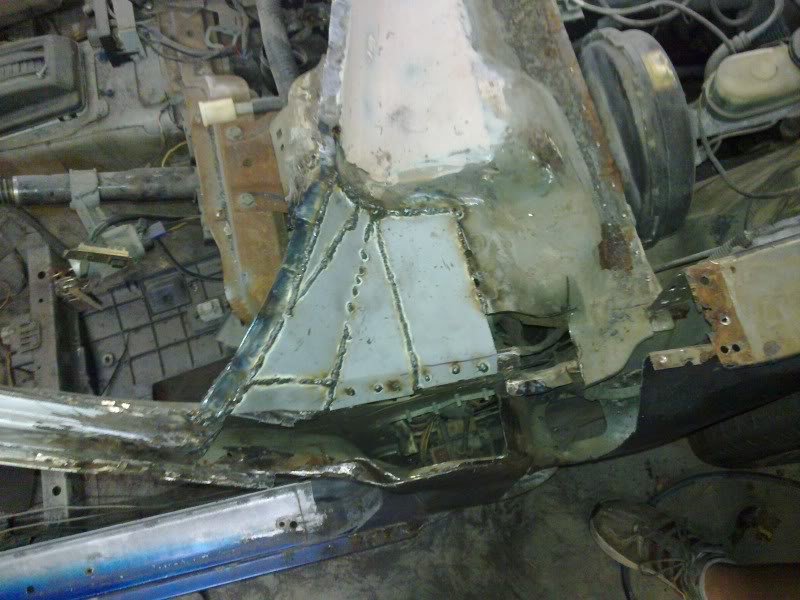

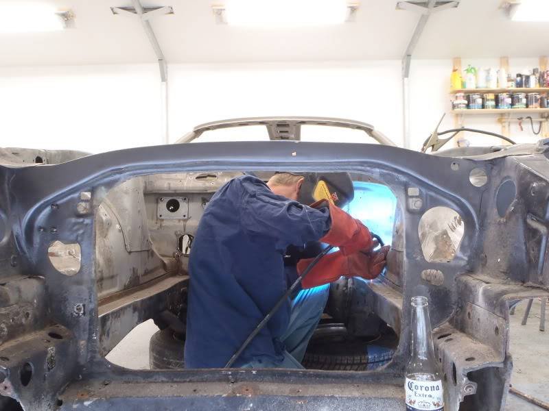

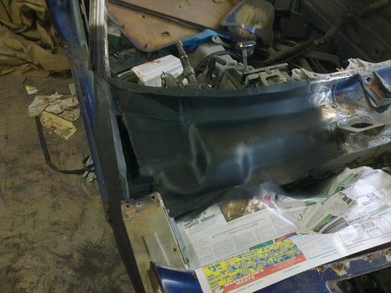

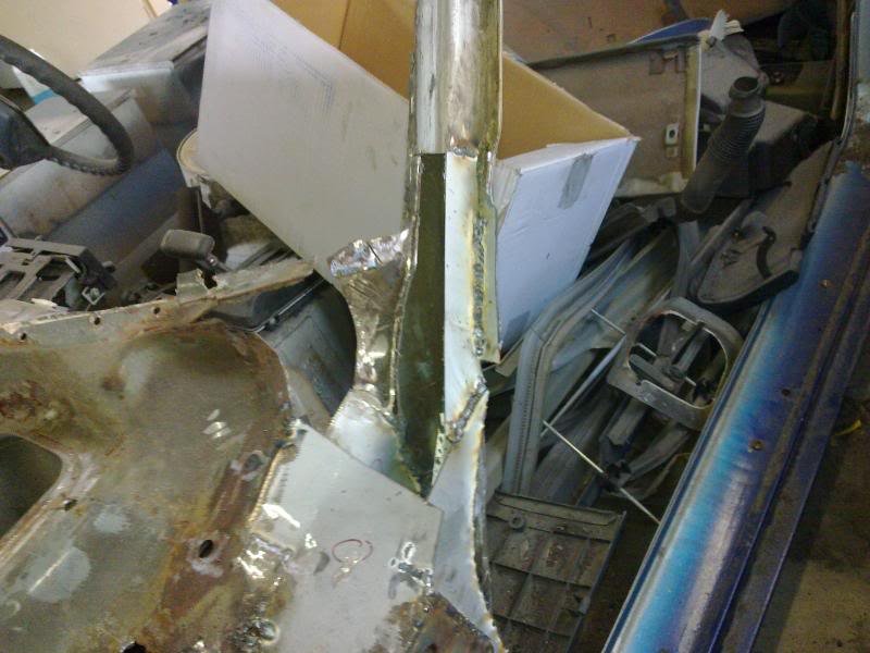

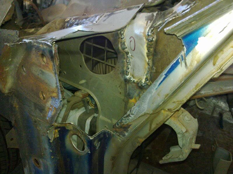

The only way to get to the rust was to remove the panel under the windscreen. this meant drilling out all the spot welds, took me a few hours to do
Michale: So how are we going to fix this?
Me: Get the grinder and cut out the rust, cut some new steel and weld in place

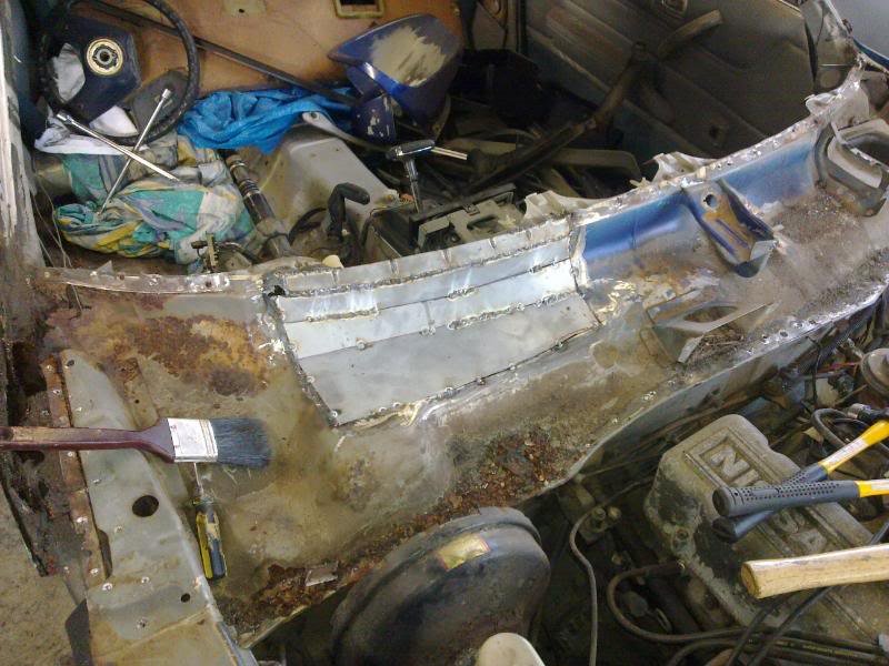

And after

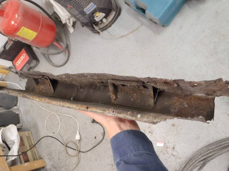

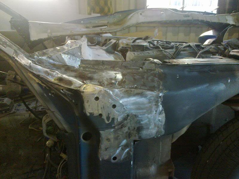

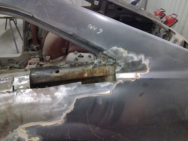

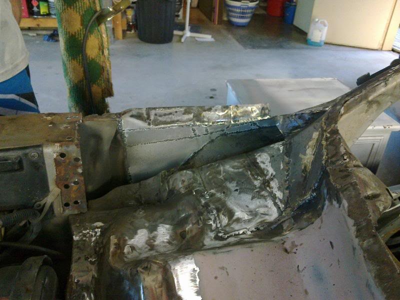

Some more rust that has been cut out and replaced, the lower part of the 'A' frame was rusty as well

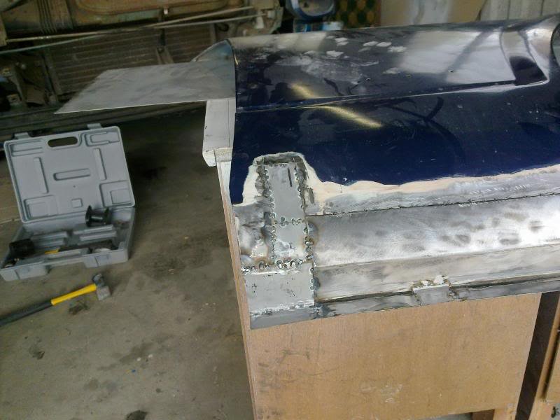

Some of the repairs that I had to do to the drivers side door
You would not believe how awkward it is to cut rust out of a door jam (on the door itself and not the body), I tried my best to keep clean cuts but given the awkward angels that was not possible with a grinder.

This area has had about 10 hours put into it, I'm not kidding either there was a lot of work that was done that will never be seen

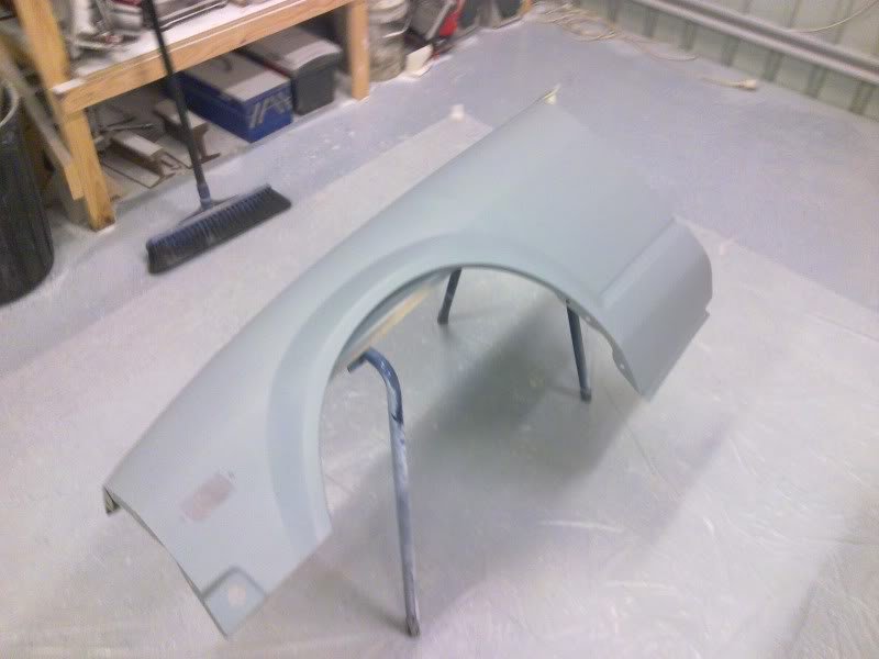

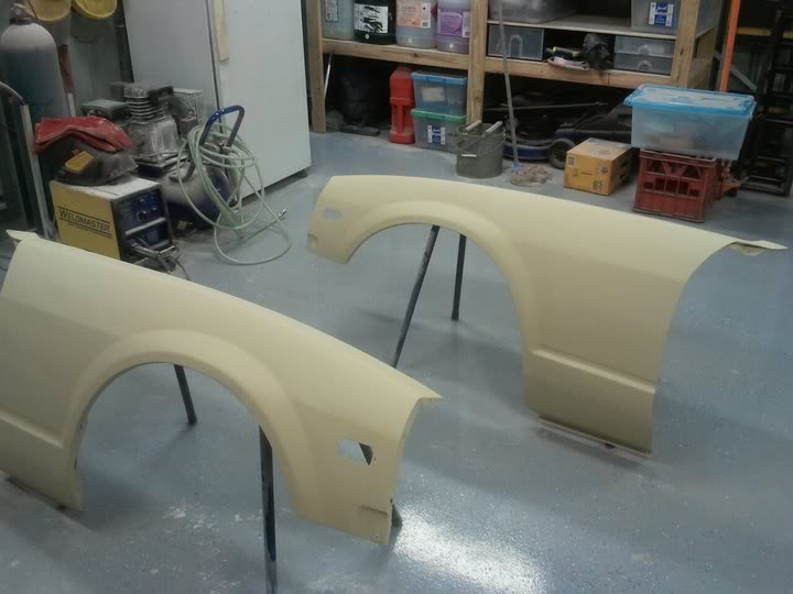

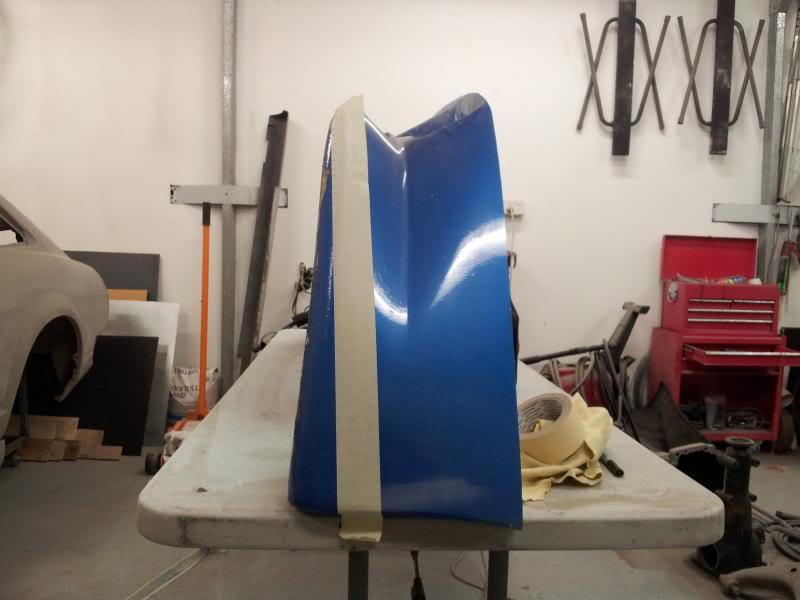

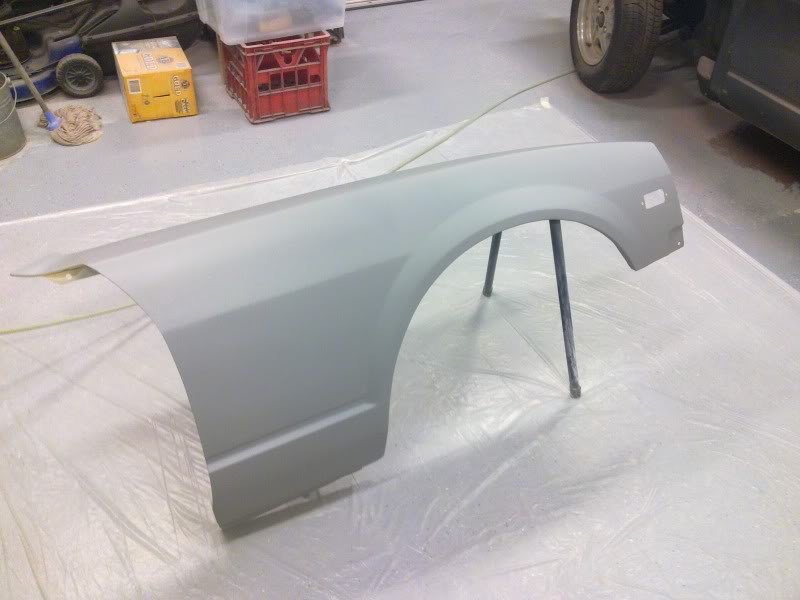

The front passenger side guard ready for paint
And the drivers side door is now ready for paint, surprisingly this took many hours to finish (see the first pics in this post)

More rust repairs, well that's about all that will be happening for a while.

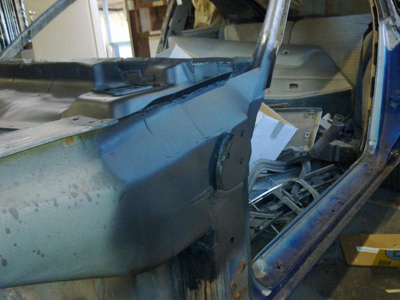

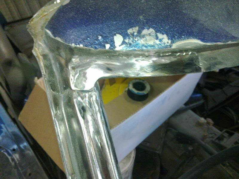

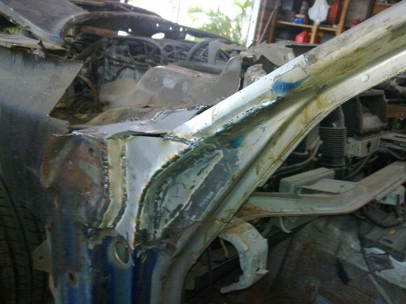

Michael finished the top corner of the windscreen surround

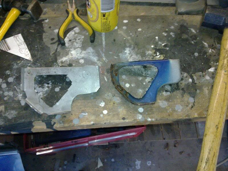

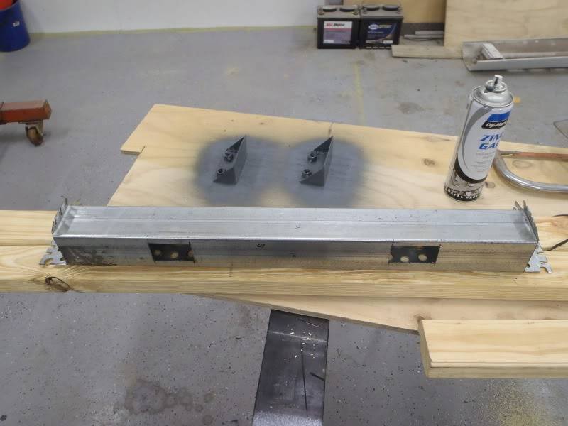

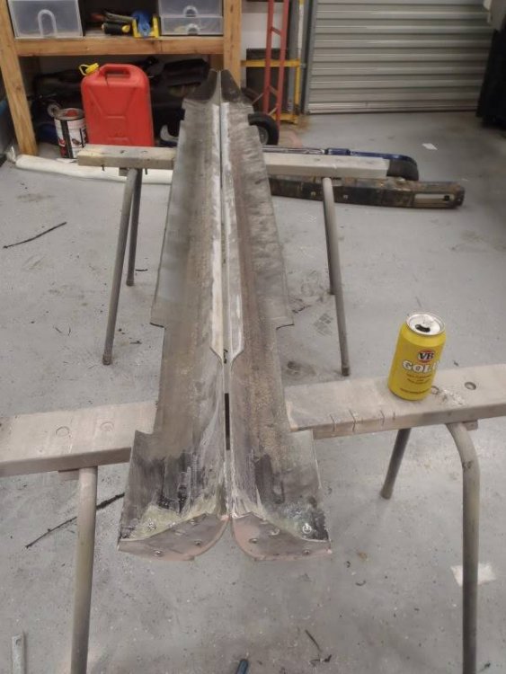

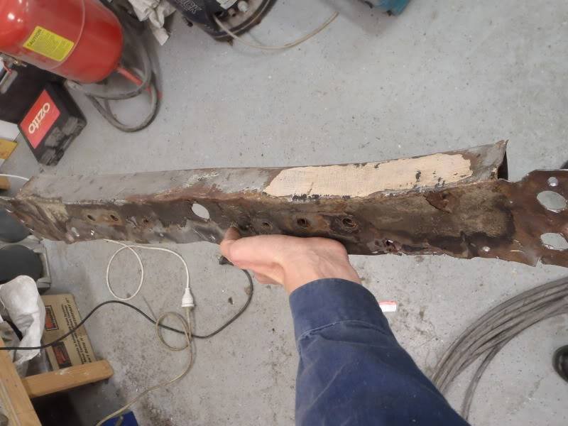

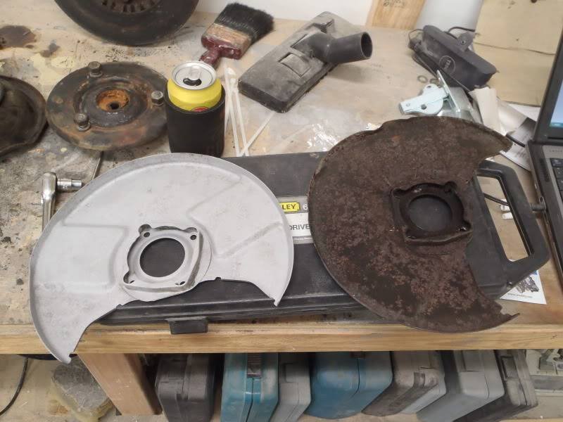

Some new brackets I have to make up to replace the rusty ones, they help hold the lower windscreen cowl to the car

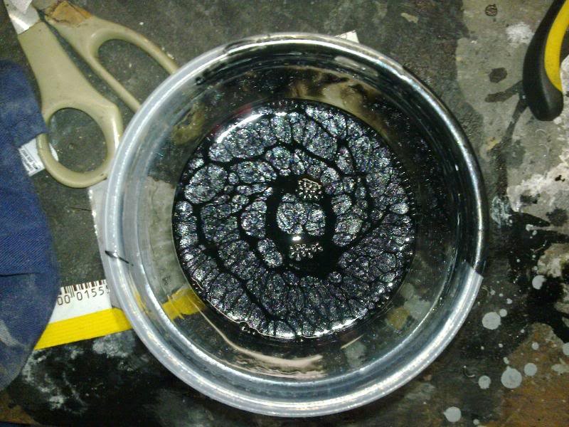

This is the color we are painting the car
and this is how it looks in a cup before spraying, all of the metallic flakes in the paint kept on swirling around while it was just sitting there... it was kind of weird and hypnotizing

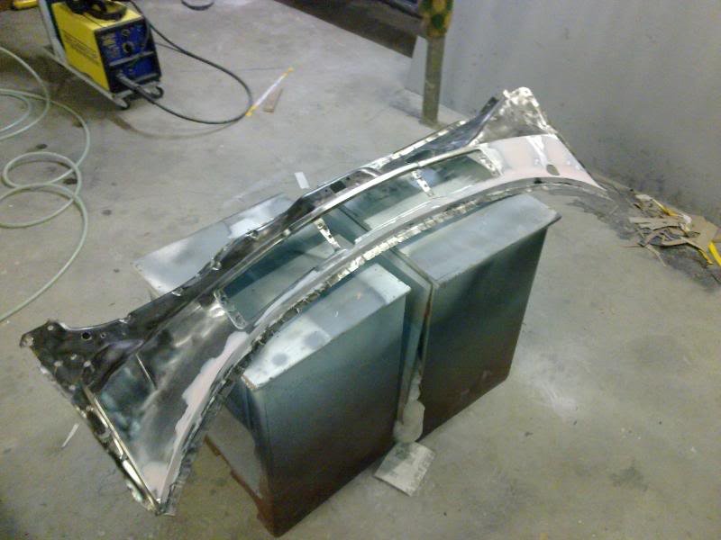

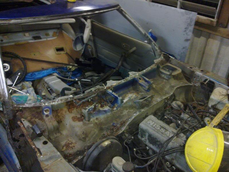

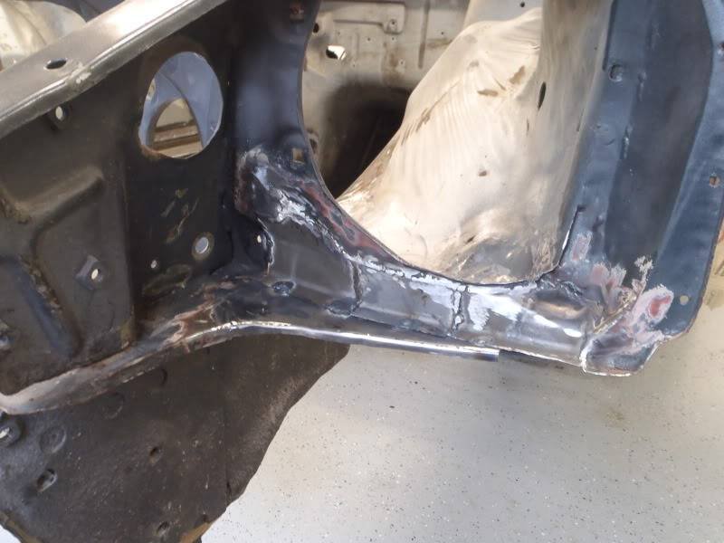

And the lower windscreen cowl is now rust free
ready to be put back on the car, just need to attach the brackets first

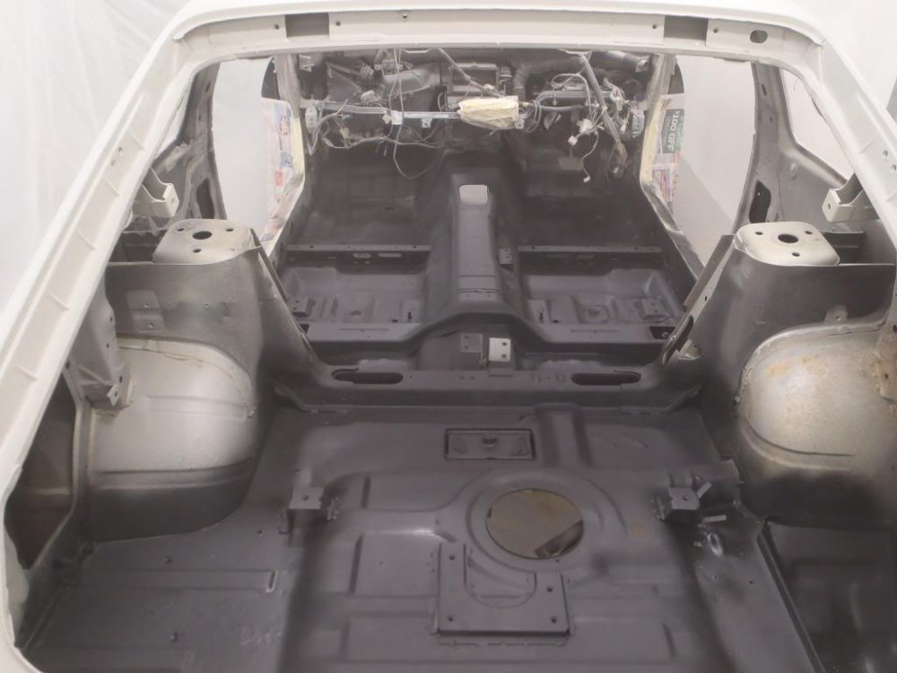

All of the areas with filler on them have had rust removed and new metal welded in, I forgot to ge a before pic of this bit

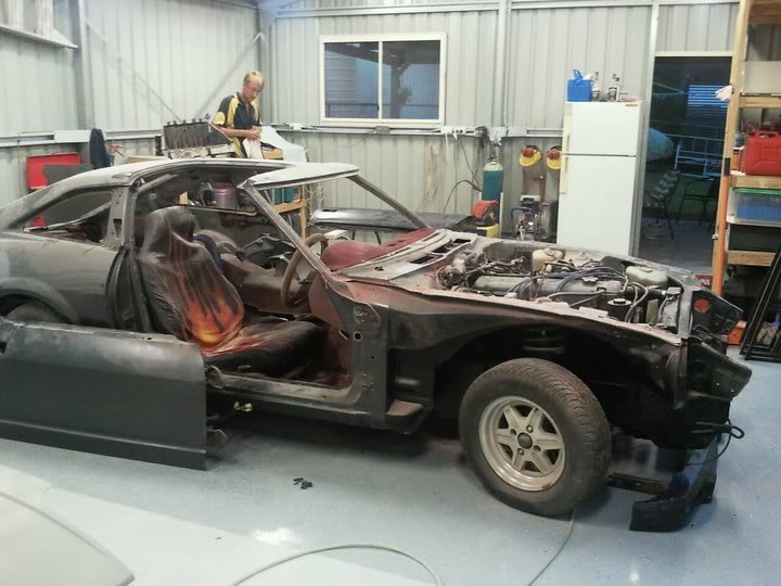

Right time to show you guys whats been happening. Well not long after my last post I was at the wreckers and I stumbled across a 280 there that was really clean and really straight, it looked like it was a unfinished project and it was FULL of parts. I asked the owner of the yard about it and it apparently was a abandoned project when a bloke had to move interstate. I asked how much for the whole car just out of curiosity and he replied with 'well I think that one owes me $500 at the moment so I'll take 500 for it'. I immediately called Michale and he came down for a look and then that weekend we picked it up and took it home. So after getting the gray car home we decided that would be the better shell to use so the blue one is now the parts car. All the parts that the gray car is missing the blue car has so it all works out quite well

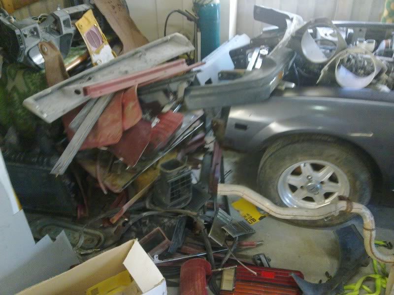

Here's some pics of when we got it back home and all the stuff it came with
It was around here I moved house and had a garage built as well as a million other things in life happened but their over now so work is happening a lot faster now

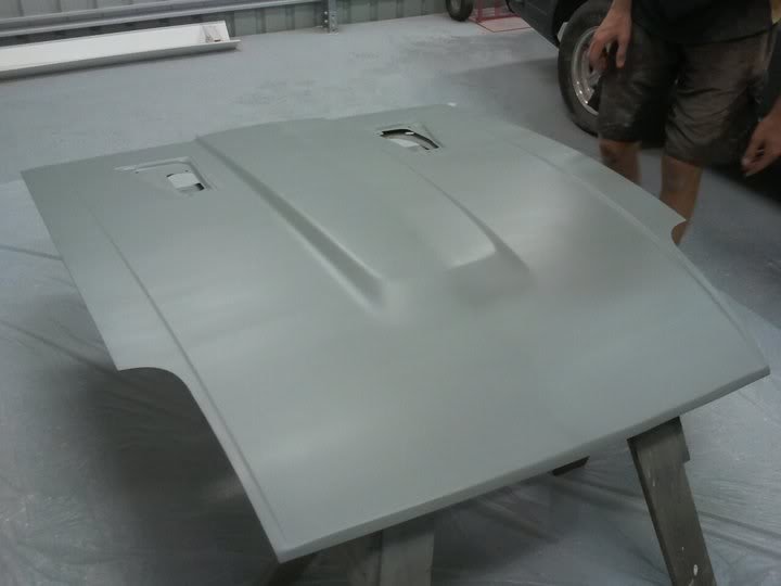

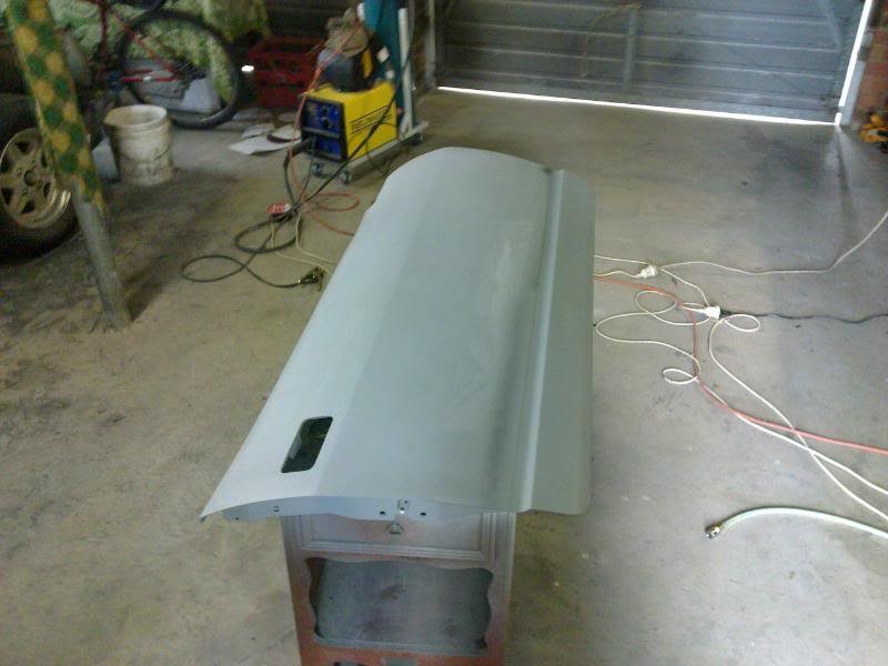

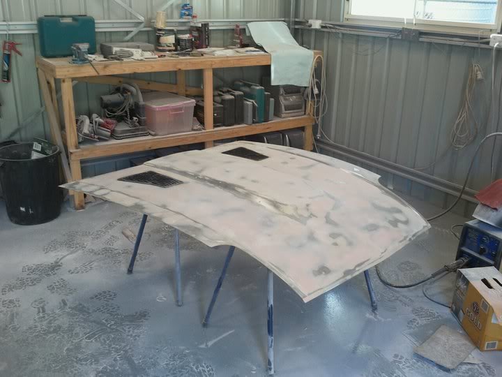

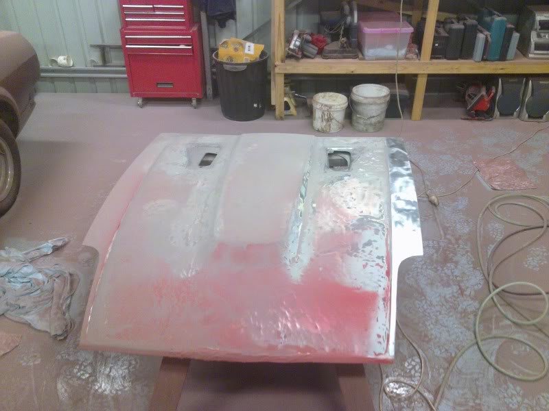

We picked up 2 bonnets a while ago and decided to use the red one as it seemed to be the cleanest underneath rust wise. I don't know why but there was about 1cm of body filler over the whole bonnet. That made a huge mess while I was stripping it.

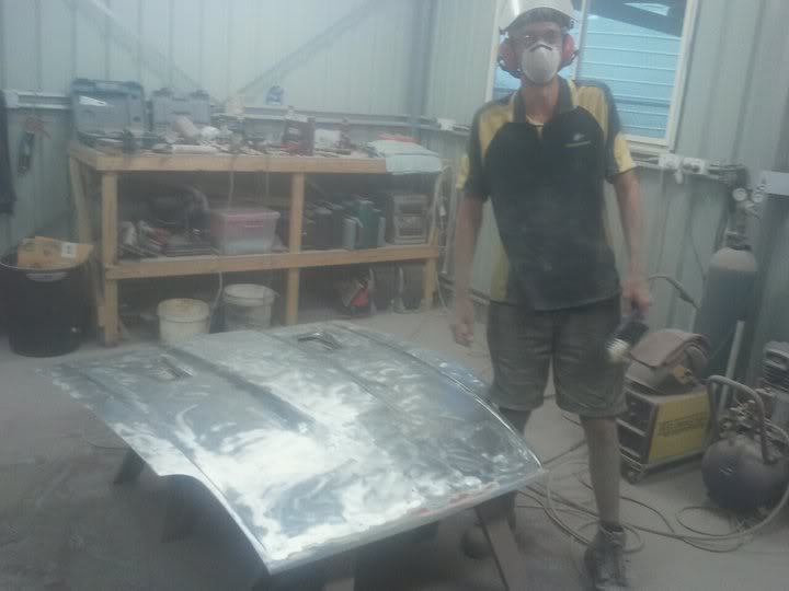

It's a dirty job but someone's got to do it
And now it's all striped, the haze in the photo is body filler dust in the air. The bonnet looks like it was hit with hail but nothing too serious
My floor after wards

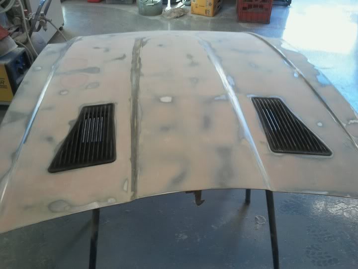

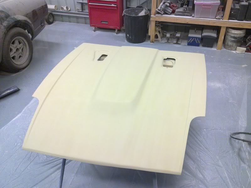

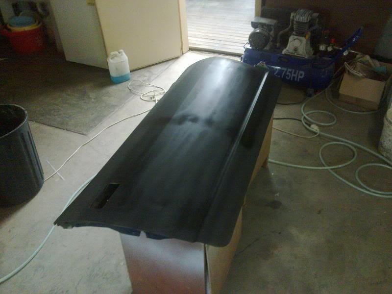

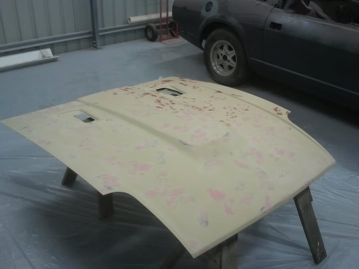

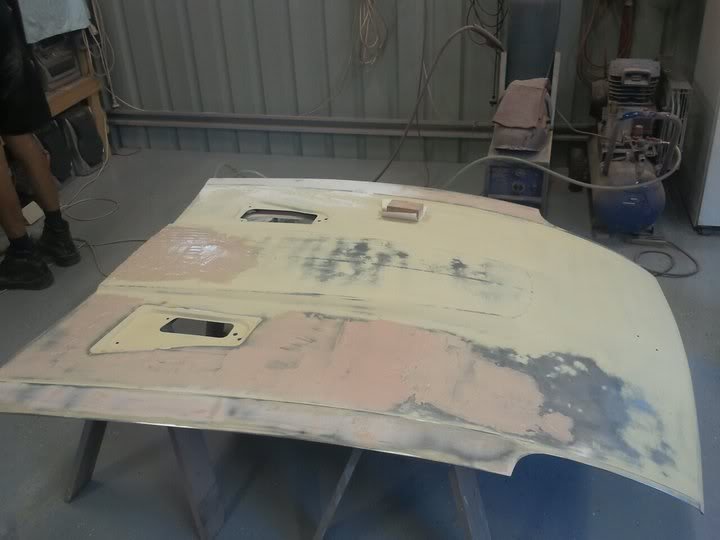

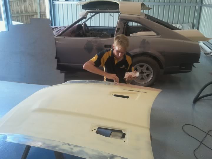

I don't know how to shrink metal yet so I'm just using fillers to fix the dents on the bonnet
Put some primer on it so I can start working on it bit by bit
Me working away
Getting there
Still getting there
Almost there, the filler that is on there isn't that thick
Just put the vents in for the hell of it
Gone over it with blade putty to fill the little imperfections

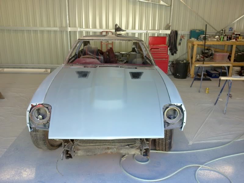

Right the cars ready lets go!

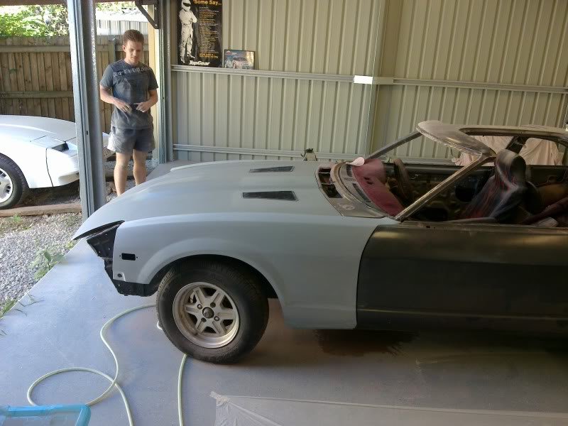

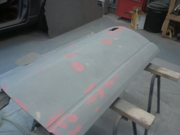

Bonnet ready for paint

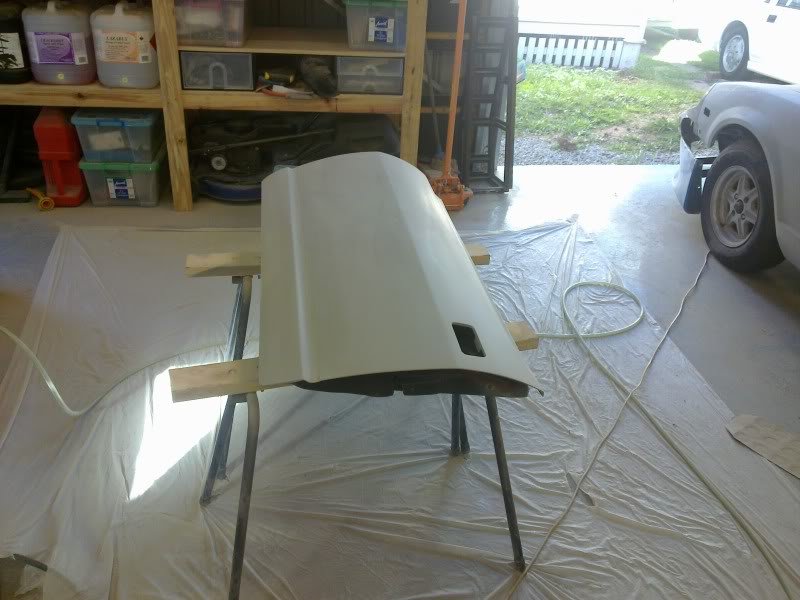

Almost finished, these didn't take much work
Now their ready
Just sitting them on the car to have a look

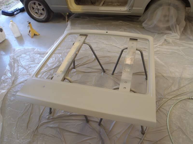

Next we pull it all apart again, doors off this time
Doors undergo my usual treatment
Now their ready

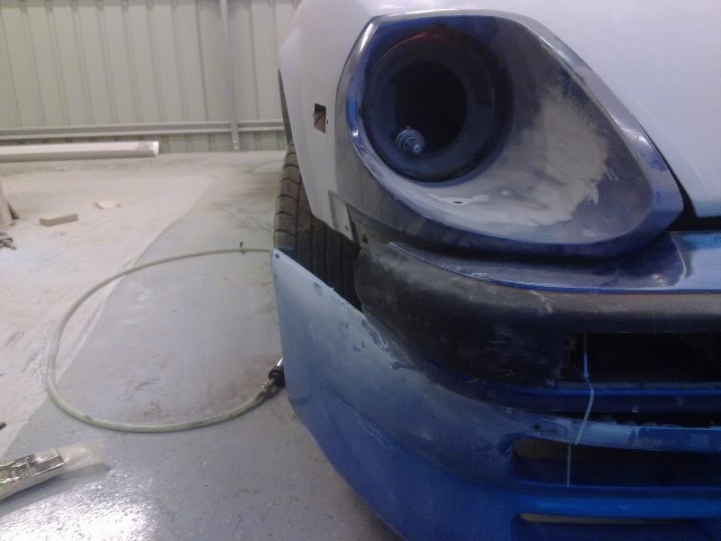

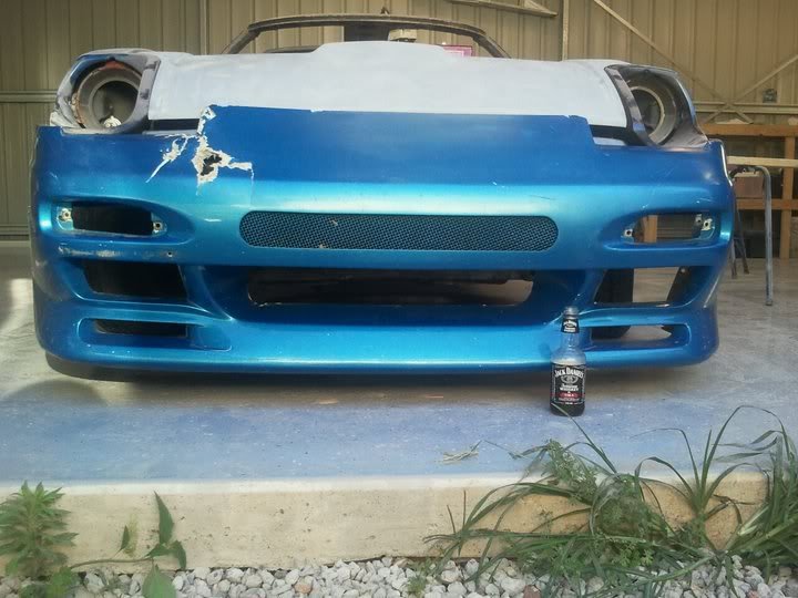

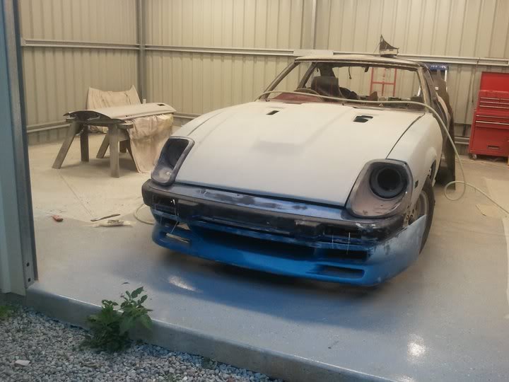

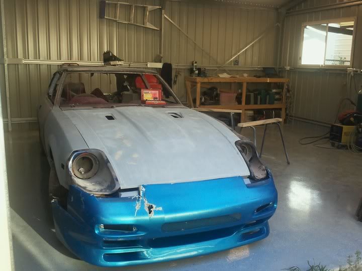

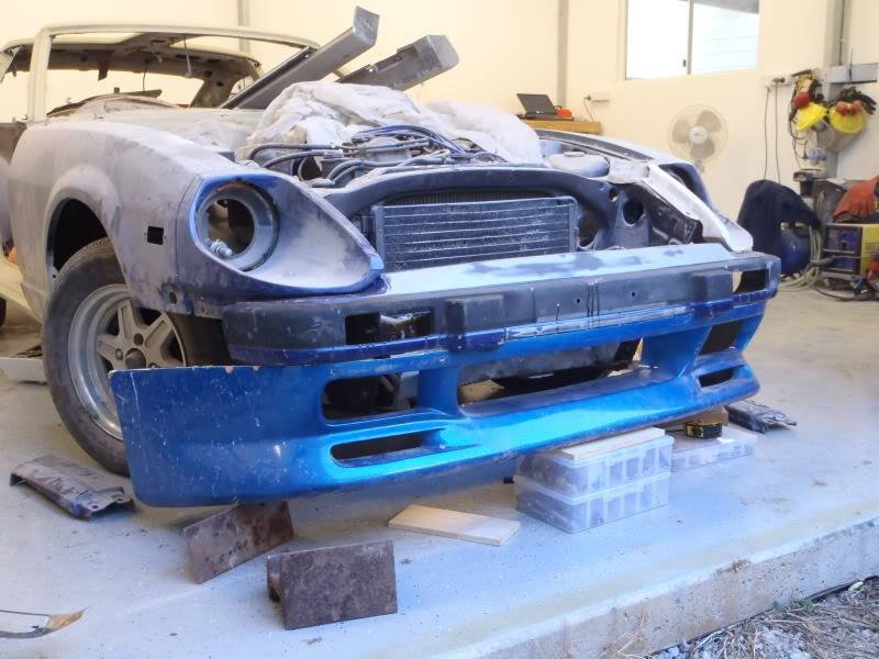

Now we thought of doing something a bit different, well not for me anyway. To make it look a bit smarter we decided on fitting a body kit. Well we weren't going to buy one new so we've started adapting one.

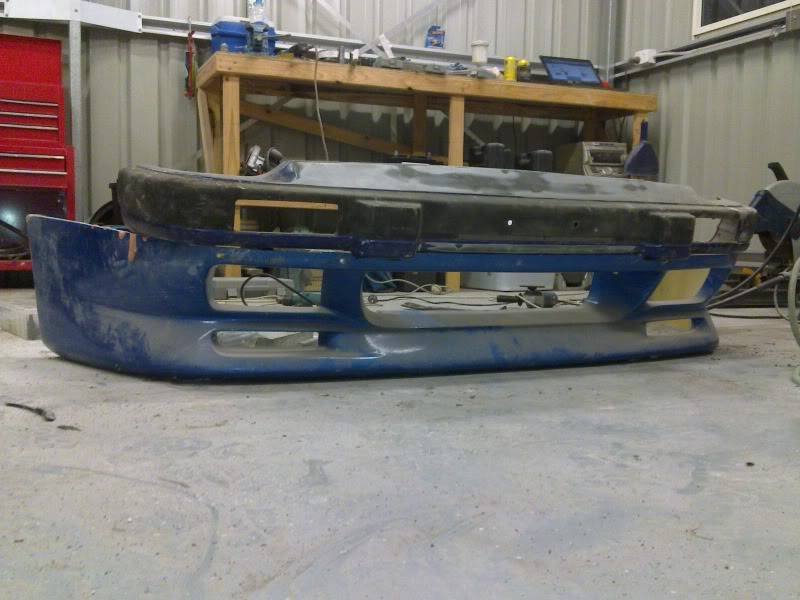

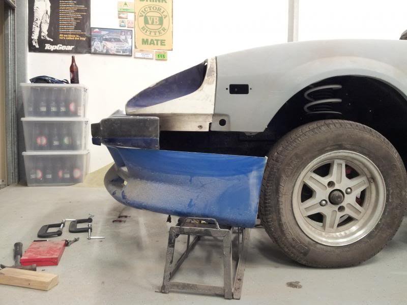

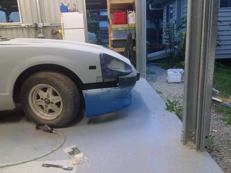

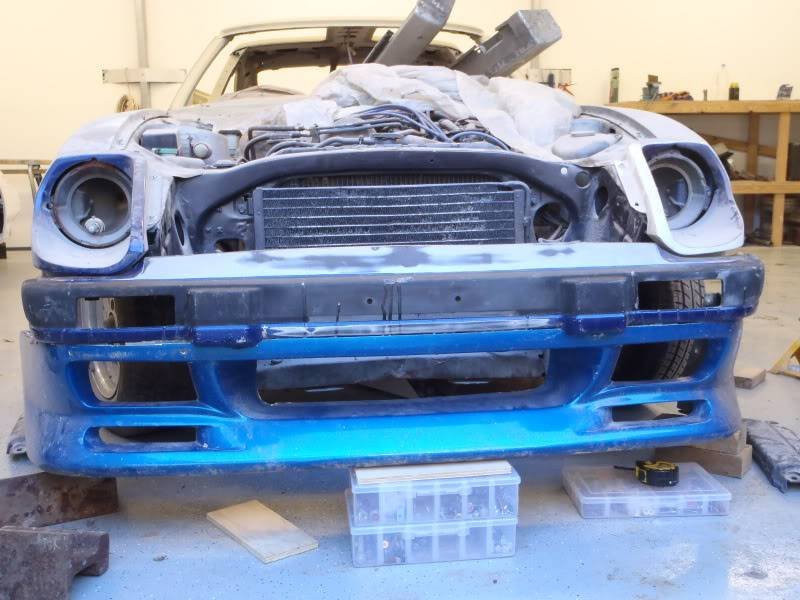

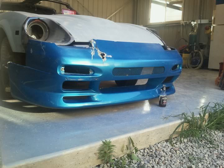

Mike found a front spoiler on ebay off a 180sx, damaged for $70. I'll let the pics show you
Hmmm close but needs some work

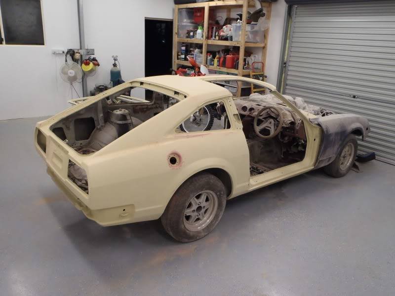

And how the car looks at the moment
It still needs some work but it's getting there

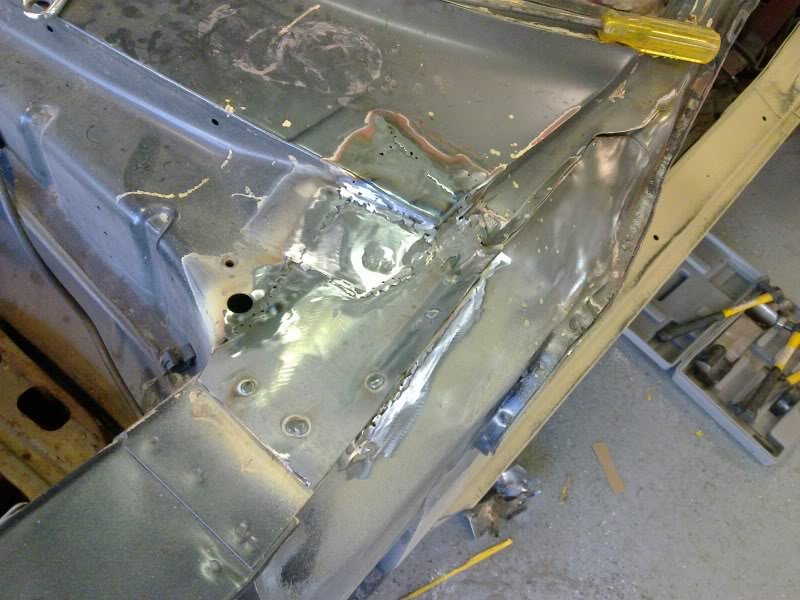

I've been working on this side, it had more rust on this side then the other.
Every where there is filler the metal was cut out and replaced
Now it's primed, still needs a bit of work and for the primer filler to be applied

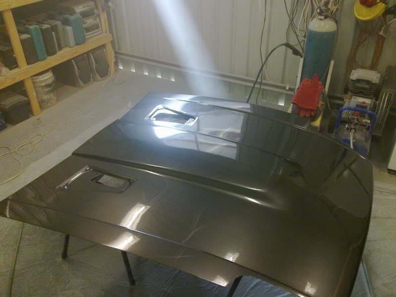

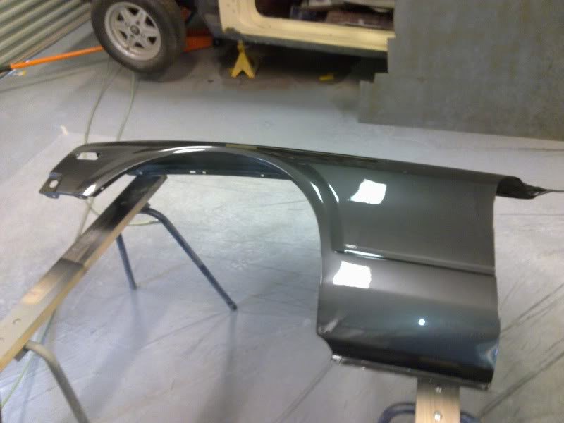

We have also got the doors, front guards and bonnet painted. I have some pics somewhere I'll have to find them and put them up as well.

This was about the worst of the rust on the front end, it was the same on both sides
All fixed

And a couple of the painted panels, not too shabby for my first time using 2pac and the color contains a pearl in it as well. I still want to wet sand, spray another 2 coats of clear, wet sand with much finer paper and then cut and polish. My aim is to have it as smooth as glass. I know it's going to be very tedious and time consuming but that's just me being a stubborn bastard.

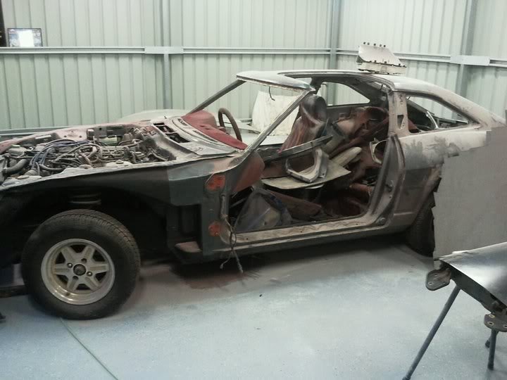

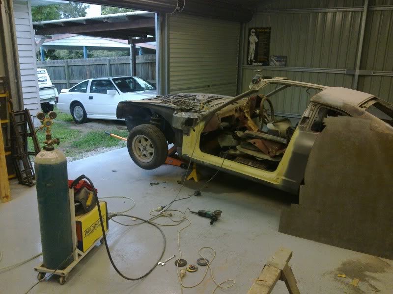

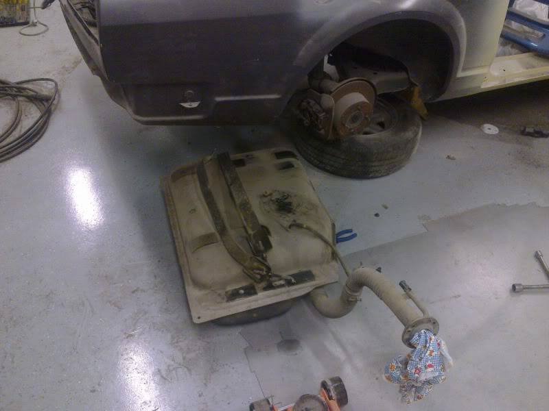

First things first, I finally dropped the fuel tank. The f***ing bolts on the straps were seized, had to get the heat gun onto them to help loosen them up a bit but it's out now.
Already been cut out and fitted with new metal

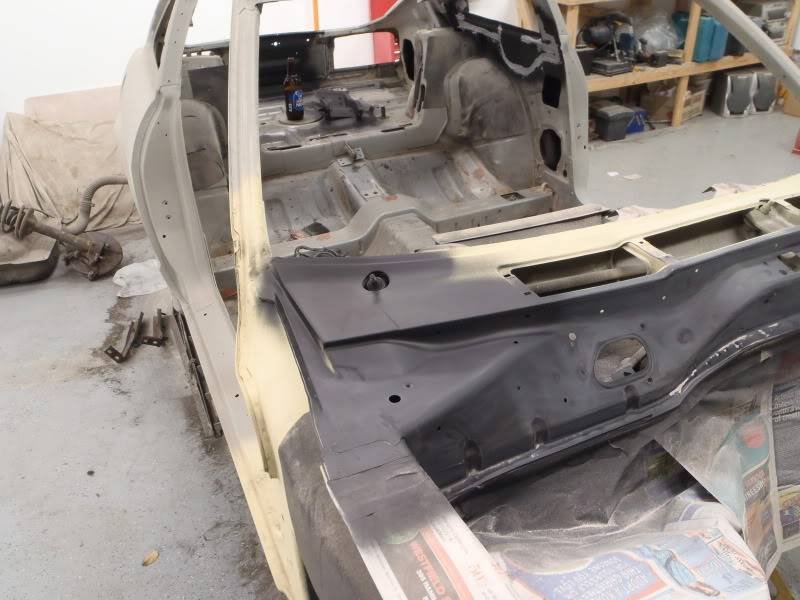

Started stripping some more of the body
Yep thats me, covered in dust, notice the haze? Thats dust in the air from stripping the old paint and body filler.

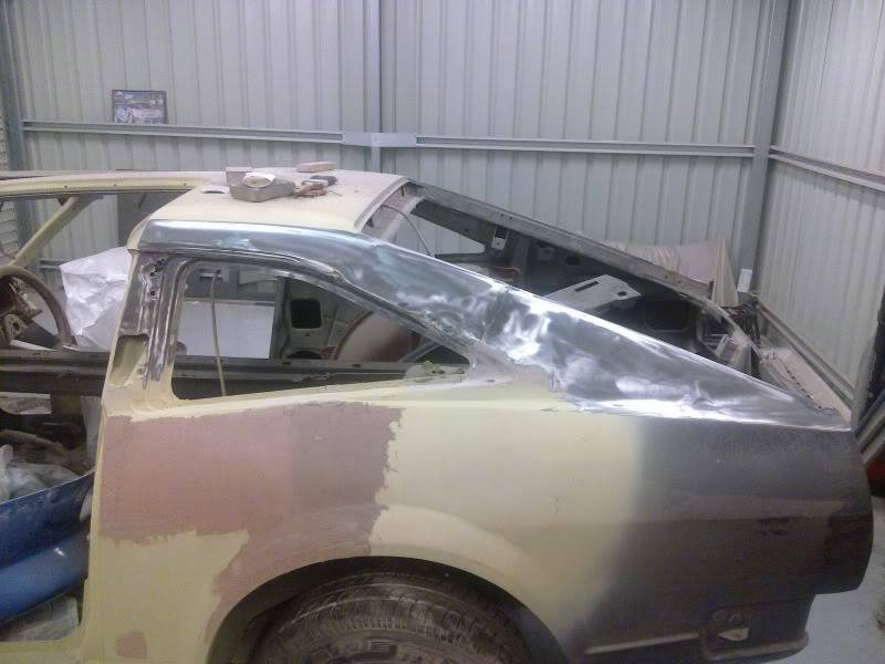

This is how the rear quater looks at the moment, still have a lot of sanding to go to take a lot of the filler down. And I haven't really started on the lower section yet either.

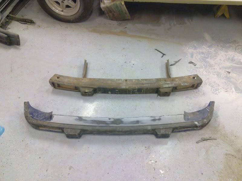

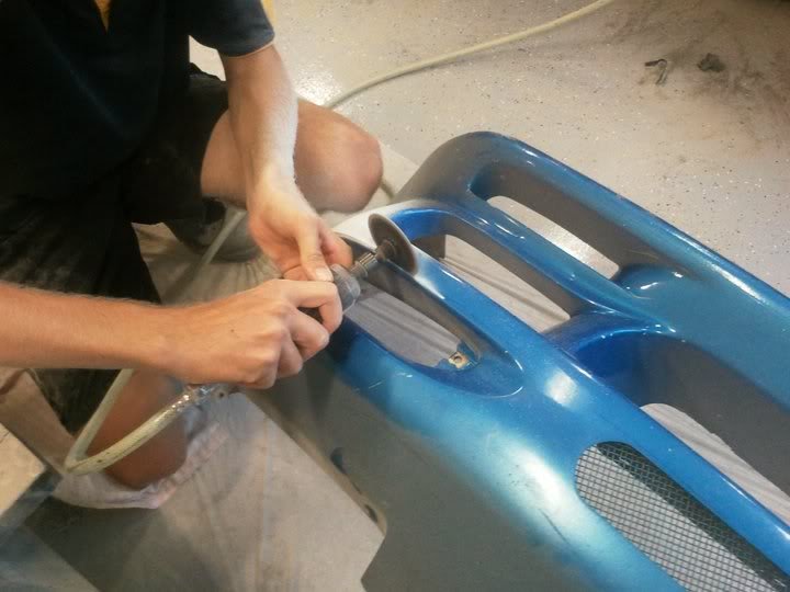

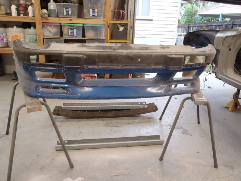

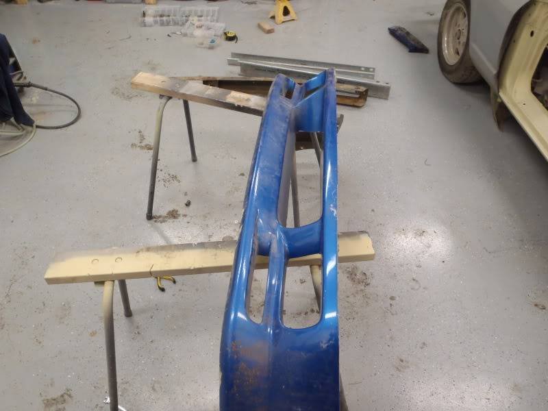

Pulled apart the front bumper to start mocking up the one I'm going to make.
Starting to line them up, cut, shame and attach. This is going to take a while

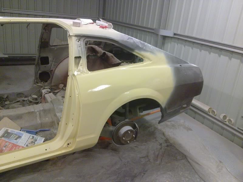

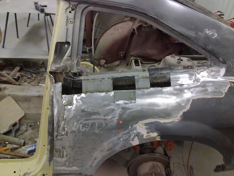

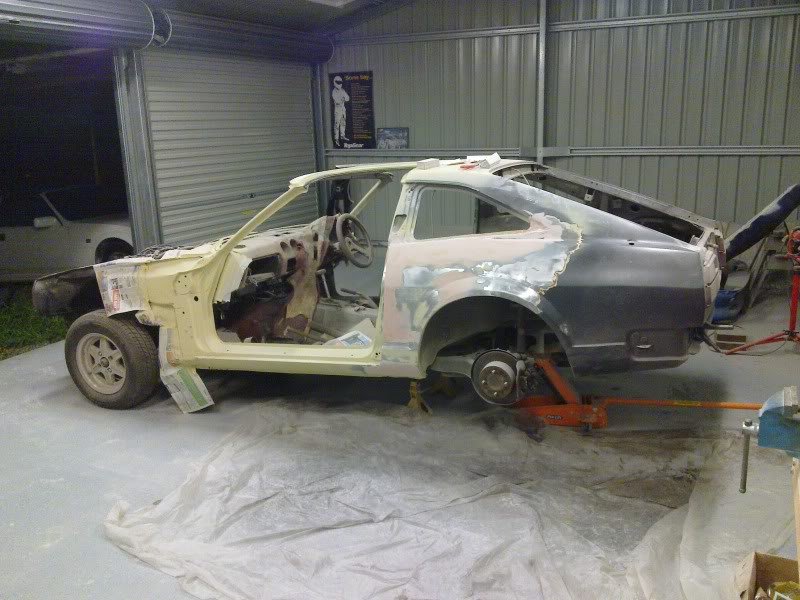

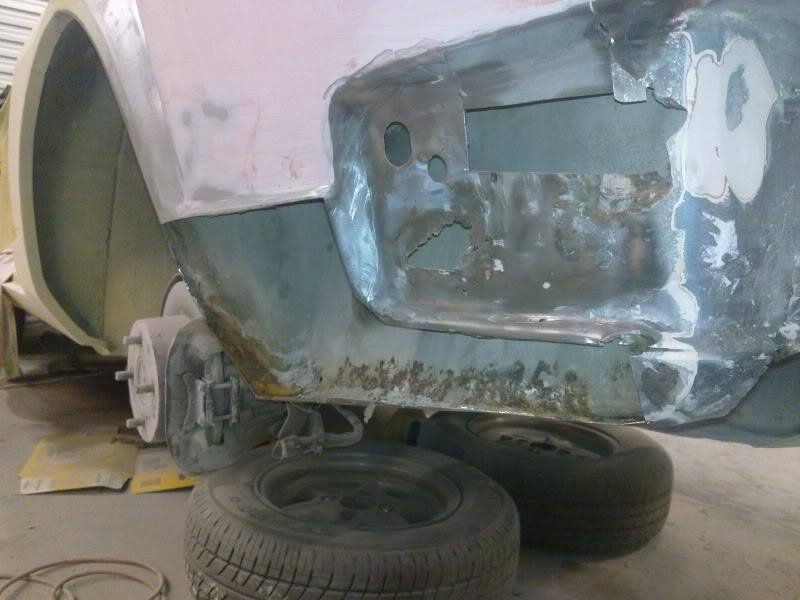

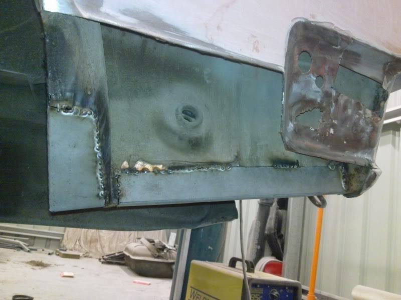

Been doing some more work, it's getting there slowly.

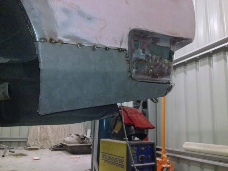

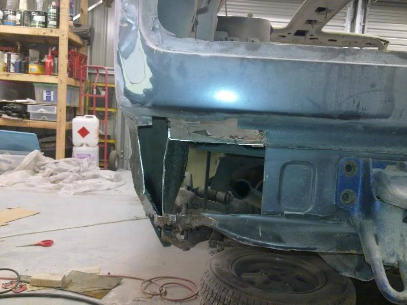

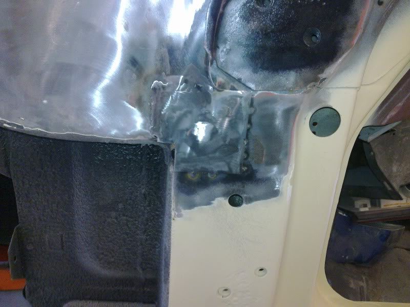

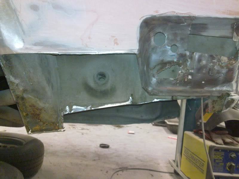

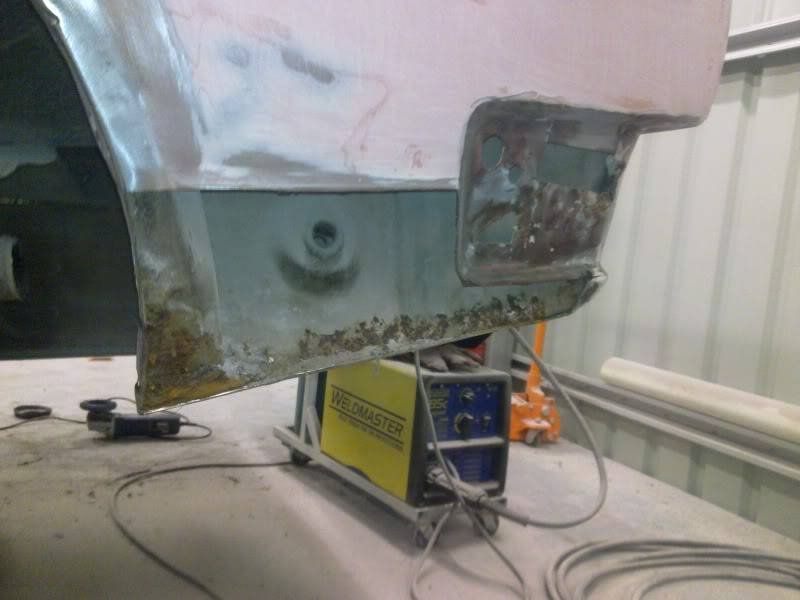

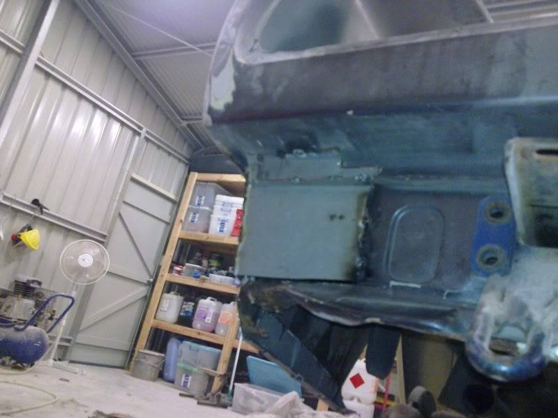

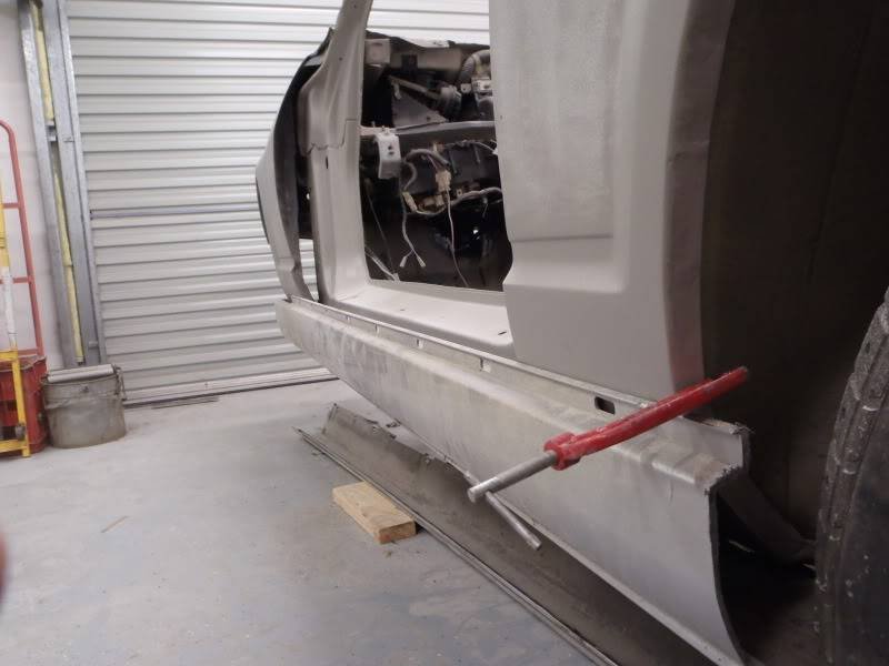

The whole lower section of the quater had rust, not much but still, so I cut it out
New steel welded in
And a new outer skin that I fabbed up and welded on, it took a little while to make

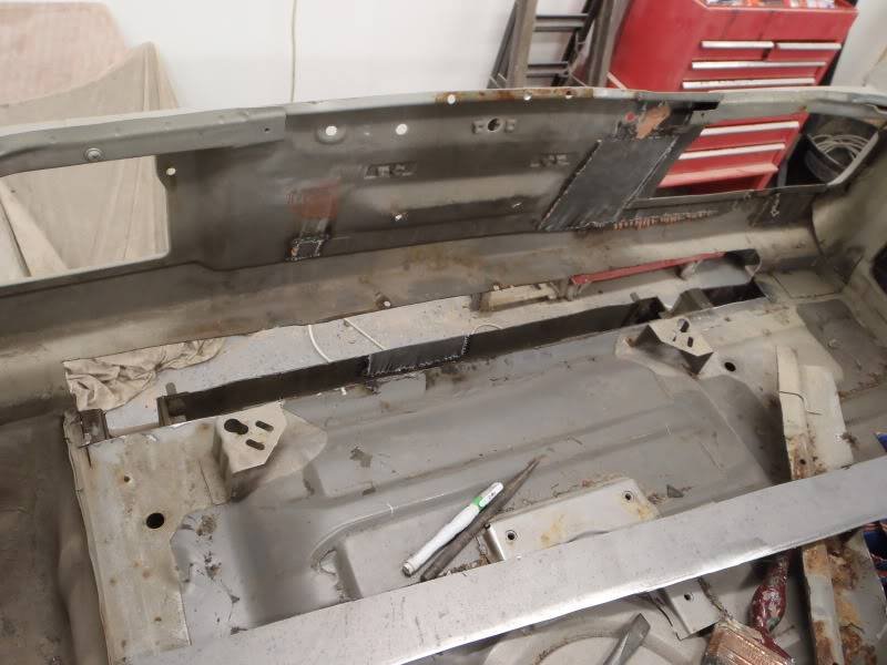

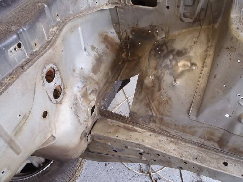

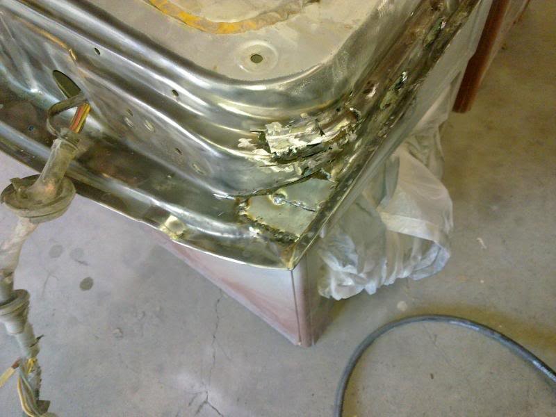

More rust.

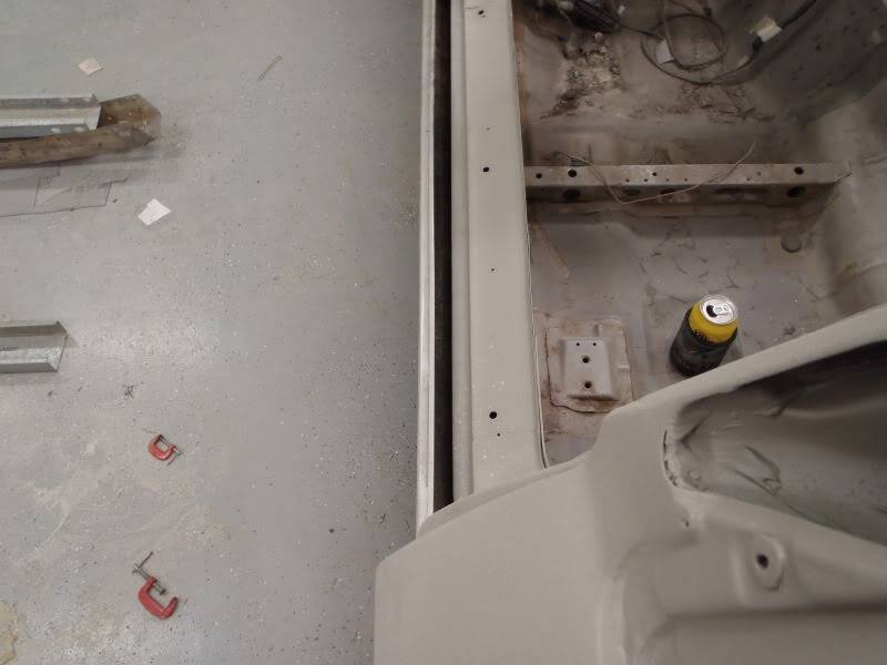

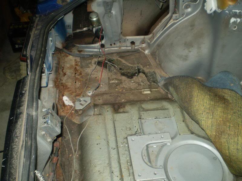

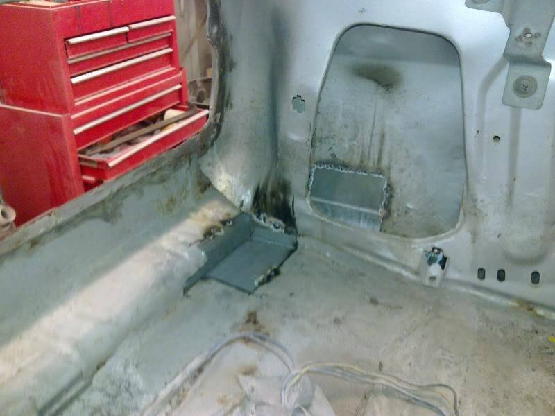

And there was a bit of the floor that was rusted in the corner
Most of it fixed now

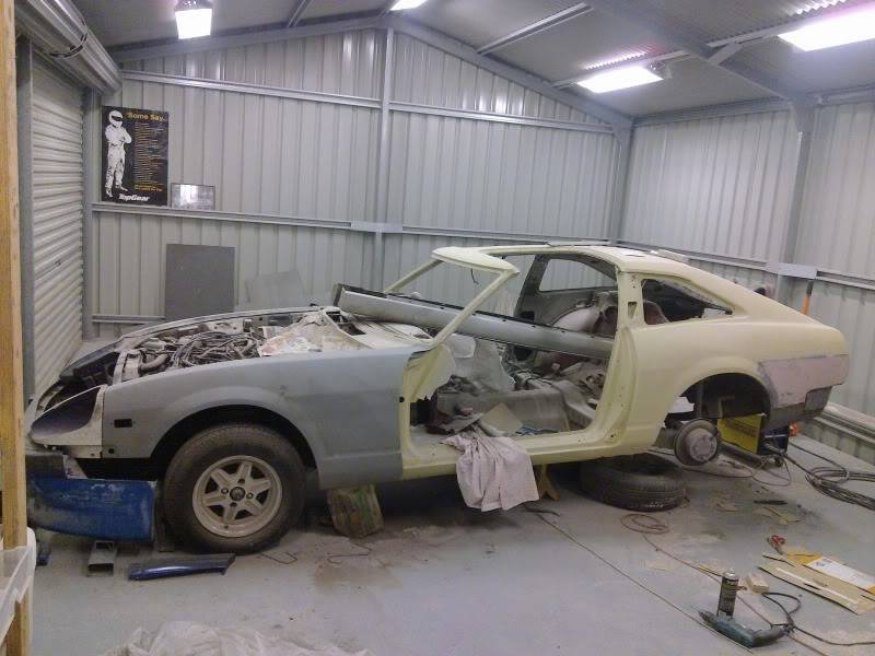

And what the car looks like at the moment, I've got the spare guards on the front for lining up the bumper(more on that later)

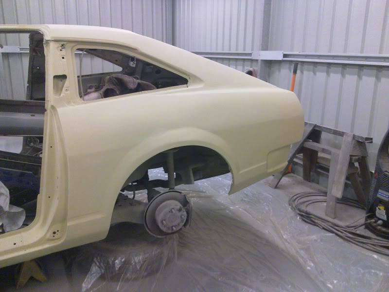

And now the rear quaters are primed
There is still a lot to go before we think about applying colour but it's geting there slowly

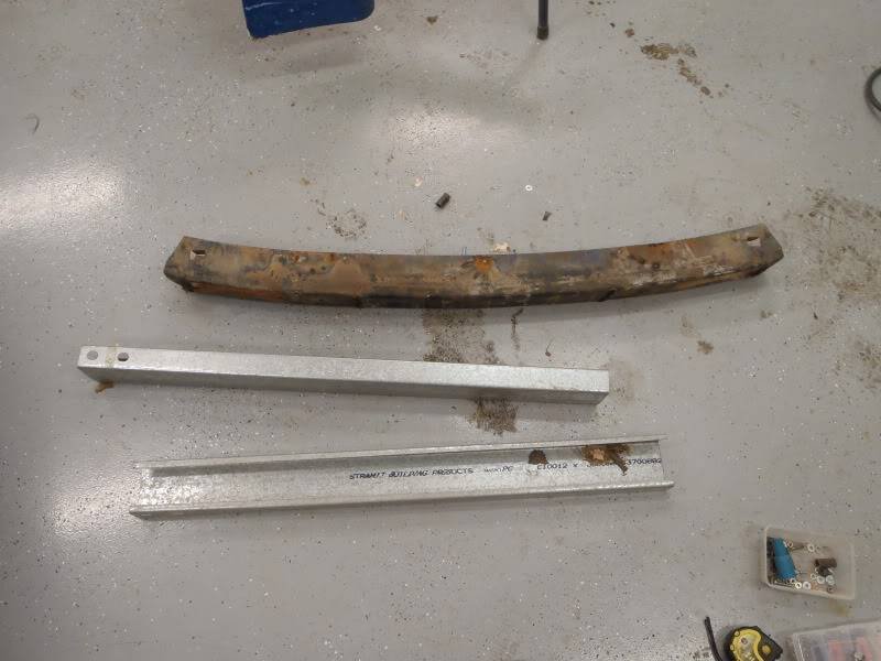

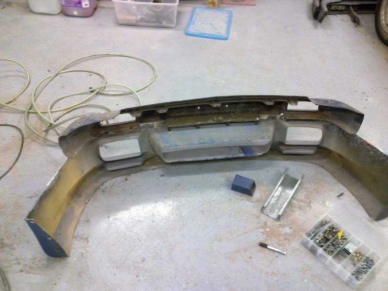

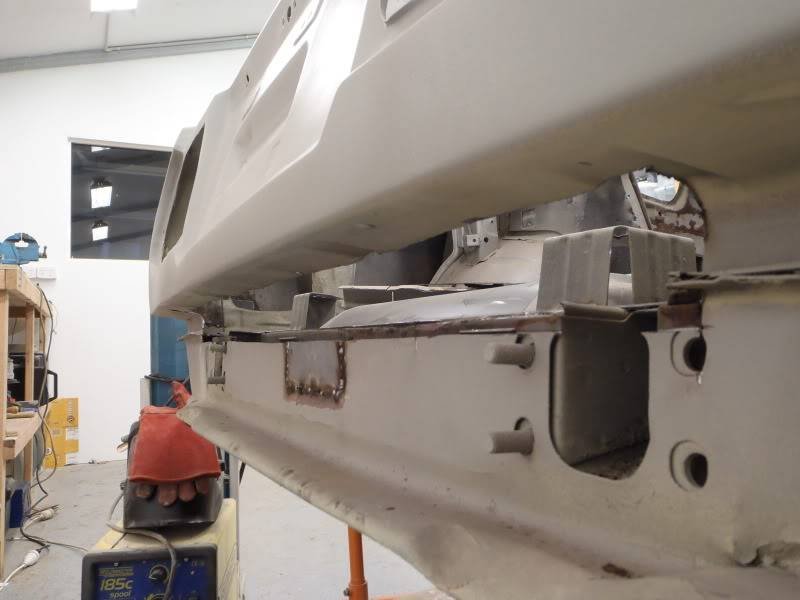

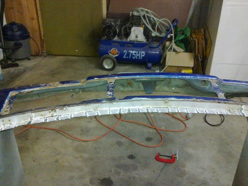

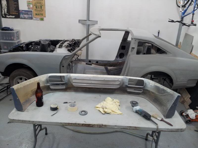

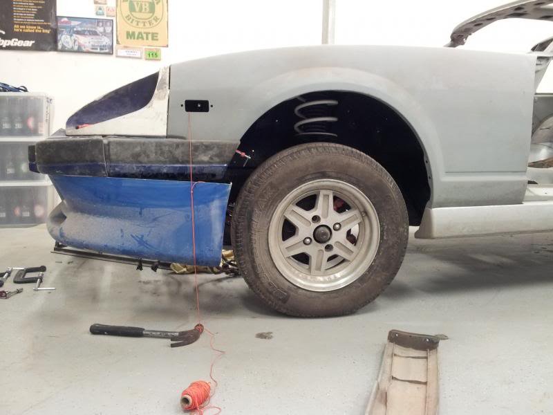

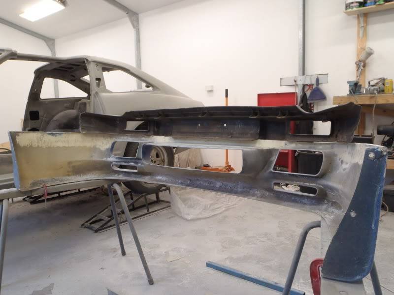

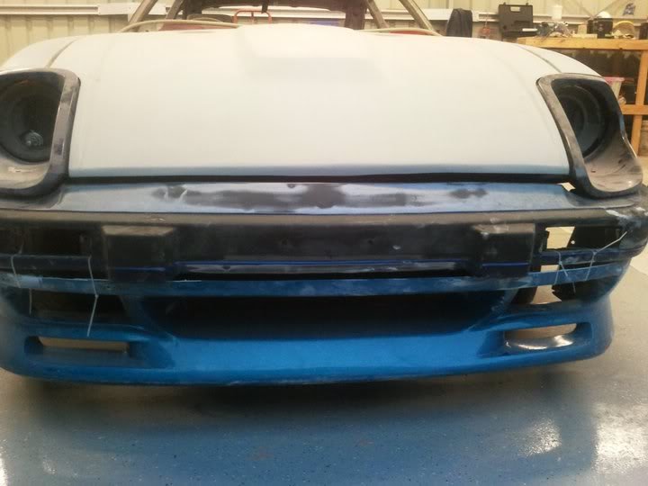

Any way, I've been messing around with lining up the front bumper and it's going to be more time consuming then first thought. All of the origional bumper suports we have are too rusty to use so I'm going to have to make up a new one.
Lining it up with one of the origional bumper supports that I was trying to repair, I had to line it up so I know where to weld the brackets on.
As you can see getting it right involves grabing what ever is lying around to prop it up at the right height and angle.
It was at this point I cracked the shits with it and decided I'll make up a new support from scratch.
Starting over, I seperated the two halfs of the bumper so it's a bit easier to handle
And some 100x50 C chanel that I had lying around that I'll use to make my support. I need to get some more cutting discs for both the grinder and drop saw before I can do any more.

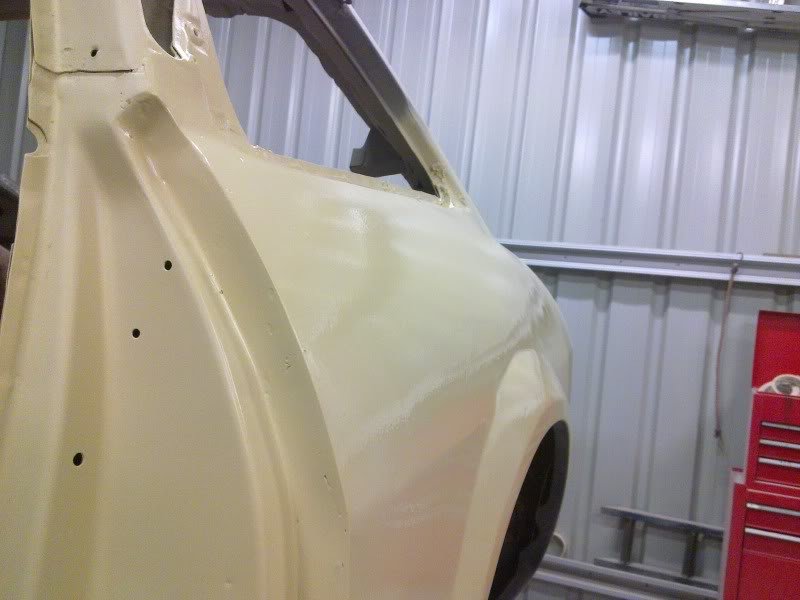

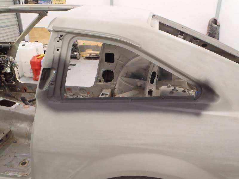

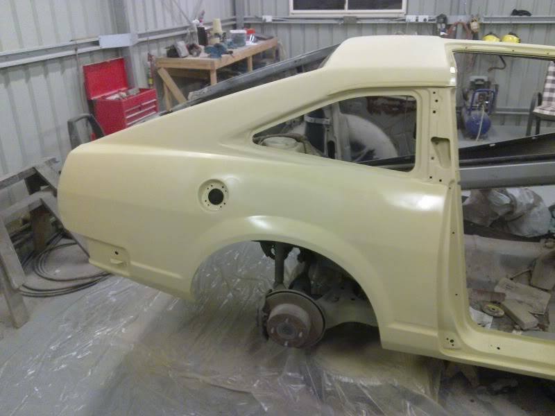

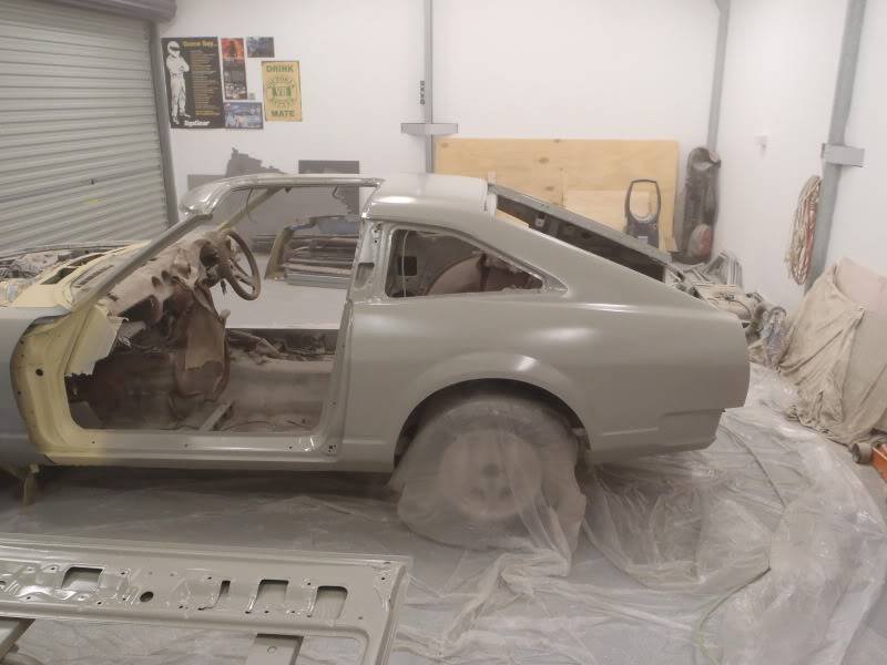

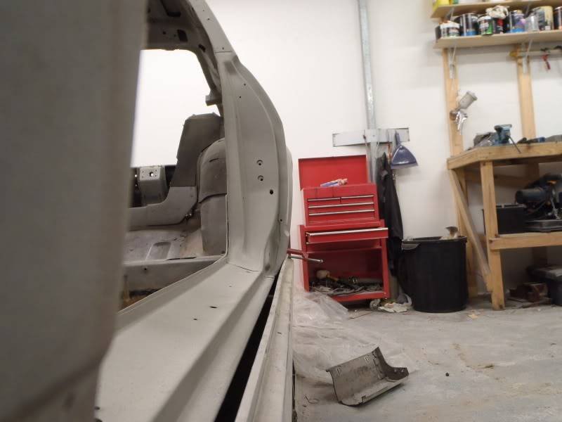

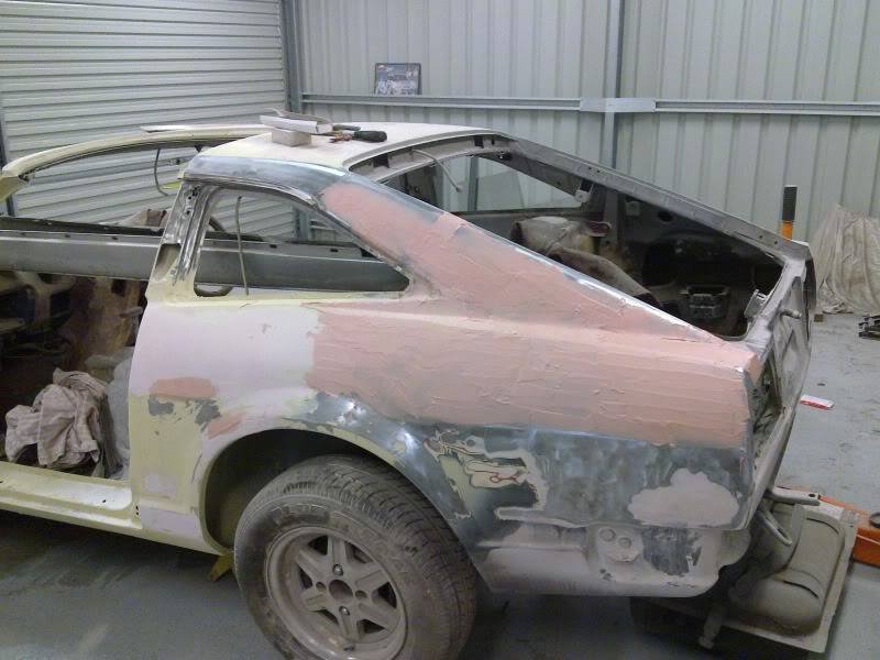

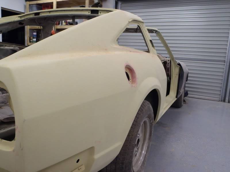

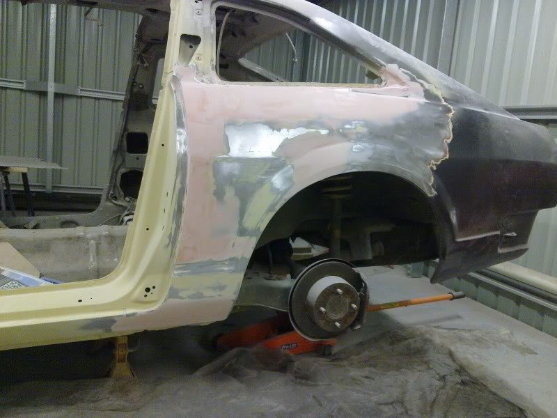

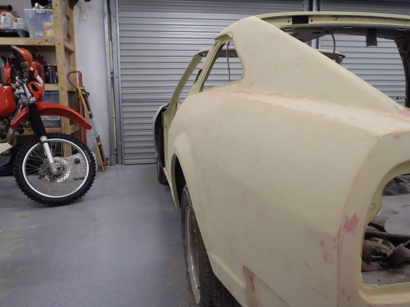

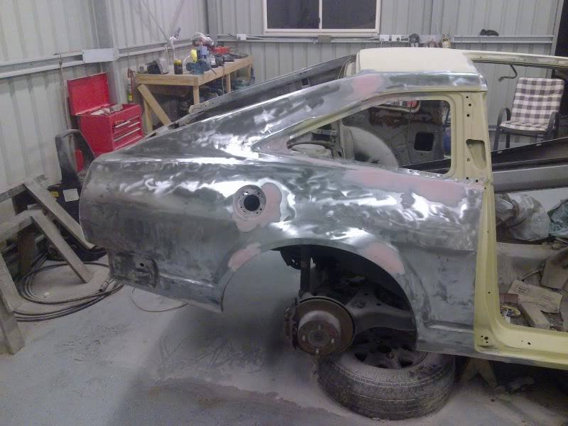

Now onto the body, Ive just been working on the rear quaters to try and get them as smooth as I can, it's a bit time consuming.
And now with that done I have applied some primer filler that'll needed to be sanded down and to help check how straight it all is.
And thats about it at the moment, now it's time for a lot of sanding.

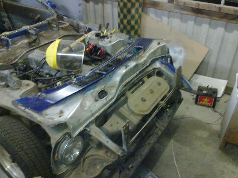

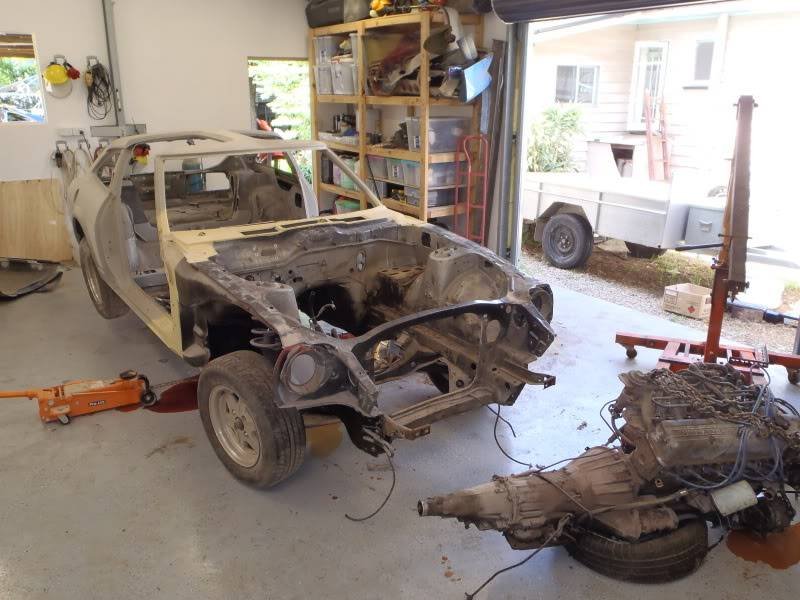

And also got the old motor out today
I already had most of the engine ready to be pulled just had a couple of things left to undo.

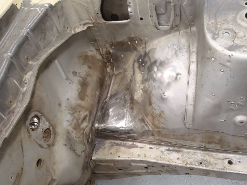

I thought I had some 'before and during' pics but I must have deleted them by accident but you get the point.

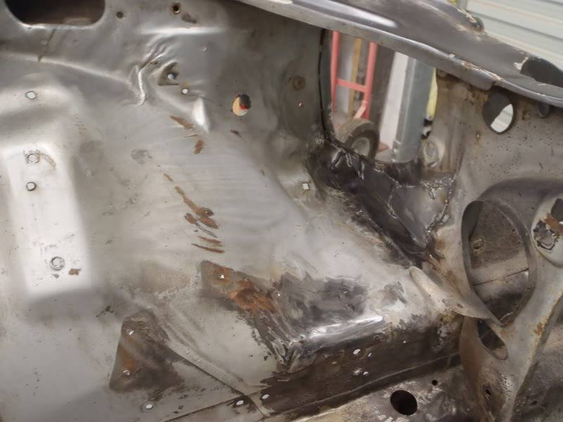

A bit of rust that was cut out

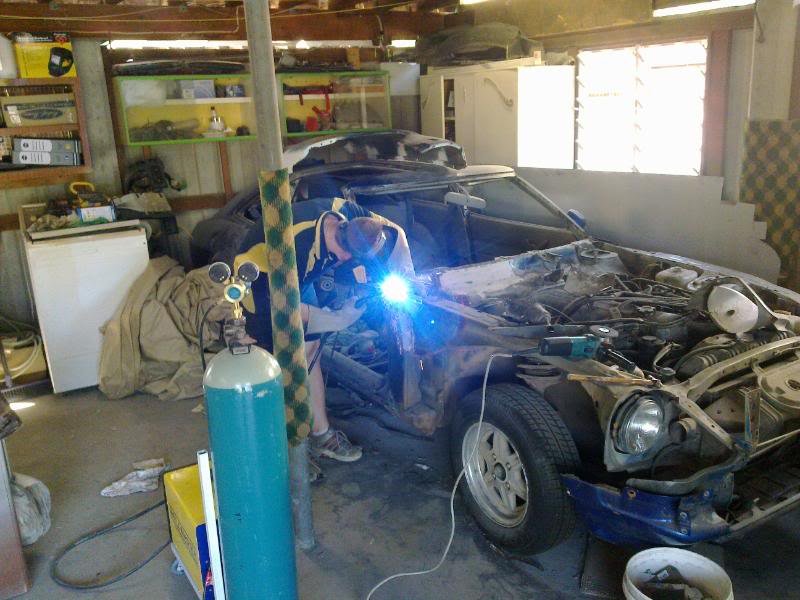

Me welding
Welding finished and welds smoothed out

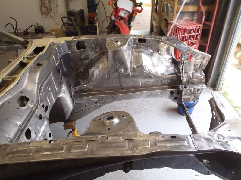

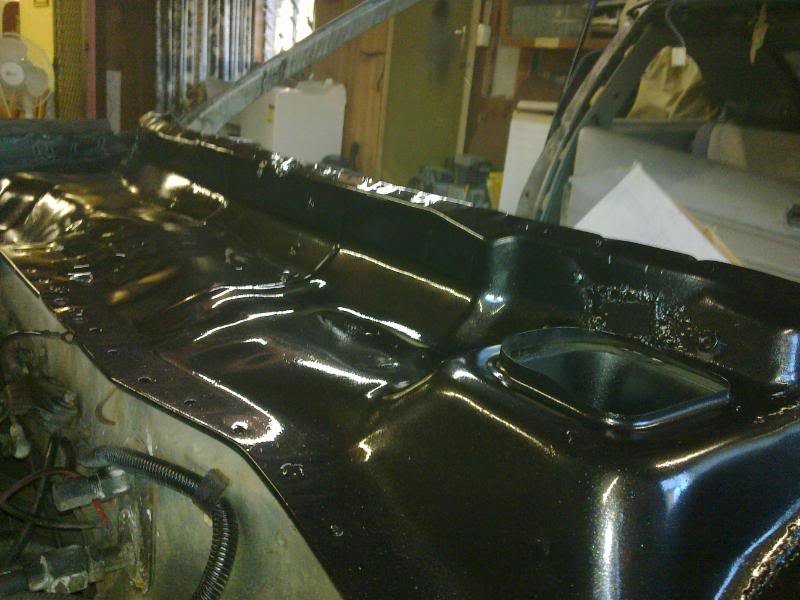

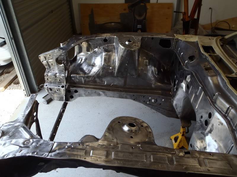

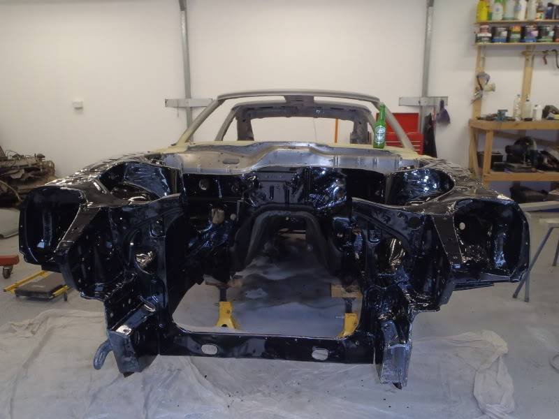

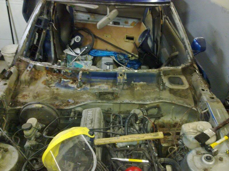

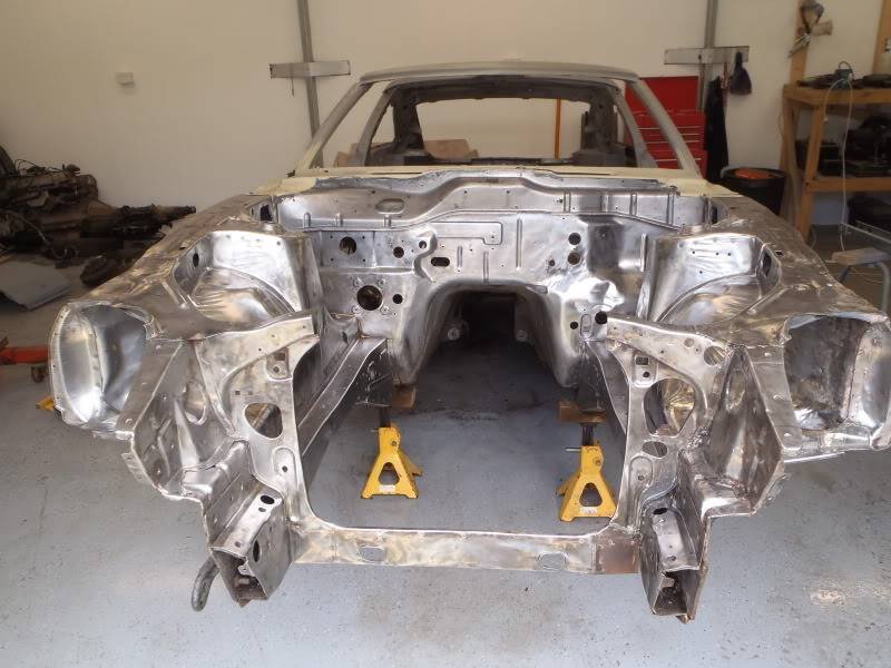

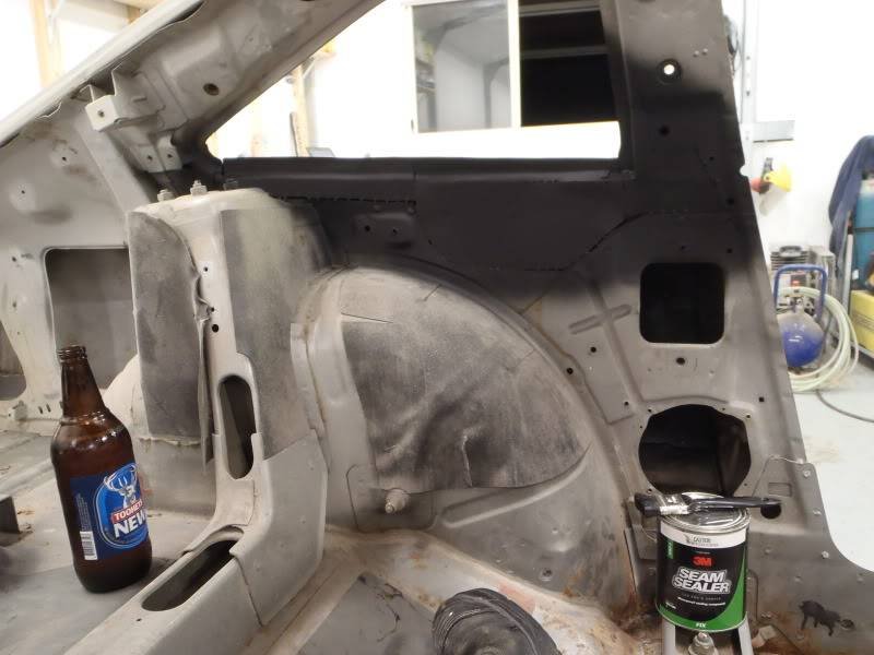

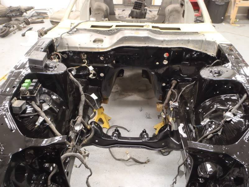

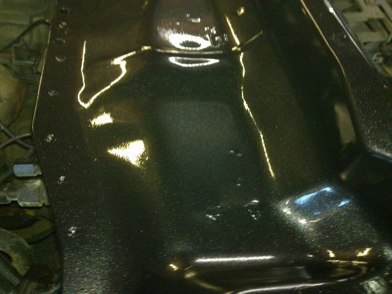

Then we stripped all the paint from the engine bay
Painted the bay

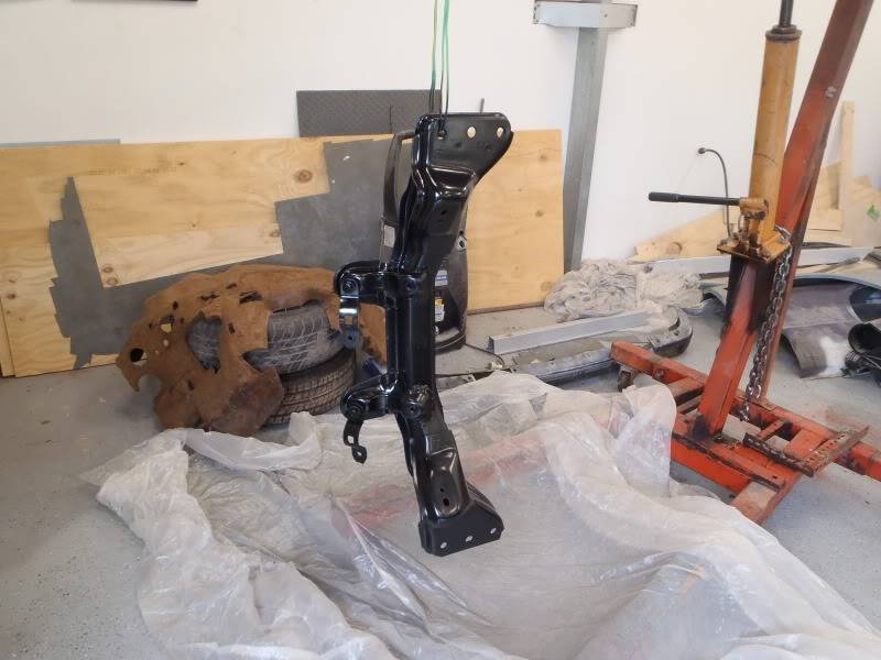

Striped and painted the engine crossmember

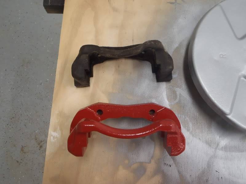

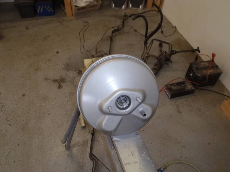

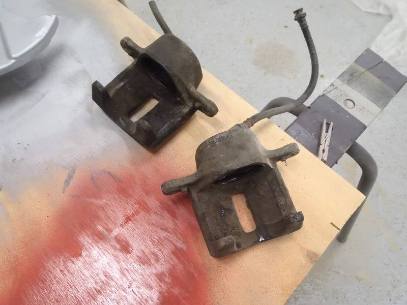

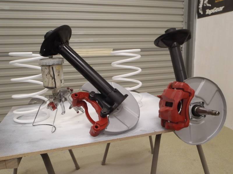

And the brake booster
My fastener supplier is a 15min drive away and I couldn't be bothered going there for four nuts so I ended up cleaning these ones up, all the parts/hardware stores around here didn't have these exact nuts and since it holds in the crossmember I wasn't going to use a weaker nut. (I want to use all new hardware where i can in the engine bay)
And this is where I left it tonight, I started feeding all the wiring back through and mounting some of the components in the bay

Been a little while, had to go looking for my thread. Anyway, I have been a bit busy lately. Been doing a fair bit more riding over the past few months and that means more work on the bikes, trailer, cars and the list goes on. Might try and get some more work done on this now as I'm itching to start working on my car again but I don't want or have the room to work on two cars. Onto the pictures, that's what your here for isn't it?

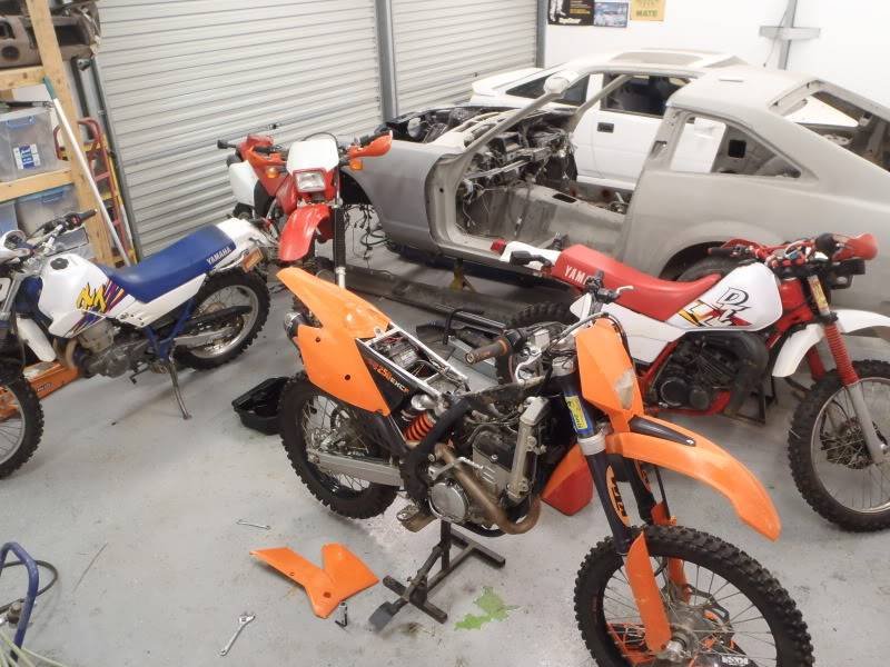

What my garage has been looking like lately
Finished off the inside of the rear hatch, the bracket is welded back on and primed
Also finished this section and it's all primed
Done a few touch ups around the body, just about finished them all
Haven't done too much work with this at the moment but I cleaned it all up so it's ready to go

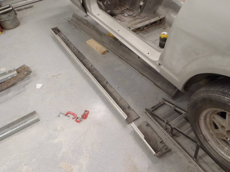

I have done a bit of work on the side skirts, well just one at the moment, first one takes the longest time.
Just cut down to a 'rough' legnth
Eyeing up what needs to be done
And this is one skirt trimmed to fit, just need to do the same to the other one then finish them off.
  • 1 month later...
Been a little while, I've done a bit of work and I am hoping to get more done ASAP.

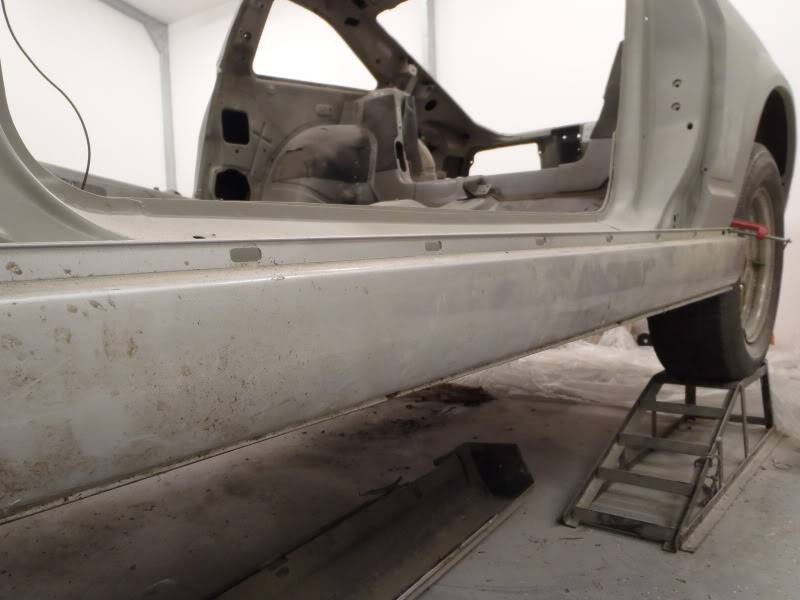

Well I'll start with the side skirts, their 'done', just need to be sanded all over (I'll get Michael to do that) then paint and mount them to the car

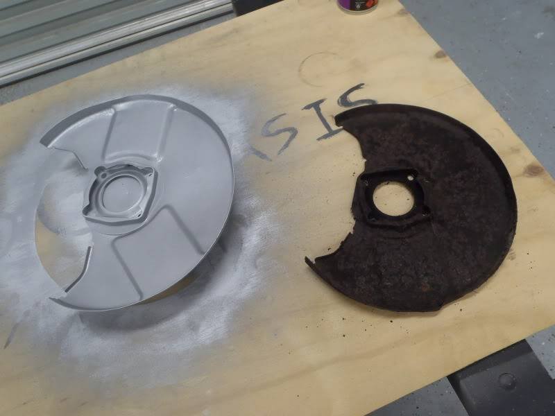

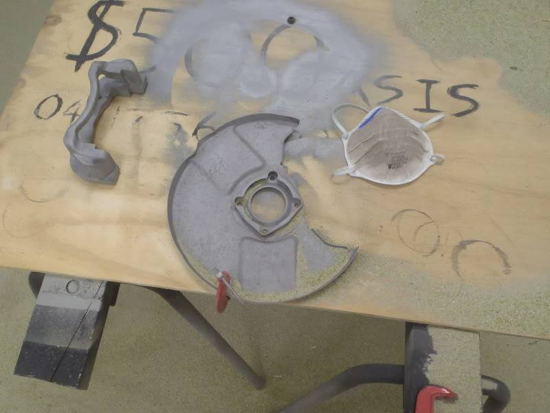

And we got a media blaster off ebay, one of the '10 gallon' units. It's f**king awesome. We can get crushed glass for very cheap from one of Michael's friends so I've been having a 'play' around with that (crushed glass doesn't have the 'free silica' that sand does) and the results so far have been awesome.
This was a quick test, about 10 seconds. Compared to the other one...

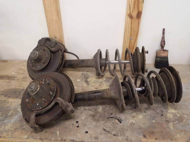

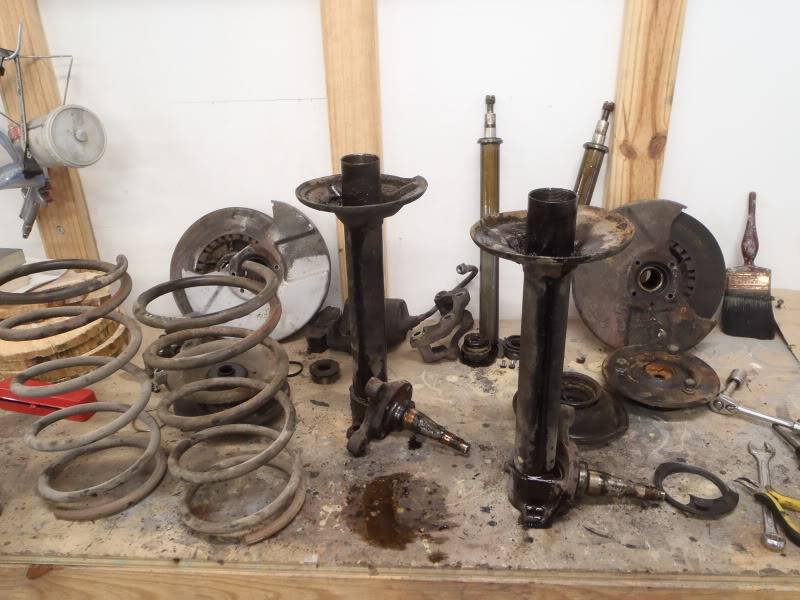

So anyway today I started to disassemble both the front struts
And I ended up with a bench looking like this. The front shocks look like the originals and are shot.
After a few minutes with the media blaster, both sides are done.
One cover painted, there is some pitting on the cover from rust but that doesn't matter.

Finished cleaning up the front suspension

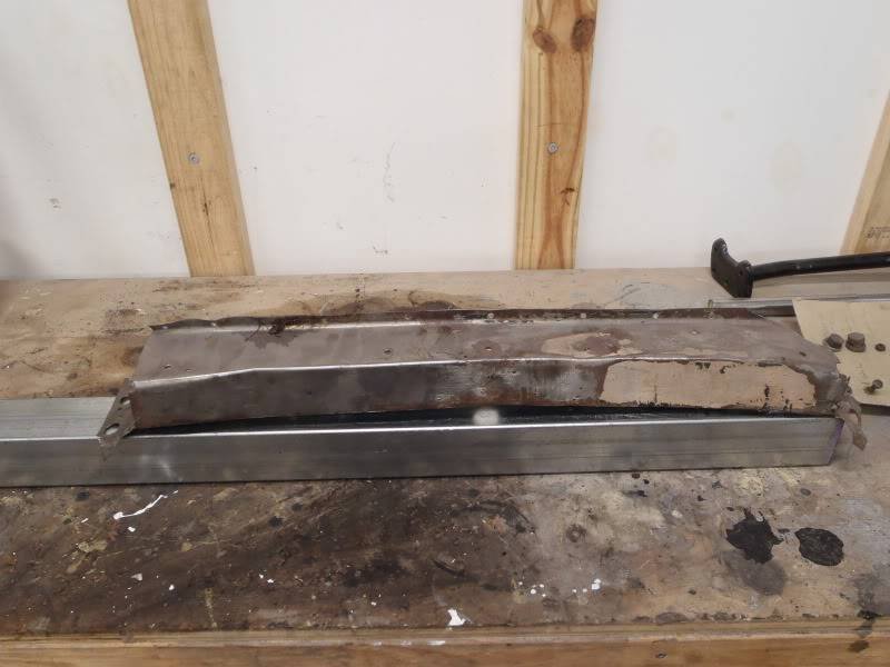

Started working on the front tension rod mount
Yea it was a bit stuffed
Sitting on the steel I'm making the new one from
And now it's ready to be welded in

Long time over due but I have been doing a little bit of work on the car here and there.
Media blasted and painted the inside of the car, I found one small rust hole so that got cut out and new steel welded in. This is the inside just in primer. I have put a top coat down just haven't taken any pic yet
Other things that have been done include removing the whole rear end to be inspected, cleaned, repair where necessary then reinstalled.

So I've started working on the car again after a long break. I've had a lot going on and things have finally settled back down now so I'm hoping I can continue working on the car more.
Anyway, I'll get stuck straight into the pictures as thats why your here really isn't it.
So to start with I've been working on the front end. I lined up the front spoiler with the side skirts and found I needed to take another 3cm off the top of the spoiler so it wouldn't hang lower then the bottom of the skirts.
So now the front's inline I need to clean up the cut a bit
Just with more of the front end mocked up so I can take some more measurements
And marking out how much of the rear has to be cut off
Looking better
