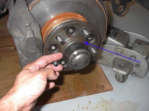

nizm0zed Posted March 20, 2012 Posted March 20, 2012 Pulling up an old thread... (yea, im totally badass!) So, lets agree that the centrebore of the front hubs is 73mm, because im at work and cant go home to measure it. Would it be safe to machine it down to 66.1mm Ignore its not a zed part, its a random pic i found, but the area that the arrow is pointing at, Can that be machined safely down to 66.1mm? It'll only end up being 3.45mm machined inwards from its origional shape. I am planning on using some hubcentric bolt on spacers that have a 66.1mm internal diameter. Quote
luvemfast Posted March 20, 2012 Posted March 20, 2012 Without actually looking at an S30 hub........ I'm going to have to say no. You would be better off boring the inside diameter of the spacer, larger. Rather than machining the outside diameter of the hub, smaller. My 2cents Quote
nizm0zed Posted March 20, 2012 Posted March 20, 2012 that was my first thought too. looks like im going to have to bust out the measuring stick when i get home. I think that the location of the small amount i want to machine is right in the meat of where the bearing cup is presed in??? However, the 2 main reasons im looking at machining the hub are (and feel free to say they are stupid) 1. The spacer is a PITA to mount in the lathe. It will also render it worth nothing when it comes to resale at a later date. 2. the hub is a LOT EASIER to mount in a lathe. It will also enable ALL 66.1mm (4x114.3) centrebore wheels to fit straight on, instead of on the rear and not the front. Most if not all modern nissan wheels are a 66.1mm centrebore. (yes, i realise the offsets are completely useless to us...) Quote

nizm0zed Posted March 20, 2012 Posted March 20, 2012 because i allready have the spacers, they are nissan 4 to 5 stud spacers. Besides, most hubcentric spacers only come in a very limited number of sizes, custom made is very expensive. anyways, i had a look at a dissasembled hub, there is enough wall thickness to accomodate it, and its only skimming a couple of mm off in an angled chamfer cut. i probably should have just waited till i got home from work and looked, but i was being impatient. /thread nothing to see here, move along... Quote
luvemfast Posted March 20, 2012 Posted March 20, 2012 I'm quite suprised that there is a safe amount of material to remove from the hub. But good to keep in mind. Quote
nizm0zed Posted March 20, 2012 Posted March 20, 2012 once the measurements are made, its only a very small edge that is removed. however, i can also see how an engineer may say its a bit of a questionable practice. For anyone else doing it, consult with your engineer. Quote
