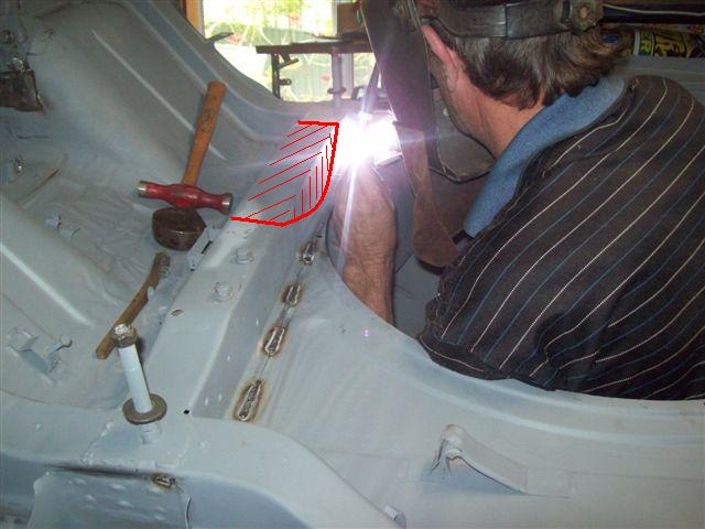

PeterAllen Posted December 11, 2011 Author Posted December 11, 2011 Ian - I think they are 3.69 but I'll try and check and get back to you. I picked it up off eBay right at the start of the project because some guy was fitting one in the USA (HybridZ). That's 5-6 years ago now but I don't know that anyone else followed. I've never run it so I can't tell its condition but there doesn't appear to be too much backlash. I've tried to illustrate on a photo what is involved in the cross-member modification and you can see it's pretty drastic. On top of that they are bloody heavy. I think the reality is they simply don't fit an S30. You're welcome to drop in and have a look but I'll put it on eBay in a week or so if no one wants it. I see a wrecker in SA is asking $369 for one - tell him he's dreamin'! I'm still spending Tuesday nights at TAFE - it's a lot cheaper now. Quote

handsandwhich Posted December 12, 2011 Posted December 12, 2011 Ian - I think they are 3.69 but I'll try and check and get back to you. I picked it up off eBay right at the start of the project because some guy was fitting one in the USA (HybridZ). That's 5-6 years ago now but I don't know that anyone else followed. I've never run it so I can't tell its condition but there doesn't appear to be too much backlash. I've tried to illustrate on a photo what is involved in the cross-member modification and you can see it's pretty drastic. On top of that they are bloody heavy. I think the reality is they simply don't fit an S30. You're welcome to drop in and have a look but I'll put it on eBay in a week or so if no one wants it. I see a wrecker in SA is asking $369 for one - tell him he's dreamin'! I'm still spending Tuesday nights at TAFE - it's a lot cheaper now. Many people have done the conversion and I've done it as well. It definitely is not an easy bolt in swap. You can see in the pic where the subframe has to be notched out to get the diff to tuck in to the body. $50 is a bargain and I'd snap this up in a heartbeat if you were near me. $200-300 sounds about right. You should try selling on the 300zx auz forums. But as someone said, these are pretty bulletproof so not many go bang! Quote

PeterAllen Posted December 12, 2011 Author Posted December 12, 2011 Many people have done the conversion and I've done it as well. It definitely is not an easy bolt in swap. You can see in the pic where the subframe has to be notched out to get the diff to tuck in to the body... Is it a road registered car, and if so, what were the engineer's comments? That was my concern and why I abandoned its use so early. I'm happy in the long run that I went with the GM diff - availability of spares, CV, etc. Quote
handsandwhich Posted December 12, 2011 Posted December 12, 2011 The engineer has said that he has no problem with it. But I am also running pretty much the whole rear end from the 300zx as well. Brakes, axles, hubs etc. Quote
