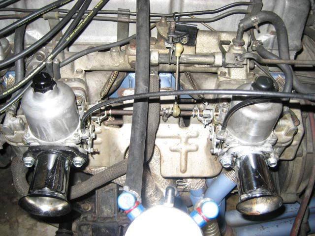

ZD44TT Posted February 28, 2007 Posted February 28, 2007 Howdy all, can anyone tell me if you can tune the air/fuel mixture for round top SU's? Drove to work today, about 38km in peak hr traffic and it ate up 1/4tank.......AHHAHhahah WTF........is that normal? if so where abouts is it on this pic? I need to get it on a dyno and do it I guess. Quote
Administrators gav240z Posted March 1, 2007 Administrators Posted March 1, 2007 The fuel mixture nut is at the bottom of the carb. If you look underneath you will see a spring loaded nut that can turn up and down. I think from memory down is richer up is leaner. To tell if you are running rich. Pull the spark plugs if they are black in colour it's running too rich. If it's a really light brown it's too lean. Just right is a nice chocolate brown colour. If the throttle shaft on the SU's is stuffed and needs rebushing you'll never get them (the SU's) to sync up correctly. I learnt the hard way. There are several books out there on tuning SU's look on Amazon.com if you are interested. The SU's you have on your Z appear to be of the British Type. Early 240z Hitachi carbs look slightly different and have an Hitachi symbol on the top of the fuel bowl FWIW. You can also generally tell if your too rich when you jump on the gas and you get a large cloud of continuous black smoke. If your are too lean you will notice it go very flat in the top end. If your car is out of tune it's best to go easy on her until you get it in tune. Your electrical timing could also cause poor fuel consumption. My 240z with an L28 lightened flywheel, mild cam, electronic dizzy & 240z carbs is really quite good on fuel. When I drove up to the 2005 Nationals in Goulburn from Victoria, I drove with Sulio in his then new Ford Falcon Wagon (straight 6 4ltr) he was towing also, but our fuel consumption was fairly close. Albeit the Z did drink a bit more. However not bad for an old Z. Quote

nat0_240_chevZ Posted March 2, 2007 Posted March 2, 2007 Some questions..... 1-which 1/4 of your tank did you notice it use?? up high or low? 2-does the car idle slightly higher when you put your fingers (spread to allow air through but not heaps) infront of the intake rams? 3-do you have much play in the throttle linkage where it enters the carby? 4-generally how well does the car run? 5- how fast is it idling?? and also of course it chews fuel when stuck in traffic, stop start stop start, big sqirt everytime the pedal is pumped. answer a few of those q's and we'll go from there i reckon, also do you have a timing light?? And a dyno session isnt going to net you many extra HPs unless they have/are a specialised carby tuner along with vacuum and mechanical advance experience, most places only plug into your ecu and edit a few parameters re VE curves etc. nato Quote
ZD44TT Posted March 2, 2007 Author Posted March 2, 2007 Some questions.....1-which 1/4 of your tank did you notice it use?? up high or low? 2-does the car idle slightly higher when you put your fingers (spread to allow air through but not heaps) infront of the intake rams? 3-do you have much play in the throttle linkage where it enters the carby? 4-generally how well does the car run? 5- how fast is it idling?? and also of course it chews fuel when stuck in traffic' date=' stop start stop start, big sqirt everytime the pedal is pumped. answer a few of those q's and we'll go from there i reckon, also do you have a timing light?? And a dyno session isnt going to net you many extra HPs unless they have/are a specialised carby tuner along with vacuum and mechanical advance experience, most places only plug into your ecu and edit a few parameters re VE curves etc. nato[/quote'] 1. one notch below half way.....i travel around 80km and it's down to one notch on top of empty.......consumption is more like 1/2tank for a 80km trip. 2. haven't tried this but will do. 3. yes abit of play in linkages. 4. Car runs very well..........revs nice.......off throttle abit of back fire popping all the time........engine never skips a beat........sits in traffic pefectly.......on acceleration it's smooth......... 5. Car idles around 950 - 1050 rpm. idles smooth.......doesnt go up or down.........normally it sits at 1000rpm. I would love to sit it on a dyno and have to lightly tuned. Quote

nat0_240_chevZ Posted March 6, 2007 Posted March 6, 2007 check for leaks, when you fill it right up. leaks in fuel lines. u running an electric fuel pump? with no return line? take off aircleaner and see if you can see fuel spewing out the main jet (with a mierror of course) where the needles goes to. that sort of fuel economy would challenge the bugatti at full noise!! nato Quote

ZD44TT Posted March 9, 2007 Author Posted March 9, 2007 check for leaks' date=' when you fill it right up.leaks in fuel lines. u running an electric fuel pump? with no return line? take off aircleaner and see if you can see fuel spewing out the main jet (with a mierror of course) where the needles goes to. that sort of fuel economy would challenge the bugatti at full noise!! nato[/quote'] no leaks anywhere in the enginebay or tank in the rear. after i've leaned out the carbs the car seems to be pulling nicely all the way to redline now........strange..........makes pretty dam good power now...........after a good hour road tune/testing?..........hehhehe but economy is still pretty bad i think.........halfway gave me about 140km..........we'll see what this tank does.........good mix of hwy and traffic. Quote
