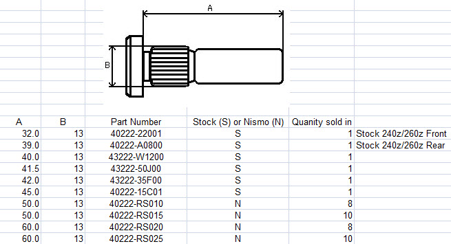

NZeder Posted April 25, 2011 Posted April 25, 2011 Ok here is all the stud info I was talking about above. This will help all those wanting to have/install long studs for whatever reason This info took a little bit of research a few years ago but I have it saved in a spreadsheet Quote
