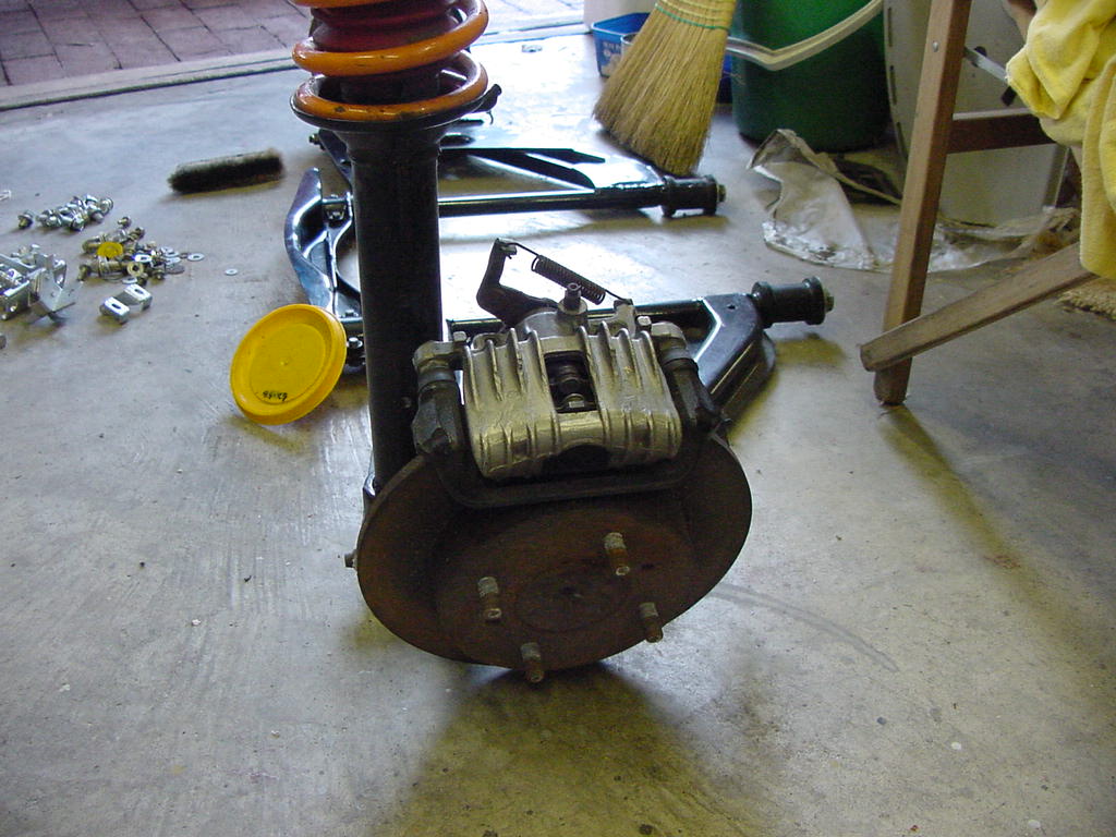

luke240ZED Posted November 22, 2011 Posted November 22, 2011 I'll do a short video and put it on utube. Simon M will love that. Come on Scoota, my grinder is awaiting your video. Now should I mount them at 12 o'clock or at 10 o'clock towards the front using the opposite sides caliper??? I'm sure a nice video could solve this Cheers mate Quote
Scoota G Posted November 25, 2011 Author Posted November 25, 2011 Oh bugger, my bad. I'll do it this evening. But yes mount towards front as they will foul the strut tower at 12 o'clock. Quote

Ben Posted December 2, 2011 Posted December 2, 2011 Oh bugger, my bad. I'll do it this evening. But yes mount towards front as they will foul the strut tower at 12 o'clock. Mine don't I'd take some more recent photo's but the rear end is currently apart (well almost - I have a stub-axle nut that refuses to let go) for my Z31 CV conversion. (attached is one from 2001!) Quote
