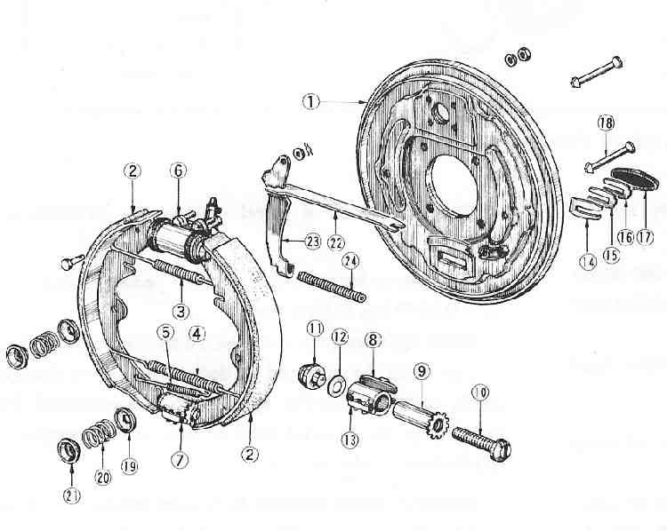

ZD44TT Posted January 28, 2007 Author Posted January 28, 2007 I found this diagram wooHooo. But how do I get item 14-->16 off? Not for my car but the part concerned is very similar. Quote
zr240 Posted January 28, 2007 Posted January 28, 2007 hi I havent done this before but thought I might be able to help. It says in my z service manula remove anchor plate nuts from reverse side and just to drive the shim/ anchor block out. I can see on th pic of your drum that there are some bolts/screws holding th anchor block on so if you can get to them and remove them then you should be able to get the anchor block off Ash Quote
ZD44TT Posted January 28, 2007 Author Posted January 28, 2007 this one?........ thanks heaps for looking that up......hahah dam i gotta get that manual. Quote

nat0_240_chevZ Posted January 29, 2007 Posted January 29, 2007 $260? farkmedrunkbloodyleeches bloody ripped off, i got 2 @ 24$ each, id be looking elsewhere. just some advice. yea those horseshoe clips just use a screwdriver and small hammer, slide theop one off first then the one below the other way, have small indents to hold them together a lil better. nat0 Quote
