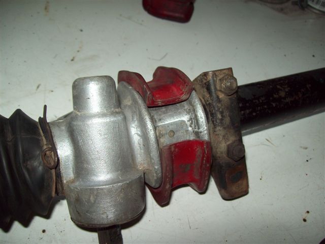

RB30X Posted April 15, 2011 Posted April 15, 2011 Hi guys. Here's a blast from the past. I'm out at a track day today but yesterday I was giving it some with the formula r's on the front (I usually run them on the rear) and now it seems I have cracked my steering rack bushes. I noticed a bit of play when driving here today so I had a look and you can see the rack moving when turning the wheels indicating the bushes are shot. The seems to be stoppers on the rack so it can't move too far so I hope nothing else breaks today. Question is, where do you get replacements from? My Old ones are a blue colour. Quote

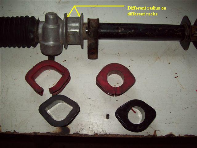

PeterAllen Posted April 16, 2011 Posted April 16, 2011 Tim - Leave yourself plenty of time to fit new rack bushes. It appears there are several casting profiles of the rack making it sometimes difficult to match the bushes to the rack profile. You may find it necessary to sculpture the outer edges of the bore profile of the new bushes (sharp knife or hot wire) to suit your rack. I THINK (always dangerous) the bushes supplied now are all 260Z bushes but as many 240Z were simply fitted with the different profile 260Z racks if a new one was needed you could be okay. The photos might illustrate what I mean. The red bushes were on the car when I got it; someone was merely too lazy to reshape the bore to fit the rack. The new black bush was the same profile as the red one and needed to be reshaped. The cylindrical bore bush should be okay. Hope yours mate up well but just letting you know what may be ahead. Quote
RB30X Posted April 16, 2011 Posted April 16, 2011 Thanks Peter, I'll pull it out soon and compare photos. Those two ridges with the yellow arrows is what kept the rack in the saddles on mine today Quote
RB30X Posted May 3, 2011 Posted May 3, 2011 As promised, here is a photo of my bushes compared to the new ones. Quote
PZG302 Posted May 3, 2011 Posted May 3, 2011 Yep, that would be causing a little bit of rack movement Mine were nowhere near that bad and I had about 1/2" of movement in the rack. Your car must have been near undriveable. Quote
