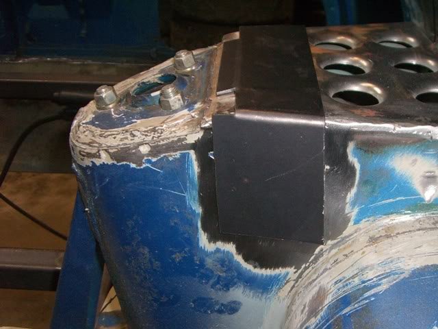

ZD44TT Posted January 18, 2007 Posted January 18, 2007 Just thought I'd post a pic to ask if any of you out there have tried to dramatically lower the weight of your z? If so, what did you get it down to? And more importantly where did you take the weight out from? heres what I mean: This is defly not for the stock/purest type of Z owner so please don't flame. http://www.no-rice.com/forum/index.php?fr=420&p=vt&tid=7680 Quote

Toecutter Posted January 23, 2007 Posted January 23, 2007 hehe...looks odd with all those holes. The first thing I thought is whether it's worth the compromise of so little weight loss in regards to the reduced structural integrity of that section of the car. Maybe the owner found this out the hard way when they dfrilled into that rear strutt tower as they've added more weight than removed with that little brace! I've never raced cars but on a serious note, at a competative level do drivers get to a point where their own weight loss becomes an issue??? Quote
