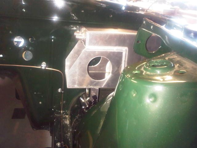

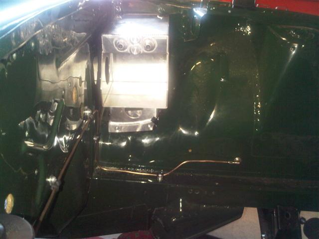

NZeder Posted February 14, 2011 Posted February 14, 2011 I had a new battery tray made. This holds the battery underneath a oil catch can. It was custom made and a one off. I have really bad Cell Phone pic I will attach for you. My battery is a small dry cell unit and as my zed is EFI like Dimitri I should not have any starting issues. Since these pics were taken I have added the vent filter on the top - also under the centre of the catch can area is another Dash AN fitting that comes forward to a tap just under the battery. I then add a Dash 6 hose fitting when I need to drain the can. Quote

620Z Posted February 14, 2011 Posted February 14, 2011 Wow I like that box NZeder. You should patent that one. Quote
luvemfast Posted February 14, 2011 Posted February 14, 2011 I'd be concerned about sparks and the fumes in the box though NZeder Very pretty though Quote
NZeder Posted February 14, 2011 Posted February 14, 2011 I'd be concerned about sparks and the fumes in the box though NZeder Very pretty though How so? It is a sealed battery that does "Gas Recombination" and is a "lead-calcium tin alloy" aka no acid so how can that fume - it can be mounted in "any orientation" upside down if you wish. Sparks....well if you are that worried about sparks don't drive a stock zed then have you seen how close the factory battery holder is to the positive terminal - much closer than this setup. Trust me I know - my zed caught fire many many years ago at a sealed gymkhana event when the battery moved 3-4 mm shorting out the + on the factory holder = Fire and melted/welded battery holder = rewire the high power part of the car as that all got smoked too (ie alternator wires, fusible links Quote
luvemfast Posted February 14, 2011 Posted February 14, 2011 Thinking more so when you disconnect and reconnect the battery, only needs a tiny spark and a build up of fumes from the catchcan. Just a thought, thats all. It is a thing of beauty though, great use of space. Quote
NZeder Posted February 14, 2011 Posted February 14, 2011 Thinking more so when you disconnect and reconnect the battery, only needs a tiny spark and a build up of fumes from the catchcan. Just a thought, thats all. It is a thing of beauty though, great use of space. ok those fumes. Well I would hope my engine does not fume that much + I don't plan on disconnecting the battery very often either. I have a isolating switch/circuit breaker to disconnect the battery and will have another location for posts for charging and jumping if need be. And you are right it does look beautiful - cost a bit and now the inner guards have been drilled for it to be mounted it will be staying. Quote

Wayne G Posted February 15, 2011 Posted February 15, 2011 Love the fab work and use of space NZeder! My concern would be that annoying seep of oil that catch cans have eventually covering the battery. As far as mounting the battery in the back of the vehicle, a large wire from battery +ve to starter and large wire to body then large wire from body to engine should suffice. Large wire needed because of the voltage drop experienced, especially whilst cranking the engine. Securely mount the battery and then cover it to prevent cargo causing issues ie. something metal touching exposed terminals and letting the smoke out. Everyone knows that electrical systems can't function without the smoke secured inside. Quote
