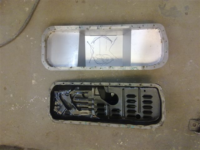

nat0_240_chevZ Posted October 13, 2010 Posted October 13, 2010 hi guys, im making my own RB into s30-Z sump, I have my first successful mock up in thin steel. when i have finalised the design, wondering what sort of interest there would be for more, as when i make mine its easier to make more at the same time, but as i have limited time available i thought id get the interest first up, as im only thinking of running one batch. Open to actual the actual config they are finished in, as mine will have baffle, side wings aswell as other performance features as used in race/track type items. these are not only restricted to the s30, but any mid-rear sump bowl requirement. so if your after just a basic sump then let me know. no pricing has been considered yet nor confirmed, as the details are still vague. Should be around the cost of a new nissan one (if they were/are still available) for a basic unit (inc horiz. baffle) about the 600-650 mark. but like i said above, details to be confimed. as shown in pics, this is the first mockup only, wings, baffles and diversion blades are to be finalised now that i have a sump which fits. Sump retains the stock std engine-to-gearbox braces, as these are important. can include external oil fittings for pumps/coolers/turbos & returns etc. utilises the rear dipstick position on the rb, to suit 20/25/30 and possibly 26 depending on request. Any sales will contribute a donation to the forum they sell from, as its not about profiteering, just supplying what people need and not really for sale any more. reply here or pm through forum. cheers nat0 Quote

nat0_240_chevZ Posted October 14, 2010 Author Posted October 14, 2010 Would you be modifying the oil pickups as well? or just making the sumps? Ill most likely look at supplying new ones to suit with the sump, as its a sure way to confirm it all fits, although to modify the pickup is quiet simple and straight forward. Ill be doing the sumps, and I anticipate the basic unit to be baffled & caged around the pickup, only, not full directional vanes which i will be using along with the wings for extra capacity, basic capacity at present is approx 5.8L but i may shrink it down slightly to make it more versatile to those that are dropping into toranas and other conversions, unless of course i can pick up extra volume in mk-2 mockup. Nat0 Quote

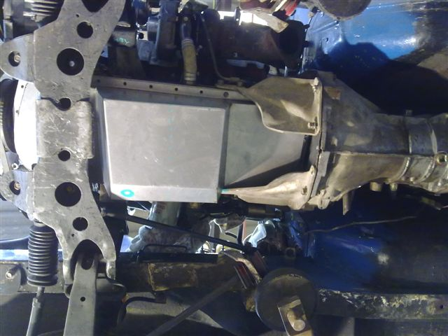

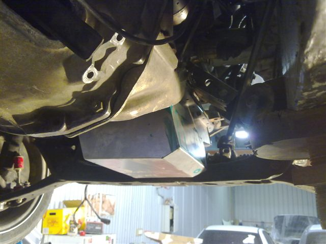

nat0_240_chevZ Posted October 25, 2010 Author Posted October 25, 2010 mk-2 mockup sump nearly complete, looks good, will take pics once i get a minute tonight, only another mockup, however it could be used as it is pretty sweet. long side flanges look very stock with their return flange & will either have a ribbing included for sealant capture or an engraved groove all around on either side of bolt holes. this assists in sealing heaps, also getting a new laser cutting machine @ work so more to come on all fronts. ill tack up this unit tonight. Already test fitted and its sweet, withe the rb back 50mm anyways. without wings its only probably about 4-5L max but the wings i hope to open that up to 6-7L. baffles and vanes still not trialed yet as the main sump is my main hurdle. I doubt the us guys will be interested with our very high $$ @ present, but who cares. going by ease of production thus far (without all the extras) i dare say for about $500 for the sump only as a basic unit, with baffle. anyways, picture speak louder than words, as soon as i can ill post pics. nat0 PS jpav, havent forgot about you, also working on it. and xyzed, youre def using, my mounts & sump? nat0 Quote

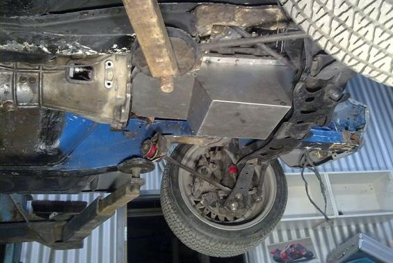

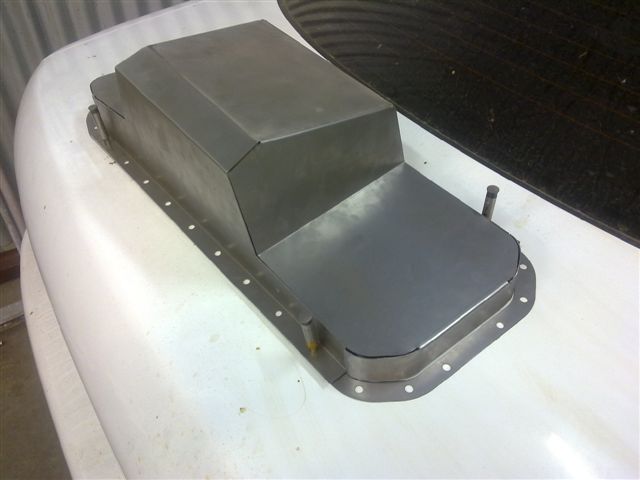

nat0_240_chevZ Posted October 27, 2010 Author Posted October 27, 2010 ok. finished with the mk-s version of the sump, much cleaner shape than previous. -Now actually clears the engine to gearbox bracing, -shape has been changed to remove sharp lower edge on rh side. also pos' for sump drain plug. -In its current state without the wing which are coming next it holds approx 5L of fluid/oil at about the 'H' mark on the dipstick, when re-located to the std rear position, (final checks and measures pending) so about the stock volume of the front pans in the skylines. -stiffening flanges added to straight edges of pan, all made from 1 piece except the front and back curves, as seen pinned in place for tacking up. overall pretty happy with the shape, position and fit with all the stock items, as getting the shape right on this and to be able to make it right is not easy by any means and have spent many hours on this. Currently working on the baffle, extra capacity wings, and inserts to divert/maintain oil around the pickup during cornering and braking etc. hopefully have these sorted in the next day or so. shall keep updates happening. also other improvements happening along the way. hope you can make out the pics, more available, any q's nat0 Quote

nat0_240_chevZ Posted October 28, 2010 Author Posted October 28, 2010 yes stock stiffening brackets, from an R34 gtt. 26 sumps are cast and heavey,(even without the diff), and have very little volume due to the dif etc, and std have limited baffling, hence the 1st upgrade any owner should do if hitting any boost or corners fullstop. Im not really trying to make a market for these kato, im just doing my own, and if anyone else wants in on a batch run, then they can benifeit from this too, but after that, ill let my work sell them, but 1 offs will cost a bit..... However if later down the track there was a group buy, i could have organised for them but i wouldnt want to be involved as mine is all done and dont need any more than 2-3 for myself. thanks for the ups, this is only a mockup guys not the real thing, remember that. plenty of improvements and additions etc to come. Just wait till you see the final product, but i think its good to let everyone see the developments just so all are aware what needs to go into such fabrications etc, and let me tell you trying to have 30 odd holes line up and not leak aswell as perform its requiered function is not easy.... cheers nat0 Quote
nat0_240_chevZ Posted October 28, 2010 Author Posted October 28, 2010 oh and did i mention that the latest pics are not even tacked / welded together?? just incase anyone did not notice.....thats free form, makes welding it all up easier that is for sure. nat0 Quote
