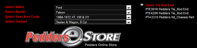

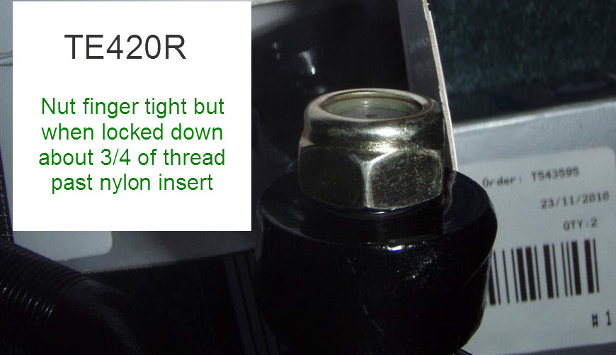

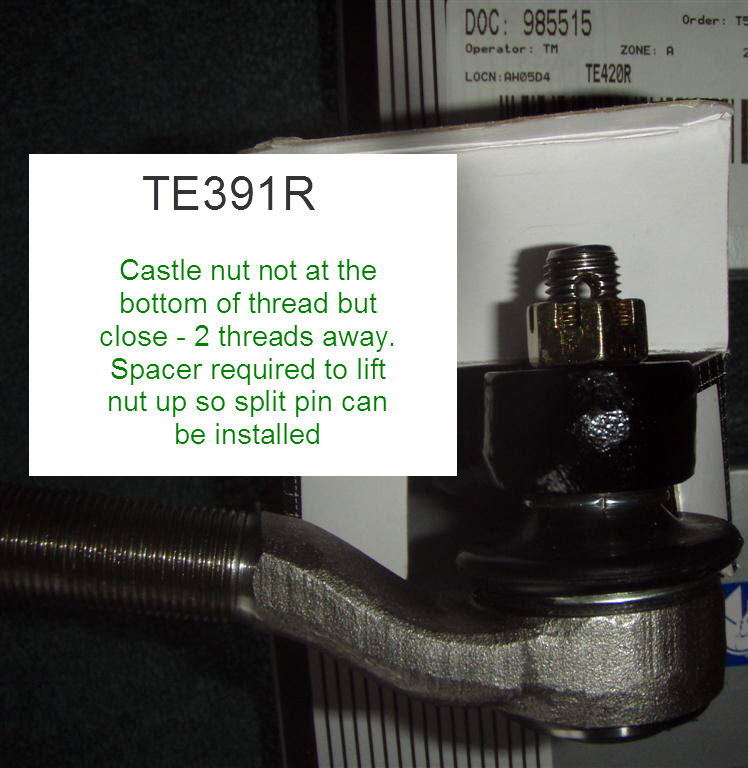

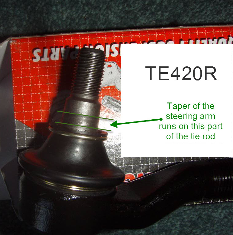

NZeder Posted November 13, 2010 Posted November 13, 2010 To complete the tie-rod I used: - 2 RH thread Falcon Tie-rod ends, Pedder’s Part #PTE391R (Bursons auto parts. Road Safe brand part number: TE420R). These come off an XT-XW-XY Ford Falcon from 1968-1972. I don’t know what you could use in the states, but probably something off of a mustang or similar. Ok I picked up some TE420R today and news could be better. The XY only uses TE420R however the XW uses TE420R and another version TE391R (notice how that partnumber is almost the same as the one Whitte got PTE391R) so I think the XY is the incorrect information which has lead me on a little bit of incorrect direction + the TE420R partnumber sorry Lurch So I installed the TE420R in my steering arm and notice it does work but the nylock nut supplied is only just starting to lock when it's all good and tight. This is not like the pic Whittie has shown above with his install - this show at least 2-3 threads. So I started checking catalogues online. I attach a pic from the NZ suppliers online catalogue it shows the TE420R as the 0.510 tapper and the TE391R as the 0.538 top of the tapper. So this also lead me believe the TE420R to be correct as the 240z/260z is 0.520 at the top of the tapper. The second pic is form the RoadSafe catalogue I found online. It shows the reverse aka TE391R with the smaller top dia/tapper and the TE420R with the larger. So tomorrow I will see if I can return the TE420R and swap for TE391R and confirm the top tappers. I also put at set of calipers over TE420R and the stock tie rod I get TE420R = 13.7mm at the top of the tapper = 0.539 Stock = 13.2mm at the top of tapper = 0.519 I will update this post once I have the TE391R and can confirm the correct tapper/install I will then post the US info ie Moog partnumbers and more info Quote

NZeder Posted November 25, 2010 Posted November 25, 2010 Update time. I will let the pics tell most of the story. But there are 2 type of tie rods for the XT-XW-XY range of falcon. Those known as early Ford and then the later type. Tapers are different but all other dimensions are the same. Quote
