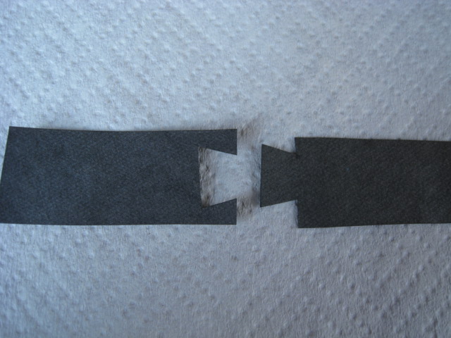

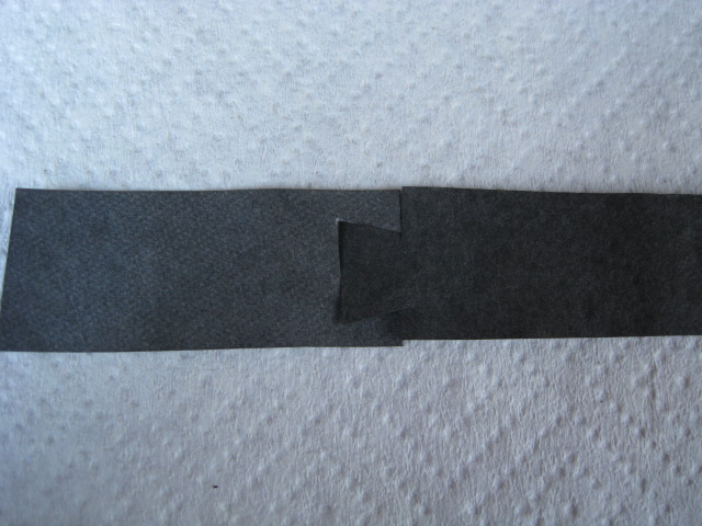

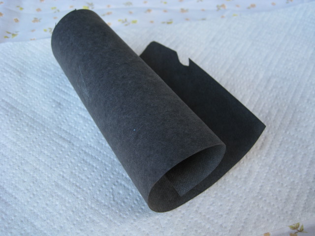

Zedsabbath Posted June 18, 2010 Posted June 18, 2010 There is sheets of black gasket paper you can by at any auto parts or accessory shop but some don't stock it anymore because of lack of sales I think but it comes in lengths plenty long enough for a rocker cover gasket Photo shows a bit left over from gasket making that I've done here at home...it comes in two thicknesses and the bit shown is the thin size...the thick size would be best for a rocker cover gasket If you use only a sealant, I'd recommend Loctite no 3 aviation gasket sealant but the surfaces must be totally free of oil and apply a thin coating to both surfaces...leave a while before starting your engine....best to have a gasket though! You should also be able to buy thin neoprene cork (more readily available than the black paper I mentioned above) at SuperCheap Autos and others stores If ever a paper or cork sheet is too short, you can always "dovetail" sections of a gasket, dovetail shown in 2nd and 3rd photos Pete Quote
DatPilot Posted June 21, 2010 Posted June 21, 2010 Very good Tip there, cheers! I was thinking of ways to join the gasket material, and just coudnt really figure it out. Quote
