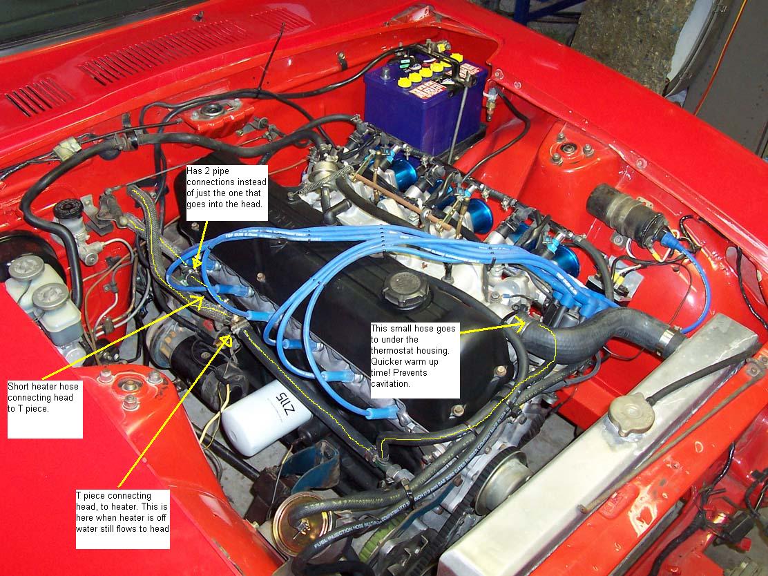

Moderators Zedman240® Posted March 7, 2010 Moderators Share Posted March 7, 2010 Dont forget to plug up the other opening under the thermostat housing...or you could plumb up the bypass from under the thermostat to where the lower radiator hose goes into the timing cover at the front. If you need pics, I can provide. Quote Link to comment Share on other sites More sharing options...
Dandaman Posted March 7, 2010 Author Share Posted March 7, 2010 i was going to stick a bolt through the opening on the thermostat base, have a rubber stopper for the 3 way pipe on the other side (temporary) will look for an elbow to replace this...i could do with a photo on this point if you have one Zedman, need a tidy way to deal with the mount if i have a hose clamp in the way. Quote Link to comment Share on other sites More sharing options...

Moderators Zedman240® Posted March 17, 2010 Moderators Share Posted March 17, 2010 Sorry it took a bit of time, hope it explains it better. It's an older pic but not much has changed. Quote Link to comment Share on other sites More sharing options...
Dandaman Posted March 17, 2010 Author Share Posted March 17, 2010 Thanks for the pic Zedman, ill definitely have a go at replumbing when i have some time. and cheers for the advice Timwell, in the end i was advised to just replace the heater pipe with some heater hose as it served to do more than warm the carbs, something about condensation and flow...my neighbour lost me somewhere near the beginning of that explanation. Plus replacing with hose was alot simpler to do. Shes been on the road since last thursday Quote Link to comment Share on other sites More sharing options...
