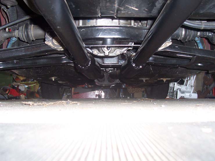

stevo_gj Posted March 3, 2010 Posted March 3, 2010 Awesommee. Can you show us what it looks like in the engine bay? Were the headers custom too? How low is it compared to the old exhaust IE will it scrape on speedbumps and how lastly how much did it cost you? Definitely considering this setup for the future. Quote
Moderators Zedman240® Posted March 3, 2010 Author Moderators Posted March 3, 2010 My headers secondaries end with 2 pipes at a flange. The rest of the system from that flange stays double all the way to the back. The center muffler I'm using is a strange one. Its a stainless straight through 2 in, 2 out 2" then 2 hot dogs at the diff then straight out the rear. There's plenty of ground clearance, as my zed isn't too low. It cost $250, but i supplied the mufflers and flange. I'll post up pics tonight... Quote

Moderators Zedman240® Posted April 26, 2010 Author Moderators Posted April 26, 2010 Heres the pic; beyond the centre resonator is a little hard to see but from the header secondaries, they just both go straight into the resonator then what you see in the pic. Quote
