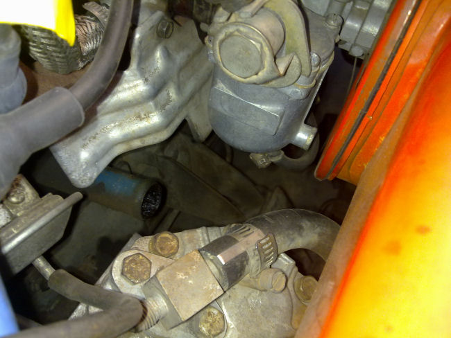

webbered six Posted January 16, 2010 Author Posted January 16, 2010 C210 engine mounts. How do these compare to the z? Quote
C.A.R. Posted January 16, 2010 Posted January 16, 2010 Similar. But the steel mount on the engine looks shorter. Here's a PS shot on a 240Z: Quote

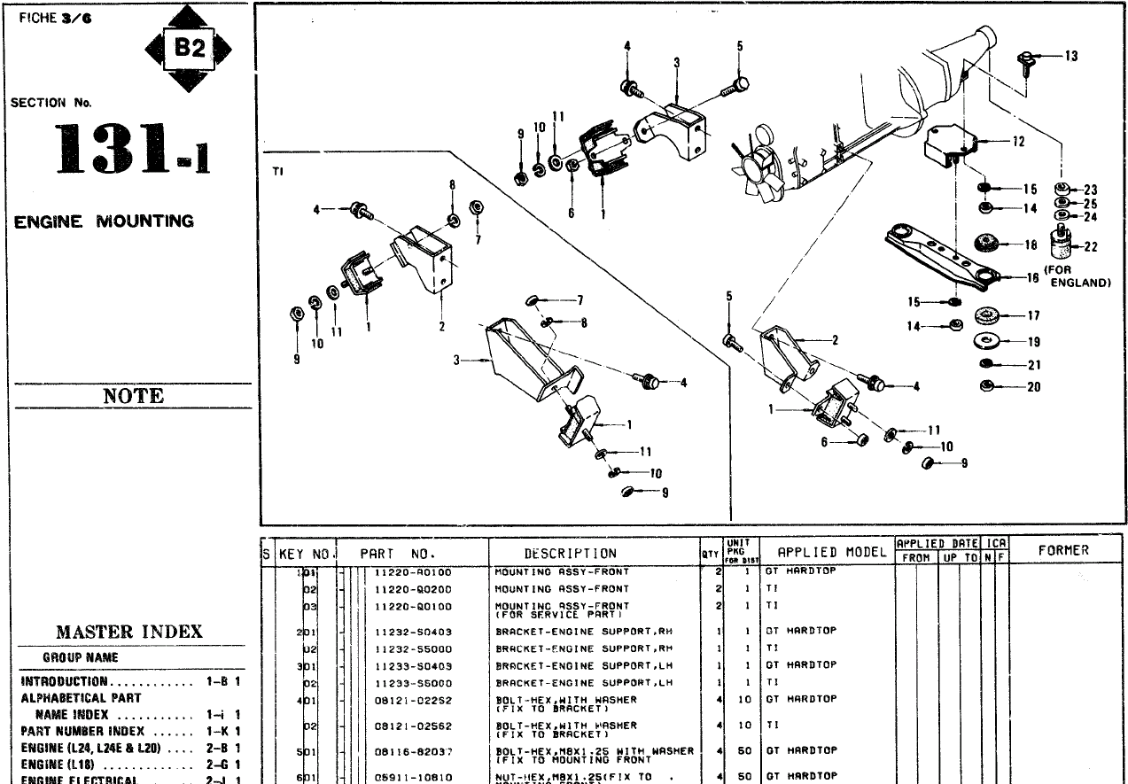

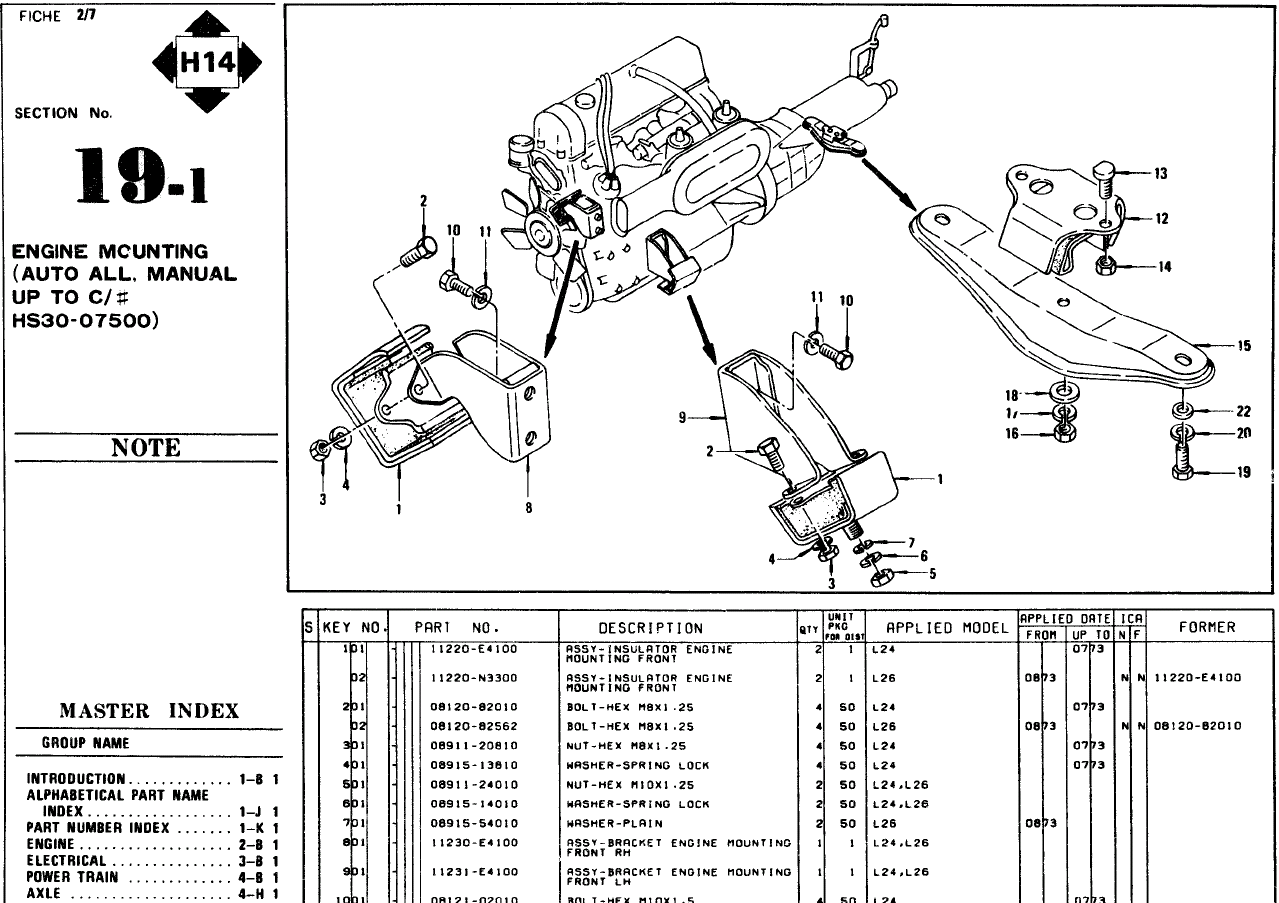

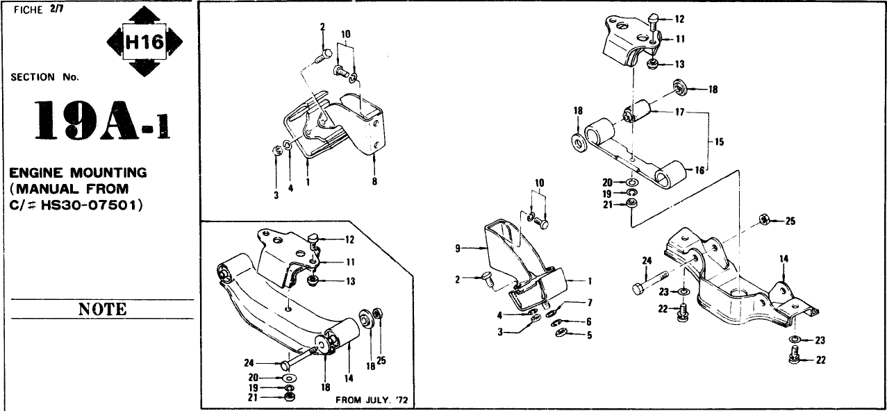

NZeder Posted January 16, 2010 Posted January 16, 2010 Engine mounts are way different. The C210/240k/Skyline mount has 2 bolts on the bottom - the zed just one. Here is come screen shots from the parts catalogues from each model showing the engine mounting for the L6 engines. EDIT: Just added the later 240z mounts for those interested. Quote
