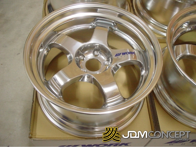

Administrators gav240z Posted August 2, 2006 Administrators Posted August 2, 2006 Hey Sulio those wheels are alright, they are a mock up of these wheels. (See images attached). The real deal go for $3,500 - $5000 for a set of 4. Yes expensive, but doesn't stop me wanting a set Quote
zedevan Posted August 2, 2006 Author Posted August 2, 2006 yeah rota make some nice copies, i wasn't able to find any places in australia that sell them, but some come up for sale every now and again. i wonder what offset is on them, tried reading though the hybridz thread quickly but to confusing! postage is around the US$400 mark so i personally dont think i'd bother, and get some proper 3 peice instead later on Quote
