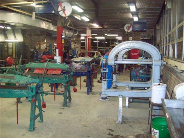

PeterAllen Posted September 20, 2009 Posted September 20, 2009 Enrol in this course and make your own! http://www.sit.nsw.edu.au/courses/search.php?cid=16047&area=courses&Media_Index_ID=169 The starting date for next term is 19th October, not 21Sept. Note the English wheels... perfect for making a new roof. All materials included in the fee. Quote
