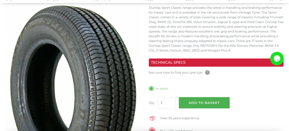

AndBir Posted October 15, 2022 Posted October 15, 2022 (edited) On 10/14/2022 at 8:56 PM, gav240z said: I'm open to alternatives but previous experience finding 14' tyres that are not aimed at the trailer market are limited to date. Not sure how these are rated re car vs trailer use but I went with these : Dunlop 195/70R14 Sport Classic 91V, edit - decided I would npt be exceeding 210kph so went with the Dunlop LM Sport 704 195/70R14 91H Others that may suit : https://www.stuckey.com.au/Tyres/TyreSearch?Search=195/70R14 Russell at Stuckey Tyres (Brunswick, Melb) may be able to source Advan. Edited October 22, 2022 by AndBir added the "actual" tyres I put on the 260Z gav240z 1 Quote

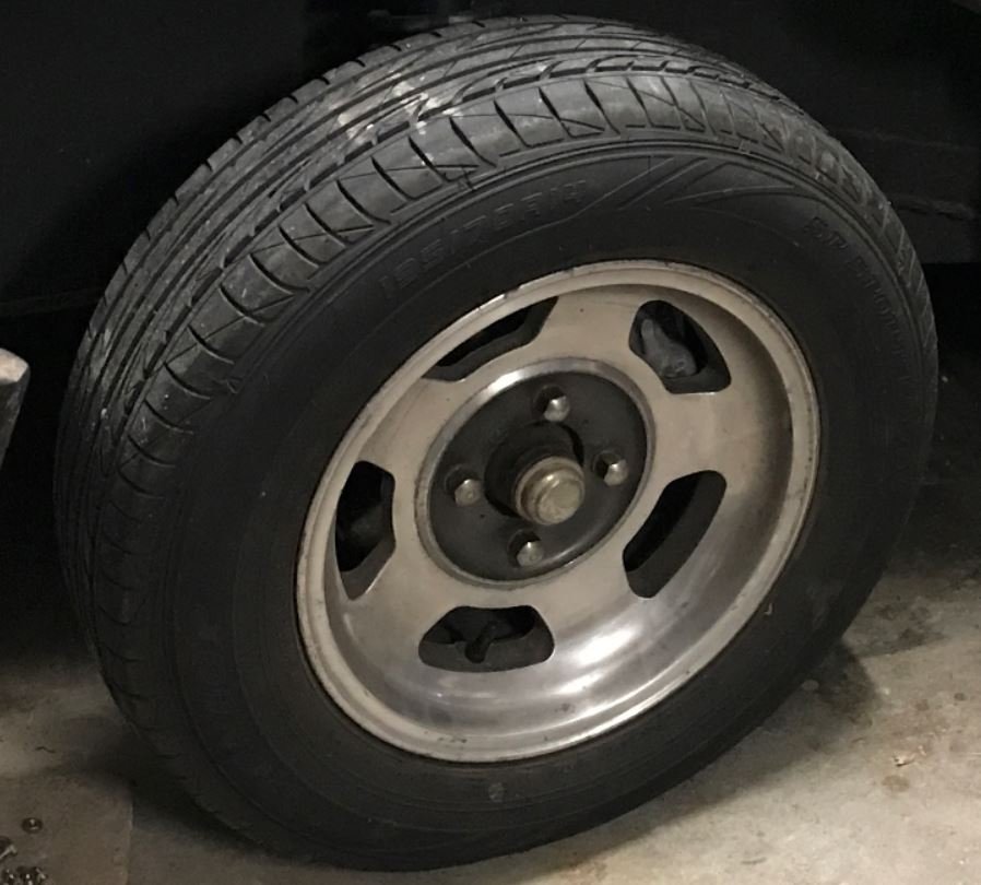

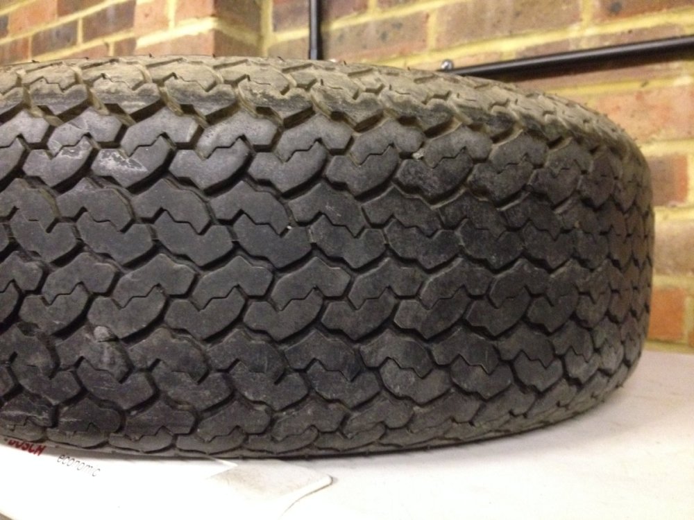

AndBir Posted October 27, 2022 Posted October 27, 2022 12 hours ago, gav240z said: Any photos of what these look like? This is the Dunlop LM Sport 704 195/70R14 on the 1974 alloys of my 260z not a classic looking tread but the correct profile and circumference : Whereas the Bridgestone RD-102 "wide" 195/70 R14 tyres that came with the car in 1974 had this tread pattern (similar to those posted by NickF): gav240z 1 Quote

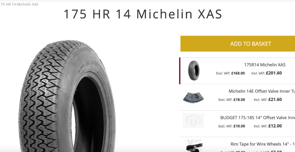

AndBir Posted October 27, 2022 Posted October 27, 2022 27 minutes ago, gav240z said: Problem is the Kobe Seiko wheels are 7" wide. Maybe the Vredestein Sprint Classic 195/70r14 on the Kobe Seiko wheels and the 175R14 on the standard steel wheel for a spare that fits nicely in the spare wheel well without a "lump" showing in the rear floor area. gav240z 1 Quote
NickF Posted October 27, 2022 Posted October 27, 2022 11 minutes ago, AndBir said: Maybe the Vredestein Sprint Classic 195/70r14 on the Kobe Seiko wheels and the 175R14 on the standard steel wheel for a spare that fits nicely in the spare wheel well without a "lump" showing in the rear floor area. Perfect not cheap but has the period look and the right size Quote
