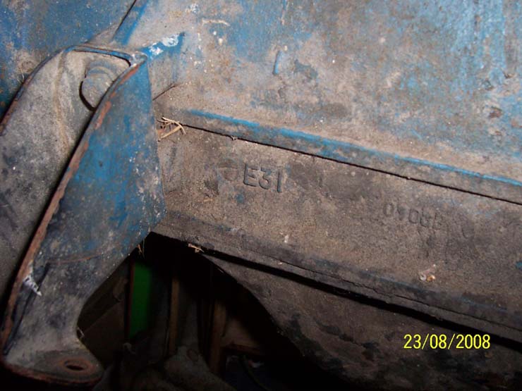

Moderators Zedman240® Posted August 22, 2008 Moderators Posted August 22, 2008 I thought "a pic is worth a thousand words" so heres a pic of my L24 block but I'm sure they are all in the same spot near the passenger side engine mount. Mine says E31 but your's will say something else... Quote
