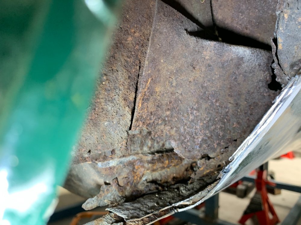

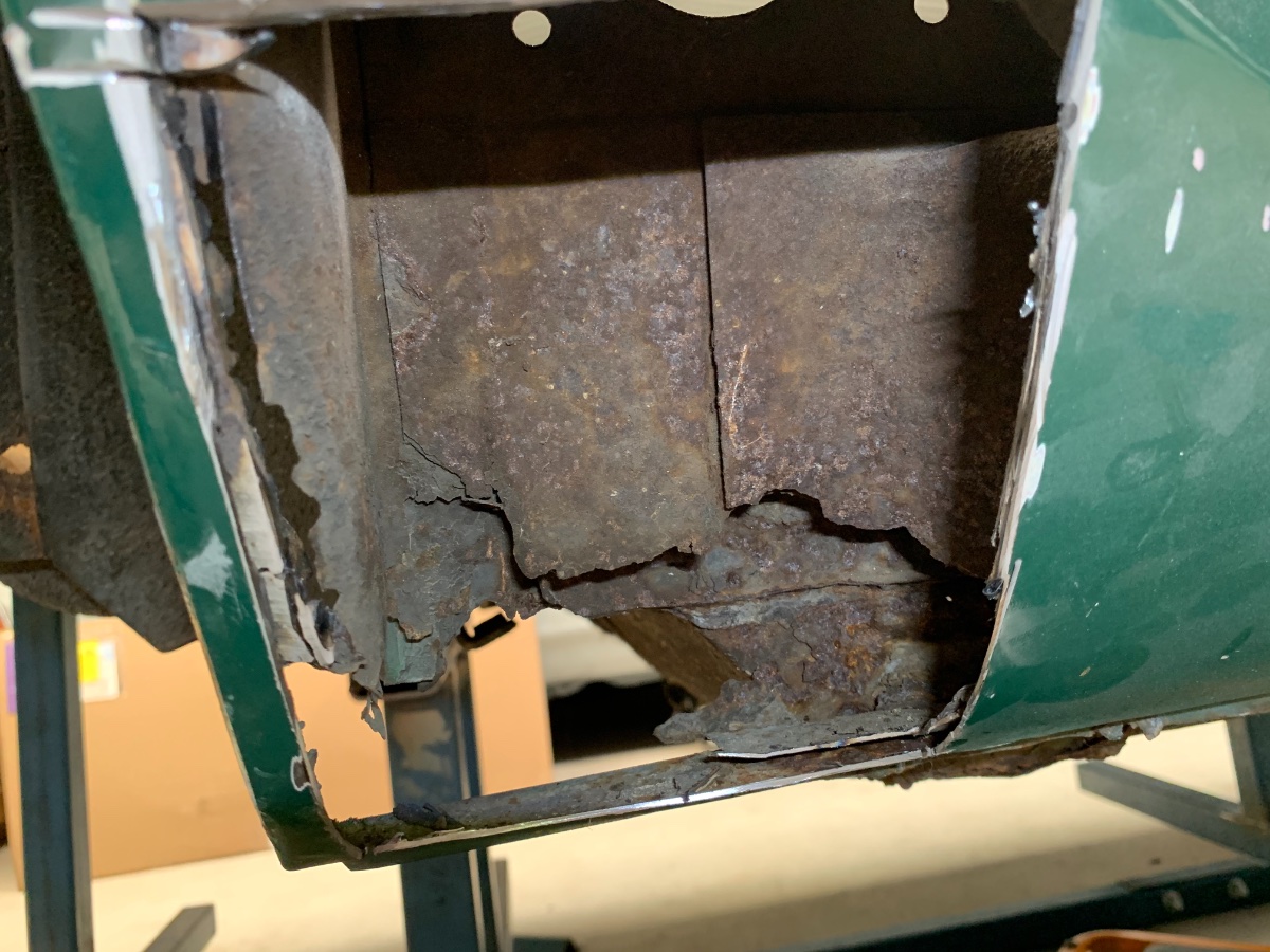

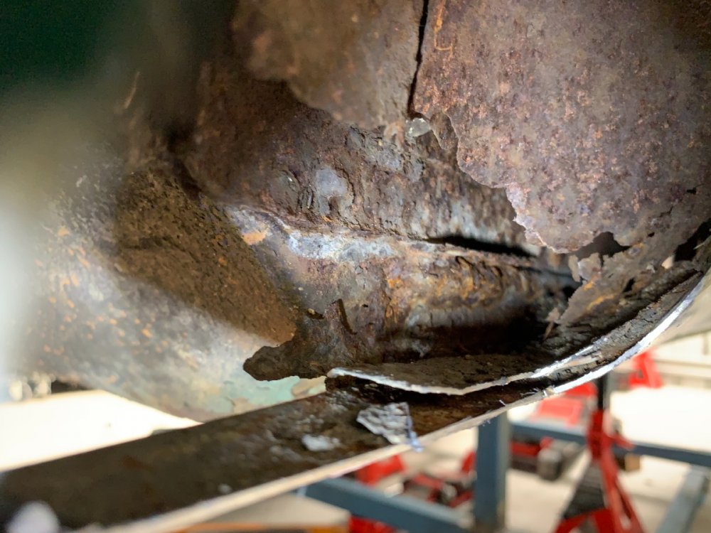

240ZBUILTBYME Posted February 22, 2021 Author Posted February 22, 2021 Sooo plan has to change.... lol Went and visited the car today, started making a plan for replacing the floors and on further inspection, the doglegs and surrounding structure are rustier than I thought. I cut out a hole in the dogleg to get a better look and found this is what I found. and it’s much the same on the other side. some of the inner rocker and inner reinforcement (panel wedged between inner and outer rocker) has rotted away. So to do the floors I need to sort all this out as well otherwise I have nothing to weld my floors to..... it’s like a thread pull that eventually unravels the whole jumper.... anyone let me know if I’m wrong. so I’ll plan to do majority of the rust repair before she goes for final stripping/ blasting. also found some pretty serious rust in the corner of my tool compartments... I have a cunning plan to remove the two skins that make up the tool compartments together so I can have room to repair everything underneath. But that is a whole other thread when the time comes... Mike_F 1 Quote
Mike_F Posted February 22, 2021 Posted February 22, 2021 So, to paraphrase, are you taking a rocker panel off, then replacing the outside frame rail, the welding the new rocker panel back on, then doing the other side? If so, that sounds about right from what I have seen. I think CBR Jeff did a similar thing on his car. Quote

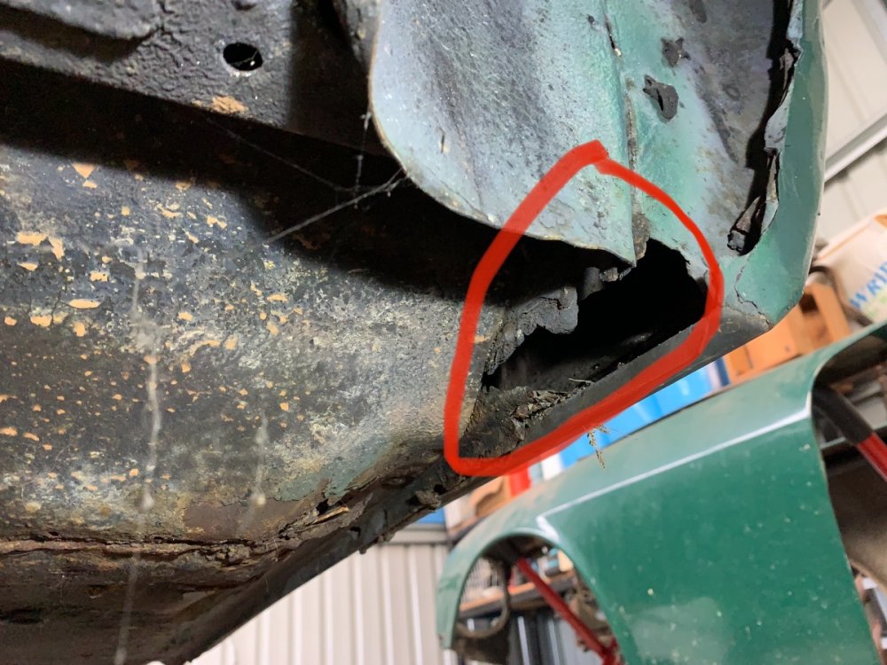

240ZBUILTBYME Posted February 23, 2021 Author Posted February 23, 2021 (edited) I am putting together a comprehensive plan for doing the floors, doglegs, rockers and rear wheels arches. I will post here you all to critique soon. one thing I need to clarify is the sequence of the panels in the very corner of the dogleg. Everything is very rusted and difficult to distinguish. Might need the maestro of metal on this one @C.A.F. starting from the outside: 1.Outer rocker 2. Reinforcement plate/inner dogleg b pillar 3. Outer side of inner wheel arch 4. Inner rocker 5. Inner side of inner wheel arch is this right? Which panel shows externally in the section I have circled closest to the floor pan? I think it Is the inner rocker? Does the two inner wheel arch panels sandwich the inner rocker? Ryan Edited February 23, 2021 by 240ZBUILTBYME Quote

CBR Jeff Posted February 23, 2021 Posted February 23, 2021 Study the exploded views in the parts manuals in the members only section. It will help work out what goes in what order. Jeff Mike_F and 240ZBUILTBYME 1 1 Quote
Mike_F Posted February 23, 2021 Posted February 23, 2021 Yeah - there's 5 from that angle. The 6th (which was buggered on mine) was the top/right over there, inbetween the door and the B Pillar. I'm not sure what its called, but its that nice flowing bit that flows onto the rocker panel. The Dog Leg spot welds onto that. This bit in this first photo... 240ZBUILTBYME 1 Quote
