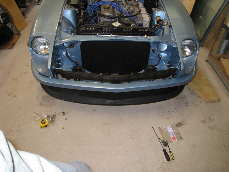

stevo_gj Posted October 15, 2008 Author Posted October 15, 2008 Nick from Adelaide Z cars just told me they got some of their air dams in stock Below is a picture of Sushi's 240z with this style of spoiler installed. Quote
stevo_gj Posted October 18, 2008 Author Posted October 18, 2008 Well I received it yesterday and spent most of the day mucking around under the front of my car making it fit. Overall I am very pleased with the results and will post pictures tomorrow night or in the next couple of days. Finally my Zed has the shape I have always wanted Quote

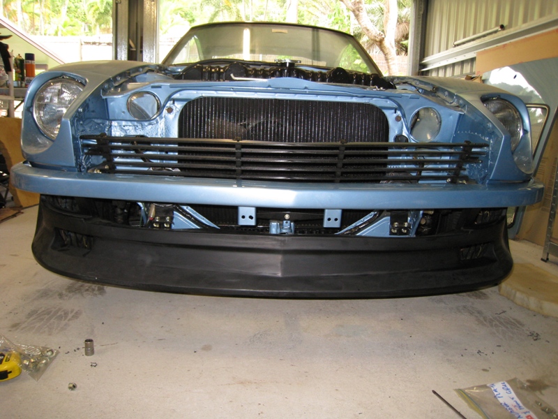

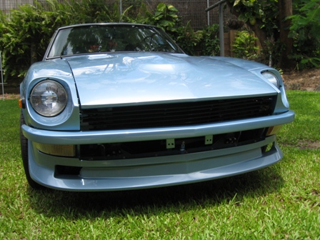

crowe Posted November 4, 2008 Posted November 4, 2008 Thanks Stevo, I found another post where some guys did some additional bracing, i will follow their lead and do similar. What are you going to do about your tow hooks (if anything). I noticed today with the spoiler added to the front the tow hooks will be inaccessible. Any ideas? Some fitting photos attached for those interested Quote
stevo_gj Posted November 4, 2008 Author Posted November 4, 2008 Fitment looks good mate. I don't have any ideas about the tow hooks, not sure if I'll get anything done with regards to it... New GF will probably eat up a bit more of my car time/money as well so I may not be able to finish the job til I come back from the mines over christmas. I'll still get some photos of the car with the black air dam on it when I can. Quote
Scando Posted November 4, 2008 Posted November 4, 2008 I noticed today with the spoiler added to the front the tow hooks will be inaccessible. Any ideas? If you look closely on the passenger side in this pic: we made a tow hook that bolts onto the the original tow point and sticks out above the front bar on the passenger side. Could be an option? Quote

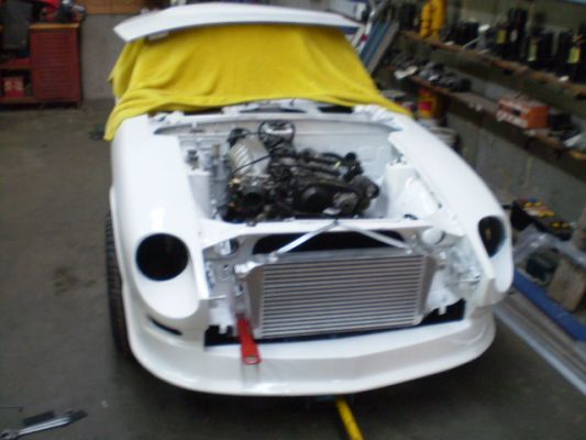

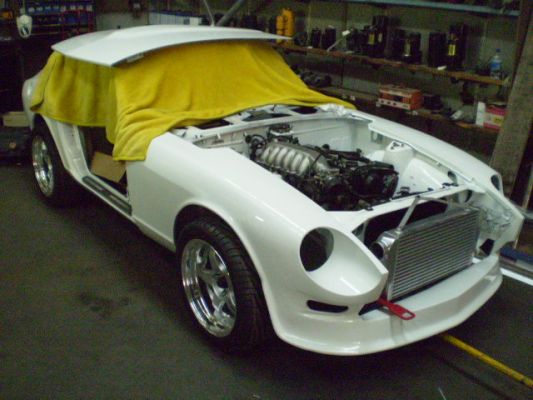

Hunter Posted November 5, 2008 Posted November 5, 2008 Look up Mayhems gallery or build thread. he has a different sort of tow hook. Here is a cams tow hook on ebay that can be bolted the chassis frame rail. I am not sure id it is the same as Mayhems but looks very similar. http://cgi.ebay.com.au/RACE-CAR-TOW-HOOK-SUIT-RACE-RALLY-DRIFT-RACING-V8_W0QQitemZ190262225260QQcmdZViewItem?hash=item190262225260&_trksid=p3286.c0.m14&_trkparms=66%3A2%7C65%3A1%7C39%3A1%7C240%3A1318 Quote
Scando Posted November 6, 2008 Posted November 6, 2008 Can you give me any more details on the hook you used, materials and size etc. The hook is just a piece of steel rod (about 8-10mm diameter) heated in the middle with an oxy and then bent 180 degrees. Welded the ends to a flat peice of steel and drilled a couple of holes in it to bolt it to the car. Hope that makes sense It's plenty strong enough to tow the car with. Quote

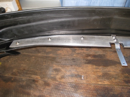

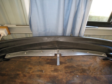

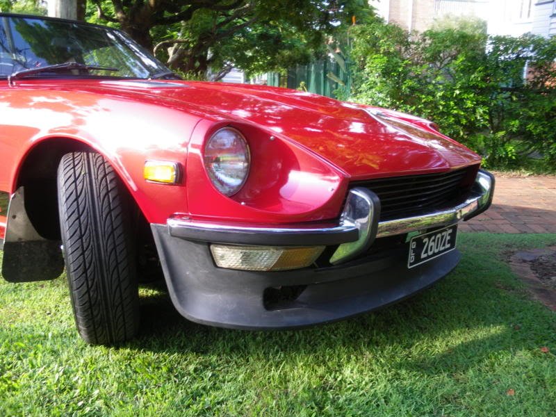

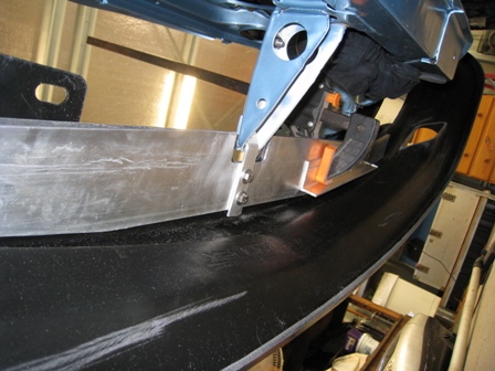

stevo_gj Posted February 27, 2009 Author Posted February 27, 2009 Hey guys, Just to finalise this thread, here are the pictures of the air dam currently. I will get it painted red in the coming months at my friends workshop. I had my mechanic make a brace to firm up the centre of the air dam. It's basically a plate running hidden behind the air dam. Quote

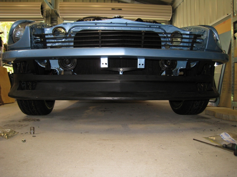

crowe Posted February 27, 2009 Posted February 27, 2009 Good thinkin Stevo, here are pics of the final product and bracing I did The plate was pretty simple, i ended up using salastic and bolts to make sure it is sturdy, it is braced to the centre grill mount Quote

stevo_gj Posted March 10, 2009 Author Posted March 10, 2009 If you paid around 395 then yep its a PU. As for fitment, what you see is what you get. I did not modify my air dam to make it fit onto my 260z. Quote
