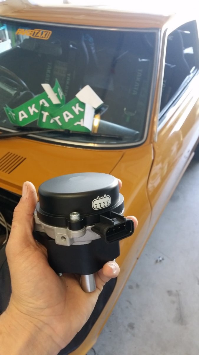

my_mad_z Posted June 24, 2019 Posted June 24, 2019 Hi Matt, I have seen something pop up on Facebook about replacing the distributor with a CAS and it uses the existing distributor mounting location but I can't recall the name of it; so far all I've managed to find is this: I can't recall who made the one I saw, if I come across it, I'll add the link to the post. As Gav suggested, eBay US. If you want a trigger wheel, I've seen this: https://hokeperformance.squarespace.com/store/l-series-crank-angle-sensor-kit Hope that helps. Marc. Quote
Chris'Z Posted June 24, 2019 Posted June 24, 2019 OneSix Industries (look at them on FB) for the thing Marc is talking about. Quote
Administrators gav240z Posted June 24, 2019 Administrators Posted June 24, 2019 Interesting looks like an RB CAS? https://www.onesixindustries.com/product/nissan-datsun-l-series-crank-angle-sensor Quote
jeff43 Posted June 24, 2019 Posted June 24, 2019 More info about them here, 24+1 trigger. Check out from 7.50 on the video. Quote

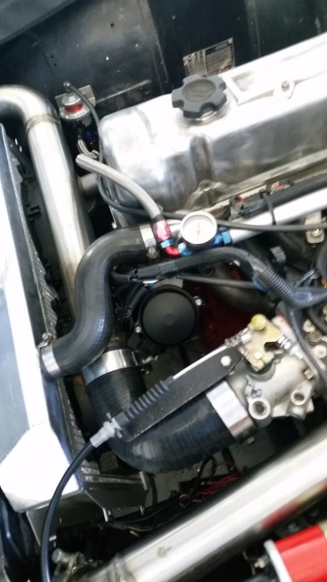

Clarky93 Posted June 30, 2019 Author Posted June 30, 2019 Thanks for all your replys. i ended up going the cas. gav240z and jeff43 2 Quote
Administrators gav240z Posted July 1, 2019 Administrators Posted July 1, 2019 Which ECU are you running? Quote
Clarky93 Posted July 1, 2019 Author Posted July 1, 2019 Ems stinger v4, pretty old school, if it doesnt work out i will go haltech 750 Quote
