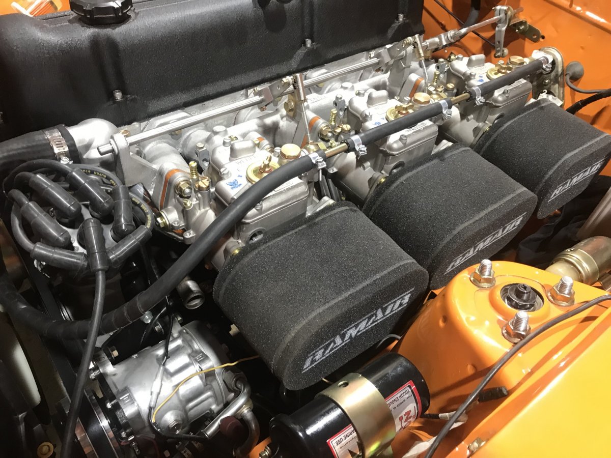

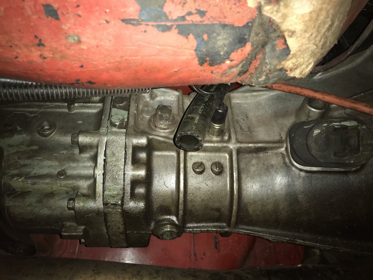

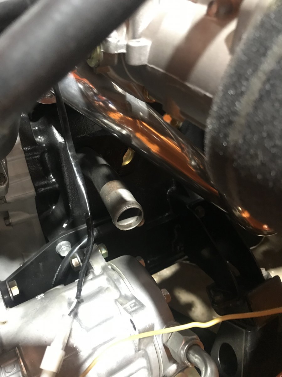

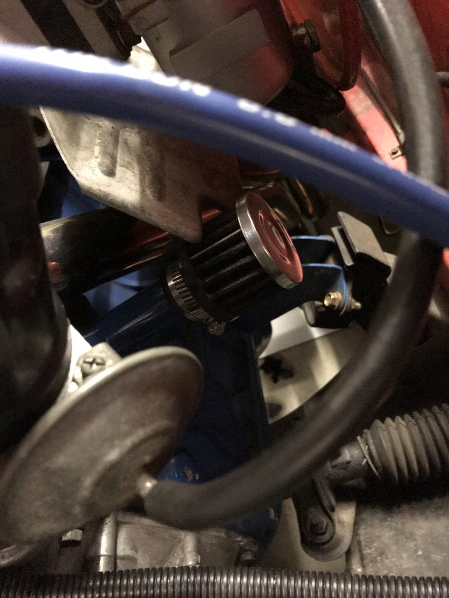

greggy2710 Posted August 30, 2018 Posted August 30, 2018 I’m after some advice, suggestions what other people have done with the engine breather when using triple Webber’s, as per in the attached photos. I’m concerned about putting a filter next to my extractors. Any photos of what other people have done would be appreciated. Thanks Quote
260DET Posted August 30, 2018 Posted August 30, 2018 Can't it be remote mounted using braided line? Quote
TOO60Z Posted August 31, 2018 Posted August 31, 2018 Run hose to catch can and vent from there and include rocker cover vent as well. Blocking the breather is not the option you are looking for. Quote
Aaron Neubauer Posted September 14, 2018 Posted September 14, 2018 I run a K&N style filter from the breather with Zstory headers. Daily driven for a few years and not a problem with the filter. The system is a legacy from when I had triple DCOEs but I now run round top hitachis on the stroker motor. I also run a road draft pipe from the rocker cover down next to the gearbox to stop crankcase vapour pooling in the filter and dripping out. It’s tech from the 50s but its doing the job until I can force myself to get a proper catch can system. Quote
