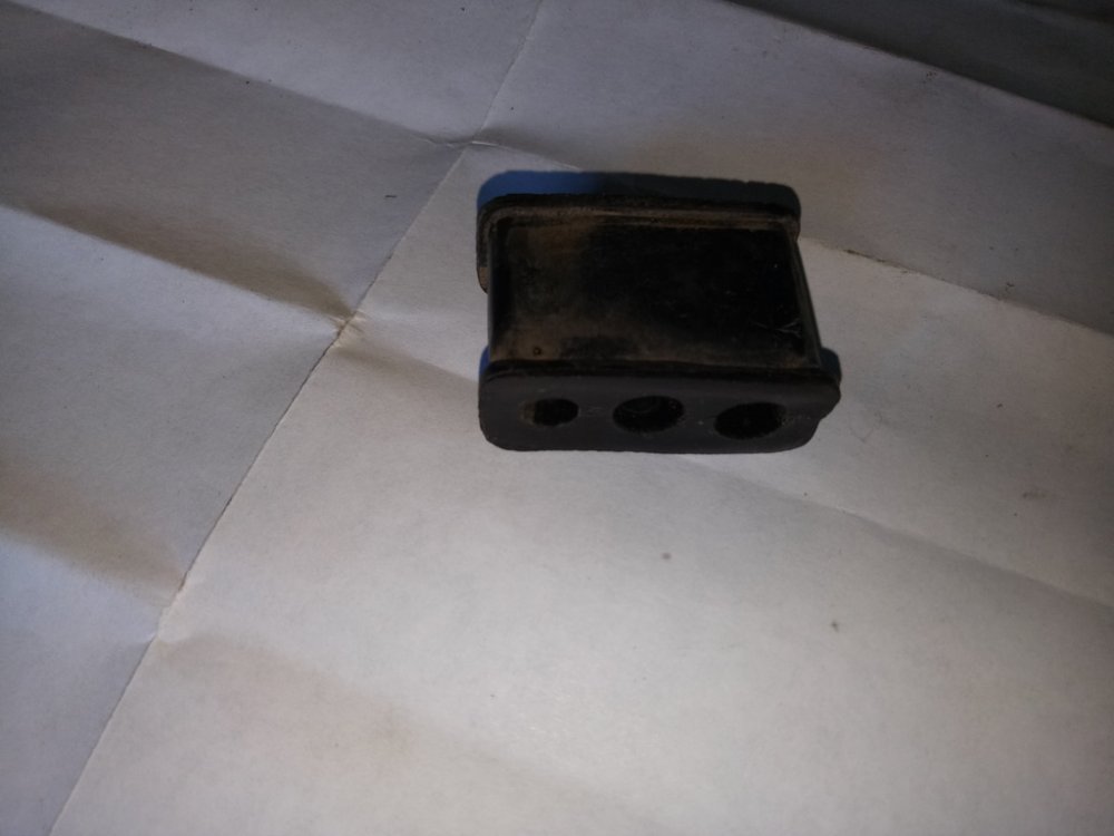

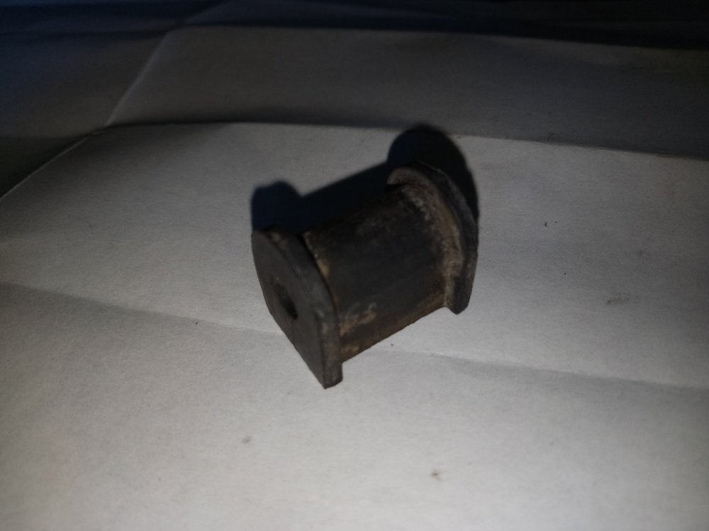

Groundhog Posted April 6, 2018 Posted April 6, 2018 (edited) Has anyone found a source of insulator rubbers (photo below) that fit the original engine bay 3/16" brake line P-clips? Anyone had them remade out of polyurethane?I see the ZCar Depot sells a 240Z Fuel and Brake Insulator kit made out of polyurethane. They will not sell the insulators separately even though it contains the P-clips that I want.Will purchase if you have some OK ones. GH [/url ] Edited April 8, 2018 by Groundhog Quote

Groundhog Posted April 9, 2018 Author Posted April 9, 2018 Like other Zed stockists they will only sell the complete kit for a 240Z.I'm looking at 3-D printing these clamp rubbers as that way I can make as many as people want for not a lot of $'s. Step 1 is getting an accurate CAD drawing file. Quote
Groundhog Posted April 17, 2018 Author Posted April 17, 2018 Step 1 complete 3-D printing tonight to check material and finish. There are lots of filaments available. It's a matter of trial and error to get one that best mimics the rubber look and spreads over the tubing. RAP260 1 Quote
gilltech Posted April 17, 2018 Posted April 17, 2018 Awesome work. Are those the 4 variations found on your car, a '77? Quote
Groundhog Posted April 17, 2018 Author Posted April 17, 2018 (edited) No. Only three of them are from the 77'.The two fuel hose block only suits early NZ 260Z's.The small single brake line clamp suits 240, 260, 280Z's and probably some other Dats I am yet to discoverGH Edited April 17, 2018 by Groundhog Quote
