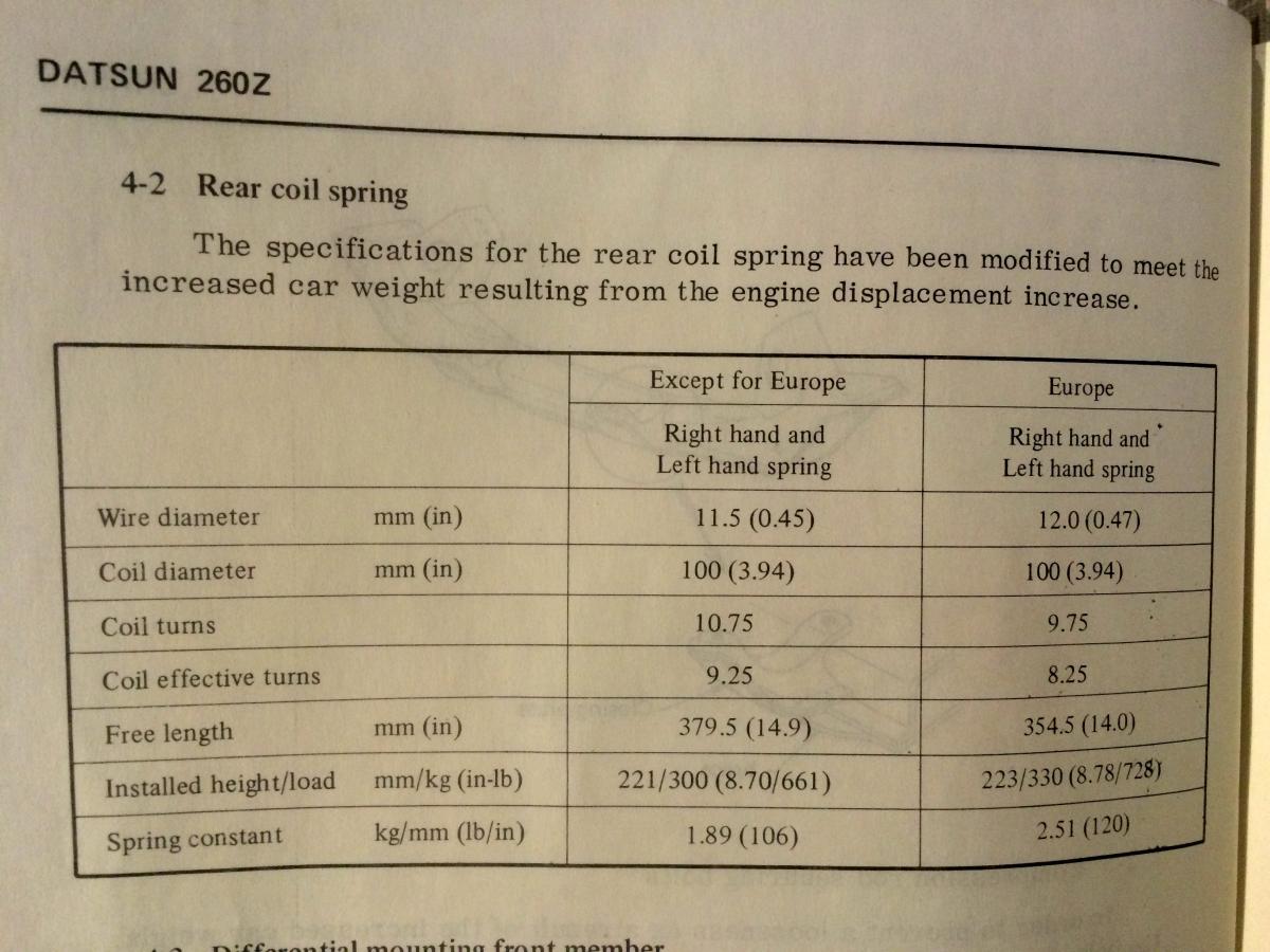

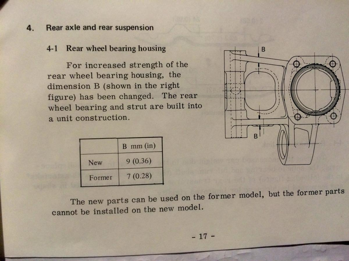

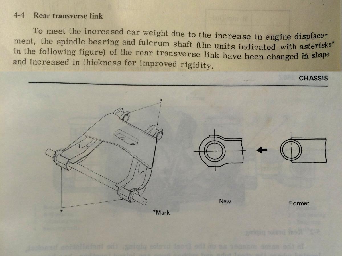

AndBir Posted October 13, 2017 Posted October 13, 2017 The pics below outline some rear suspension changes mentioned in the Datsun 1973 Service Bulletin covering changes from the 73 240z to the first model of the 260z : Quote
gilltech Posted October 13, 2017 Posted October 13, 2017 As the previous owner doesn't know which model/year 260 the spares came from, the best thing you can do is compare them against the equivalent 240Z parts (which year is it?) and see what matches and what doesn't. There are many differences across the various Zed years not just spring rates/lengths but strut lengths, strut diameters, strut caps, front hubs, brakes and more as AndBir above has tabled. Quote

aircobra Posted October 14, 2017 Posted October 14, 2017 as above. front and rear struts are longer, disc brakes different, other parts same eg suspension arms, etc Quote
