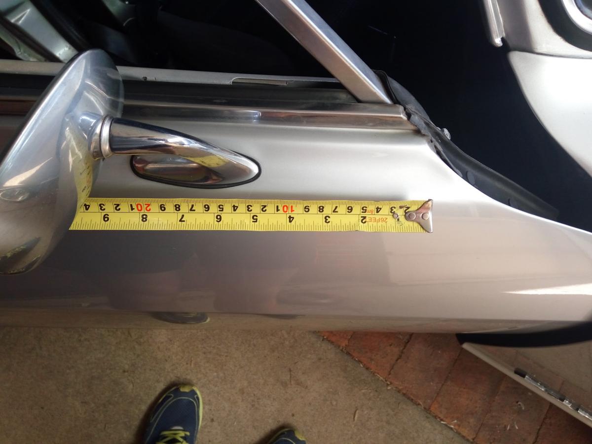

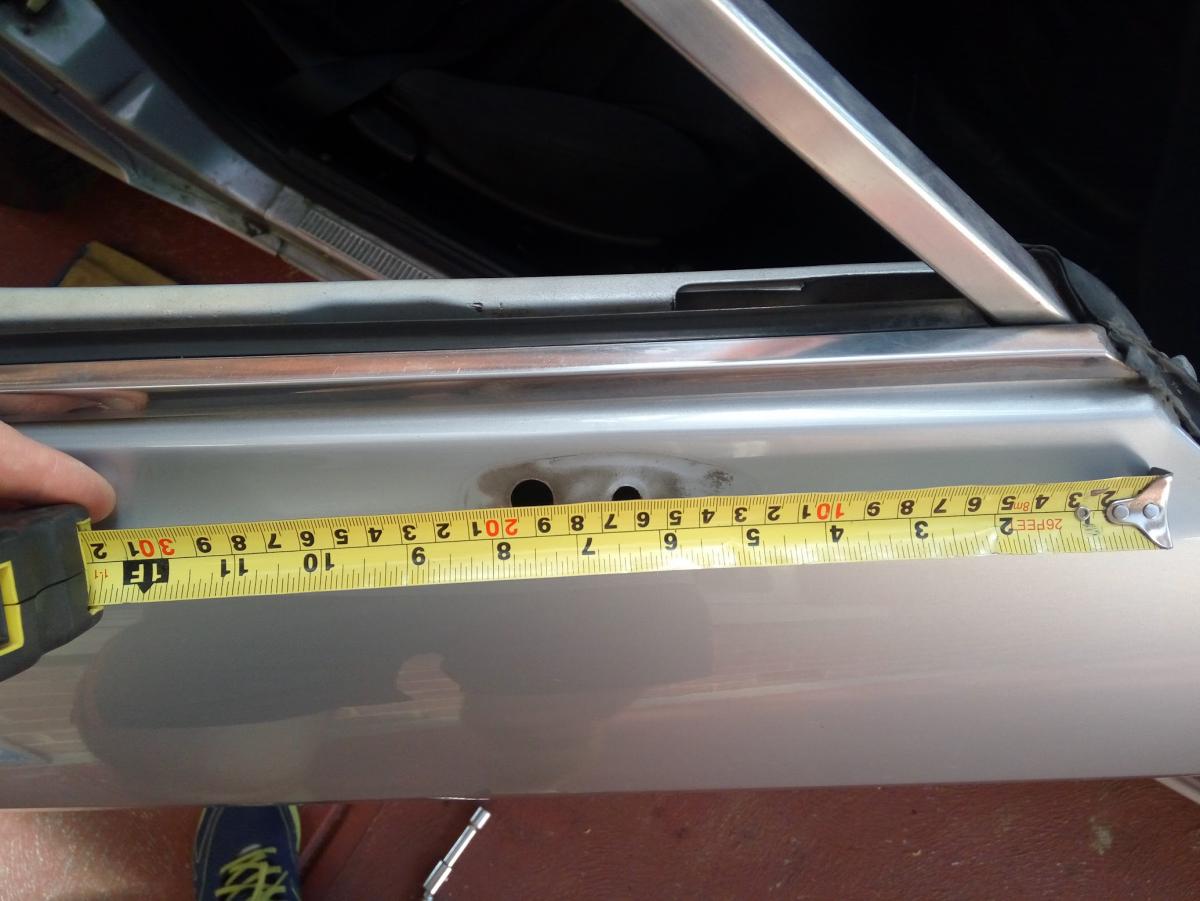

cracker Posted July 15, 2017 Posted July 15, 2017 Australian models (and all RHD models, I believe) only ever came with a drivers side door mirror, fyi. Your LHS mirrors will not fit/work correctly on the RHS but they'll get pretty close. These are photos I took when removing my factory door mounted mirror a while ago. Good luck locklock and gav240z 2 Quote

aircobra Posted July 15, 2017 Author Posted July 15, 2017 thank you cracker, car looks in awesome shape. is that an original RH mirror, or a swapped LH one? i've seen a couple of articles where people have made a customer made "pedestals" to alter the angle of the mirrors. i will probably do the same question for people who have BOTH original mirrors - are the dimensions the same? RH originals are NLA - at any cost. Quote
