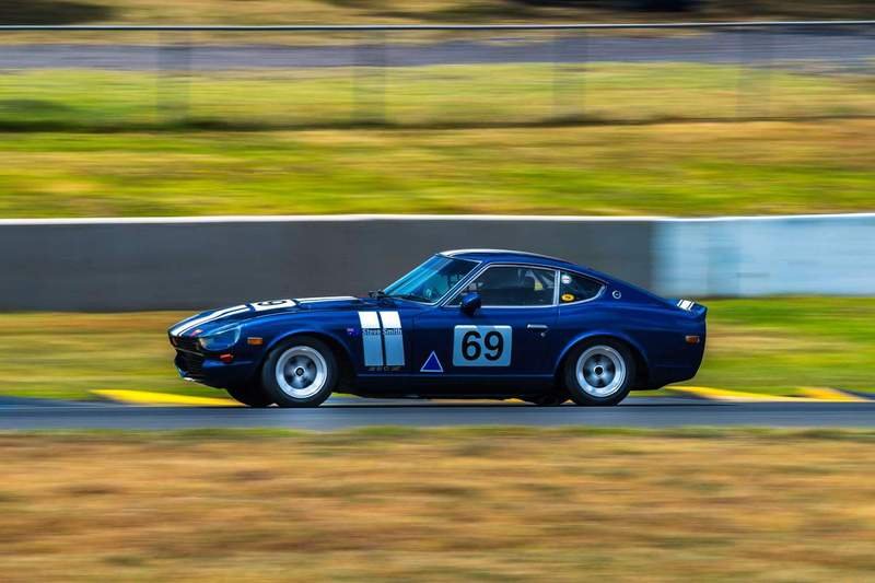

Brett240 Posted October 31, 2016 Author Posted October 31, 2016 (edited) pretty sure this was in practice photo courtesy of Daniel Walters from facebook Edited October 31, 2016 by Brett240 andyk_79 1 Quote

260DET Posted November 1, 2016 Posted November 1, 2016 Zed seems to be handling nicely in that ^ pic. Quote

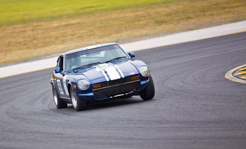

Brett240 Posted November 2, 2016 Author Posted November 2, 2016 (edited) first race on sunday in the dry after finishing 6th in the wet on saturday. Edited November 2, 2016 by Brett240 Quote
