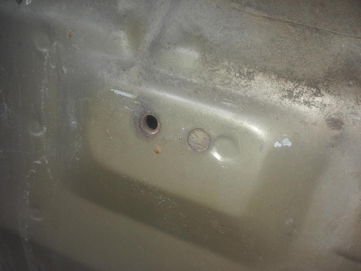

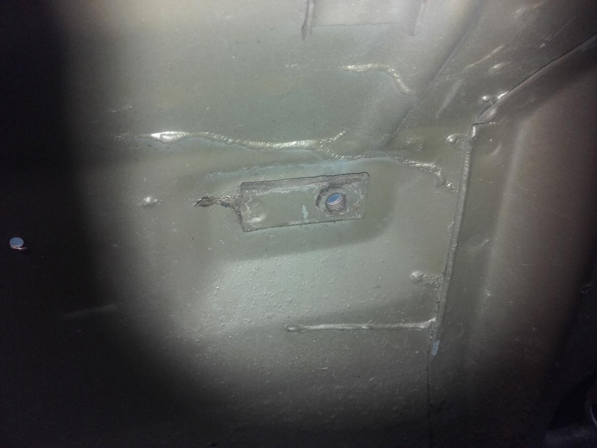

Scoota G Posted September 16, 2016 Posted September 16, 2016 (edited) Just let you guys know there are other mounting holes there you just have to drill and tap them. I'll go get a picture. Edited September 16, 2016 by Scoota G Groundhog 1 Quote

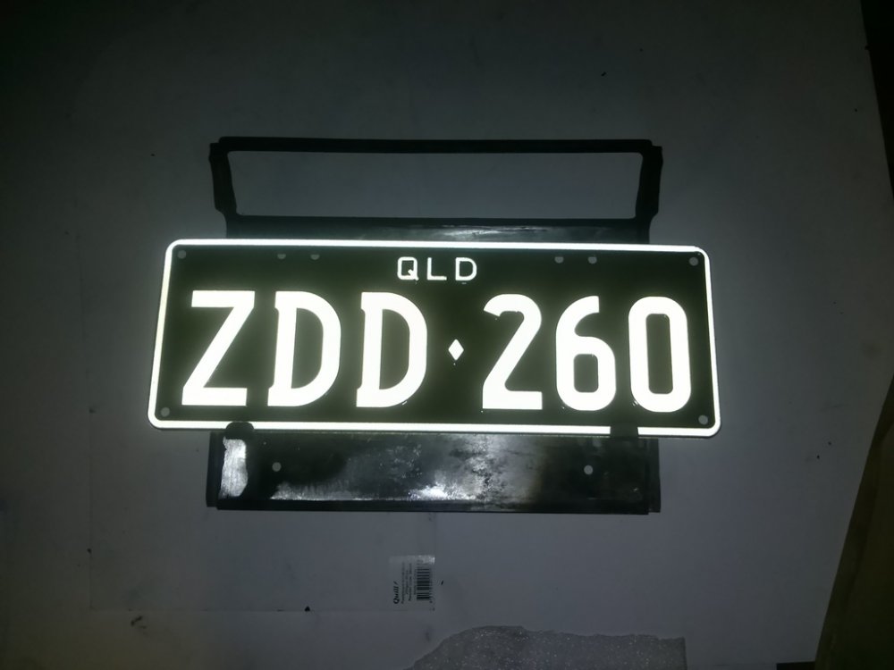

Groundhog Posted September 16, 2016 Author Posted September 16, 2016 (edited) I've modified a spare number plate mount to accept the Qld plate.I drilled out the two tabs. moved them up and brazed them back on using a small piece of metal strip,. Part of the reason for messing with them is to make room for a rear facing camera/ parking camera.i'm planning on mounting this under the number plate.I can clearly see the extra mounts to be drilled out for the top two screws on the number plate. Thanks ScootaI have an original mount if I decide to get a Japanese style plate which I am told are due out soon in Qld. Edited September 16, 2016 by Groundhog Quote
Cozza Posted September 16, 2016 Posted September 16, 2016 I'm intrigued by the rear camera concept. My experience is that the front bumper and nose of bonnet are always the ones to suffer parking damage not the rear of the car. Are you placing a camera on the front too?? Nice number plate mount though. Quote
