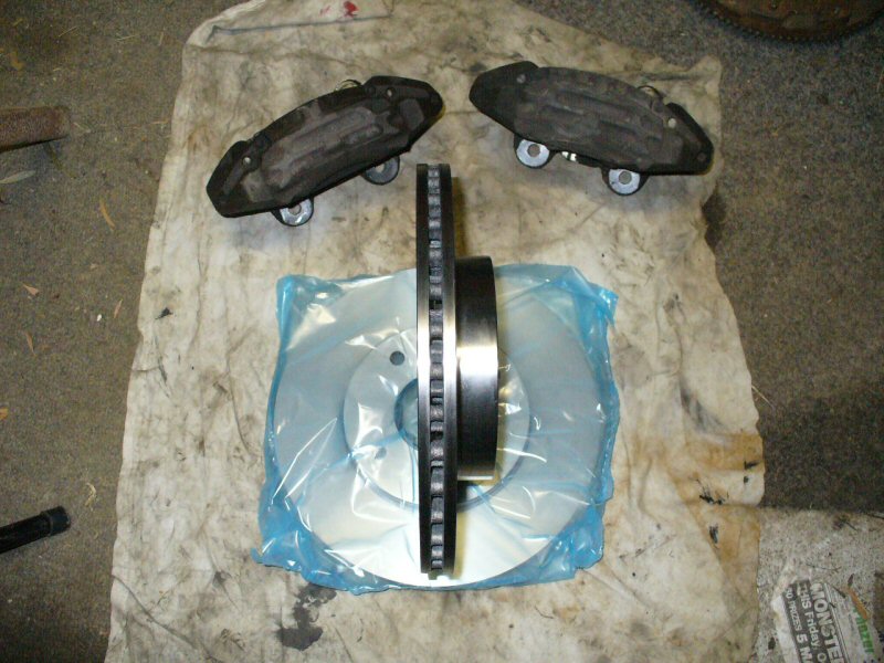

luvemfast Posted November 28, 2008 Posted November 28, 2008 This is going to be interesting... Tis that the Hilux upgrade? What size rotors you got? I'm a tall bugger & they have more headroom Your not that tall are ya? Just a bugger! I, like Dimitri, have had to lower the seat in my Z's. Helmet hits otherwise. Quote
C.A.R. Posted November 28, 2008 Author Posted November 28, 2008 Tis that the Hilux upgrade? Indeed it is. What size rotors you got? 280mm S13 jobbies. Your not that tall are ya? Just a bugger! I'm 6'4 - it's a bugger being this tall sometimes I, like Dimitri, have had to lower the seat in my Z's. Helmet hits otherwise. Quote

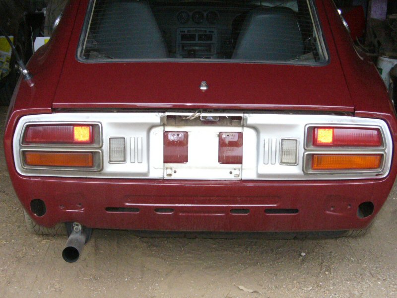

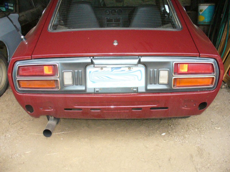

C.A.R. Posted December 17, 2008 Author Posted December 17, 2008 I finally got around to doing a job I was putting off - repainting the rear tail light panels. I'm fairly pleased with the results! It's not perfect, but neither is the car... The old paint was stuffed, & I hated the colour to boot! I spent $55 on paint at Supercrap Auto consisting of: Plastic surface primer (it's clear, not like normal undercoat). 'Gunmetal' topcoat. Clear coat. I then sanded down the surface (trying to get rid of the cracks, chips & flaking paint etc) with 240 grit paper. Then wiped it all down a couple of times with some prepsol/thinners. Applied a couple of coats of primer, then colour. Next day I hit it with the clear coat. Before I installed the lights back in the surrounds, I polished up the chromed sections with 'Autosol'. I thought the chromed plastic was stuffed, but it turned out to just be really badly tarnished (And yes, the Bus needs a wash). Quote

C.A.R. Posted December 18, 2008 Author Posted December 18, 2008 I've also just fitted a 15/16" 280ZX M/C I just reco'd. I found the pedal to be a bit long in travel after I fitted the S1 280ZX rear calipers & rotors. MASSIVE difference now - no more long pedal or squishy feeling. I'm stoked! Quote

C.A.R. Posted December 18, 2008 Author Posted December 18, 2008 Haha - don't tempt me mate! I'll be going the Porsche calipers on the 2 seater though... I'm currently waiting for Rob C to finished my S13 rotors, so I can complete the upgrade on the Bus. Quote
C.A.R. Posted February 2, 2009 Author Posted February 2, 2009 Quick update. I completed the front brake upgrade just befor Christmas '08: http://www.viczcar.com/forum/index.php/topic,3498.0.html Big difference - stops much more progressively now. Quote
