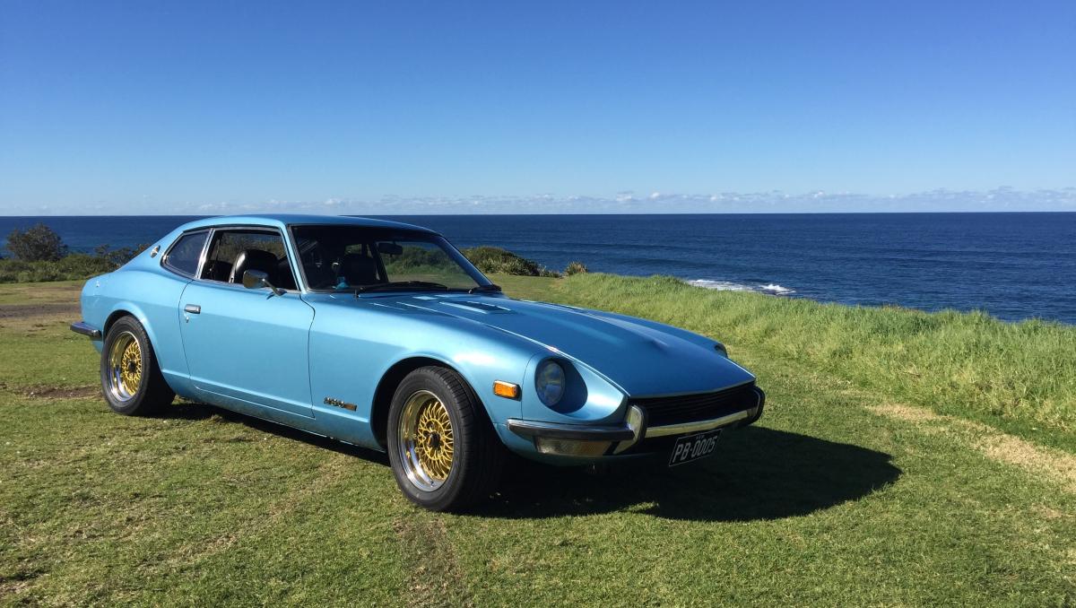

Moderators PB260Z Posted June 9, 2016 Moderators Posted June 9, 2016 (edited) Hi 15" tyres are only available in limited sizes unless you go to expensive heavily track biased tyres I have 15x8 @ 0 with 225/50 and the choice in that size is reasonable Edited June 9, 2016 by PB260Z Quote

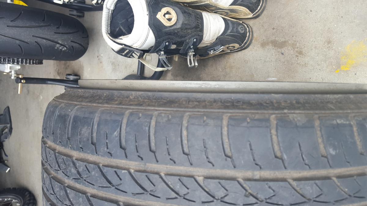

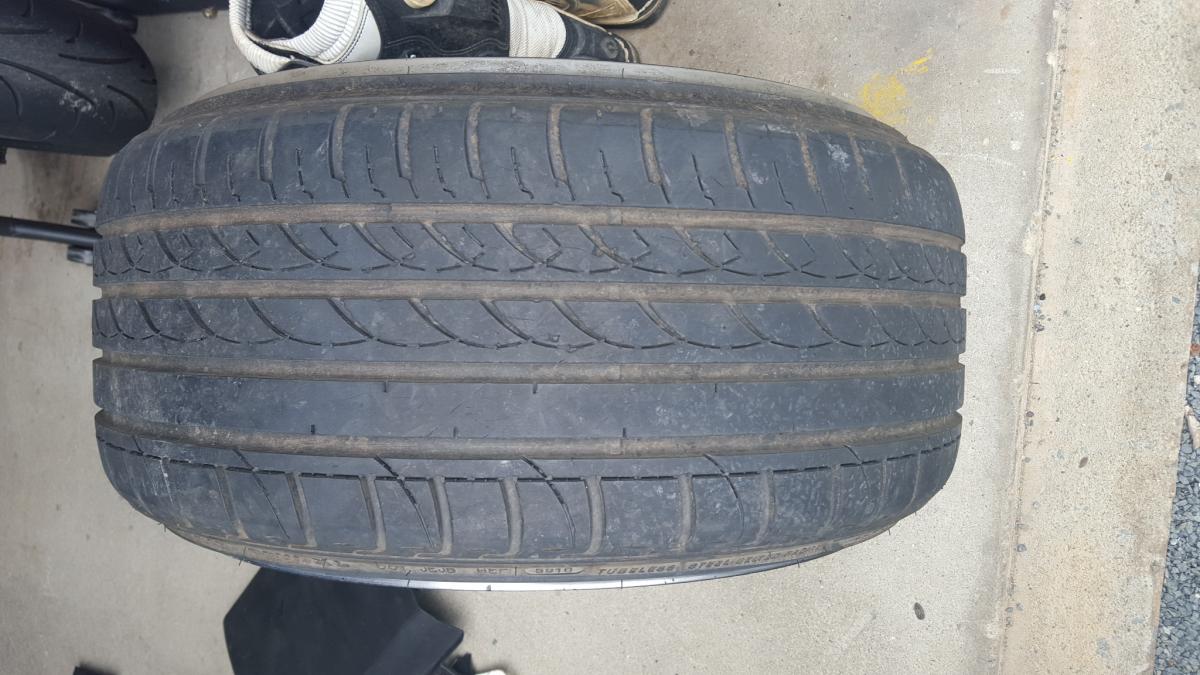

d3c0y Posted June 23, 2016 Posted June 23, 2016 (edited) 225 on a 10" rim although it's a low profile 19... It is completely retarded. Edited June 23, 2016 by d3c0y Quote
ScottyB Posted June 23, 2016 Author Posted June 23, 2016 Not a fan of stretch like that. Pretty much cemented 8.5's or 9's at widest for me based on tyre availability Quote
