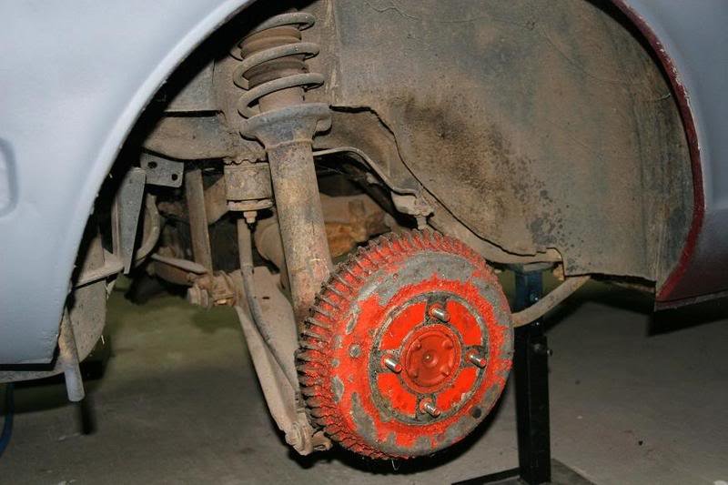

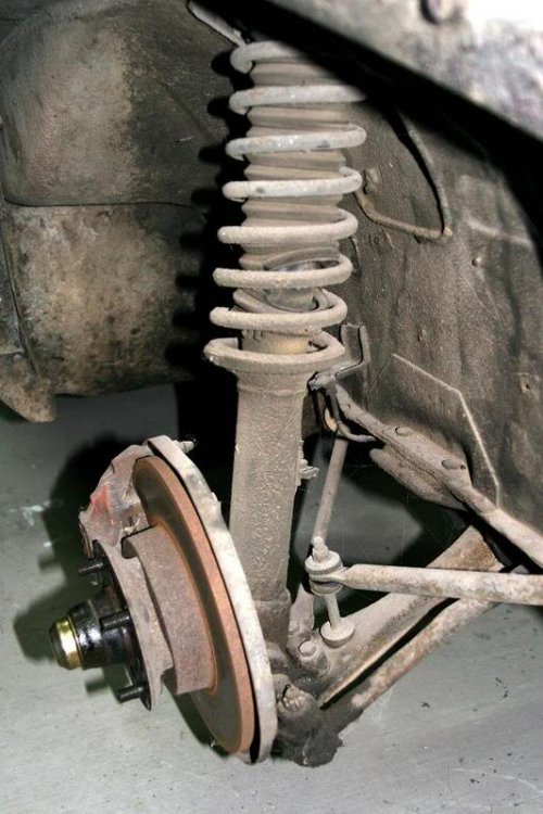

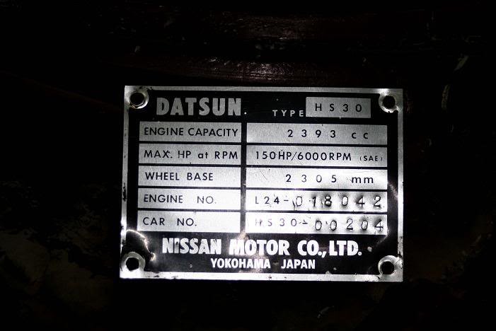

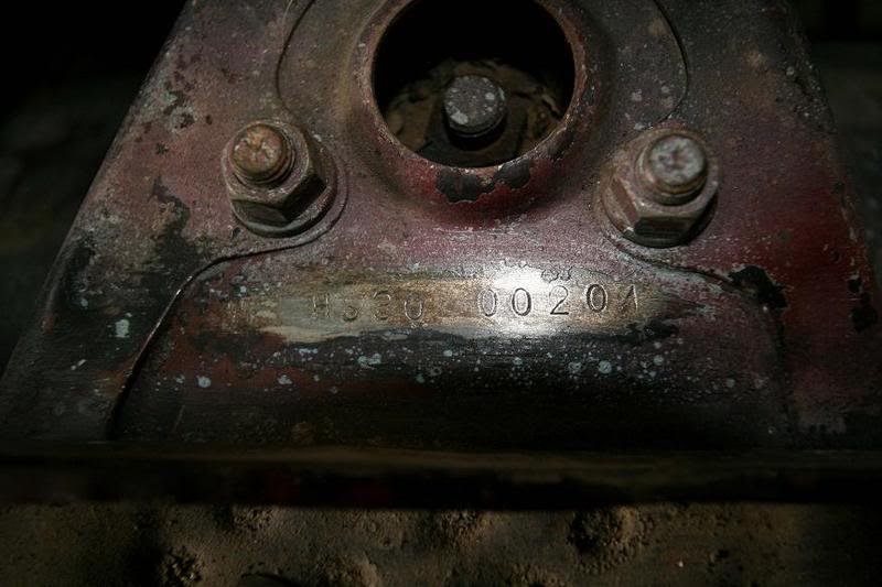

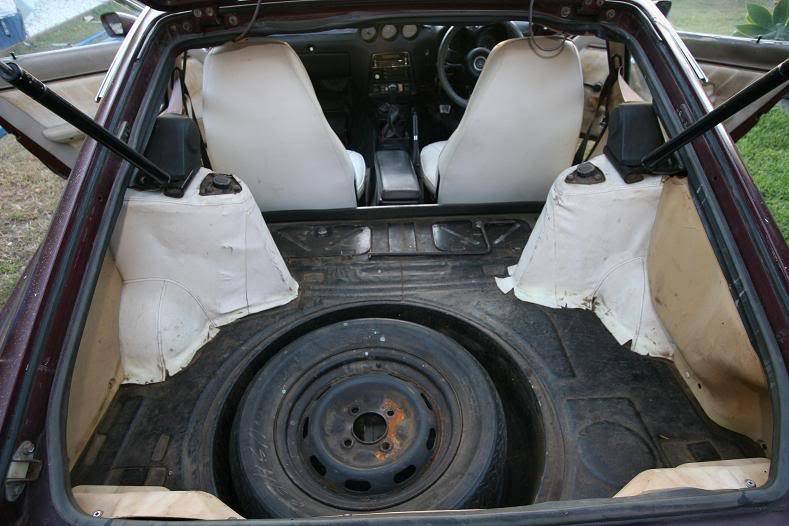

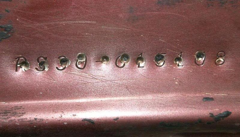

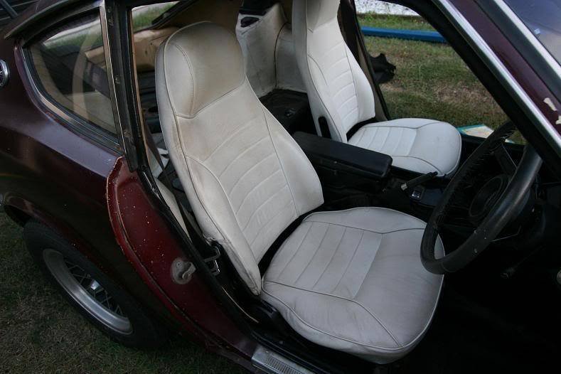

eddii Posted February 18, 2008 Author Posted February 18, 2008 thanks for your input, im even more confused now :'( here are some pics of my car first up the door latch, looks like ive got the d-type latch front strut strut tower rear strut , do i need to take another shot of the rear shock? also to add some more info to my dilema.... the car had been registered to the bloke I bought it from for more than 25 years as a 240z. when i told him that it wasnt a 240z, apparently he wasnt aware of it.... hmmmm. i thought i'd snatched a great deal cause the compliance plate and rego cert stated that the car was built 204. When I started pulling it apart that i found the VIN no. different to the compliance plate To put another twist to my story, I later found another VIN no. stamped in the driver side front strut tower. this time it was a 240z VIN no (HS30-00204)!!! Now nobody knows the history of my car and im not sure how much of the 240z parts went to this car. i'm in the process of pulling out the shocks. looks like i have to do some measurements to find out what i've got. what a mess LOL. Quote

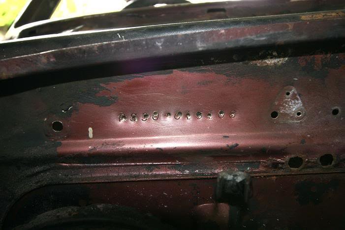

Administrators gav240z Posted February 18, 2008 Administrators Posted February 18, 2008 What a mess indeed Eddii. To be honest looking at your car I'm so confused, only explanation I can think of is the car was rebirthed. It doesn't look like an early 240z because the tool stowage area is there. You have a 240z dashboard, yet you have 260z strut towers (you can tell because they are longer) and it has the seatbelt retractors. The door catches appear to be later 260z type. Like a series 2 77 260z style latch. The fact that the RS30 number has been drilled into looks very suspect. Can't tell for sure but the struts look lower (perches) indicating a 260z also. Door trims are definately 260z type and the strut tower vinyls are also. If I was to guess I'd say your 260z is a later model 260z probably 76 / 76 series II and someone has gone to great lengths to make it into an early 240z. The early 240z was probably a car in a wrecking yard and for whatever reason (suspect or not) someone has tried to badge your car as something else. Quote

Moderators Zedman240® Posted February 18, 2008 Moderators Posted February 18, 2008 Definately a late 260, with those door latches and retractable seatbelts. Do you know if he replaced the suspension as well? measure the diameter of the struts and that will tell you if the driveline has been replaced or not. Depends on the laziness of the person who did the repairs! Front hubs are 260 and your enterior trim is 260. You even have that emissoin crap "bulge" behind the trim where the fuel filler cap is... Quote

Mr Camouflage Posted February 19, 2008 Posted February 19, 2008 Drilling out the chassis numbers of cars is also something the crooks do to rebirth a car. The stamping on the strut tower is a fake. Wonder what happened to the real HS30 00204? Its definitely a later model 260Z chassis, as it has the taller rear strut towers. Also has a 260z seats an steering wheel, but with a 240Z dash. What engine does it have in it? The same L24 thats listed on the vin tag? You should measure the struts, as it might have 240z front struts and 260z rear struts. Quote
eddii Posted February 19, 2008 Author Posted February 19, 2008 if i was the crook i would grind it off but since it was drilled out but the numbers are still visible then im assuming that it was done the legal way....i hope. the police already checked out the drilled out vin no and they didnt find it in their database as stolen. they said i can get a surrogate vin when it is time to go back on the road. also my engine matches the plate - which is an L24 as for the struts, they are 55mm all around. i guess it is a late 260z suspension then. thanks eddii Quote
