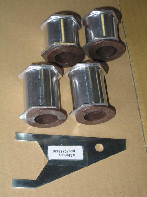

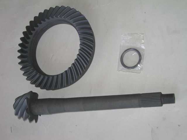

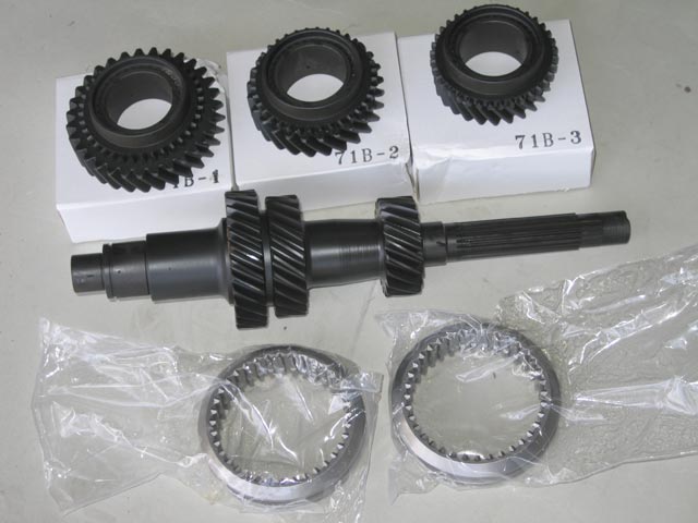

BenZed Posted June 24, 2008 Author Posted June 24, 2008 Here's my latest failure to save money The three photos are things I ordered from Kameari in Japan. The diff gears are 4.875:1, (39 to 8 ) which will be a big change from the factory 3.9:1 gears in my R200 diff. Hopefully I can get them in before tomorrow afternoon so I can get straight back to the track and test them. The gearset will take longer. This set replaces the firs three gears to create a close-ratio gearset. I also ordered the optional WPC sleeves at the bottom of the photo which are meant to help smooth shifting between these three gears. Note that the Kameari gears come with a special black coating known as solid film lubricant. The ratios are 2.624, 1.814 and 1.316. The last photo is a set of offset rear control arm bushes, which were supplied by Kameari but it turns out they're made in Florida. These allow you to correct the rear toe, to what extent I'll soon be able to tell you. Quote
Aaron Neubauer Posted June 24, 2008 Posted June 24, 2008 That is so car part pornography!! I'm keen to see the results as I was thinking of straight cut gears and evening up the ratios. Quote
nat0_240_chevZ Posted June 24, 2008 Posted June 24, 2008 how much for the r200 diff gears landed??? aswell as the g/box gear. yea sux about the bushes being ex usa, i could have told you taht, is why i was suprised that you said they were from kameari!!! nat0 Quote
Administrators gav240z Posted June 24, 2008 Administrators Posted June 24, 2008 Those gearbox parts are very porn! Good to know you can get some of that stuff for the old L-series. It is L-series gbox parts right? Quote
BenZed Posted June 25, 2008 Author Posted June 25, 2008 how much for the r200 diff gears landed??? aswell as the g/box gear. yea sux about the bushes being ex usa, i could have told you taht, is why i was suprised that you said they were from kameari!!! nat0 Diff gears are $1400, close-ratio gears are $2100 (first three gears). I can also get 5.143:1 diff gears for the same price. Quote
BenZed Posted June 25, 2008 Author Posted June 25, 2008 Those gearbox parts are very porn! Good to know you can get some of that stuff for the old L-series. It is L-series gbox parts right? Yes, the 71B box used in the L-series. I can also get them for the FJ20 versions of this box, plus the SR20 and RB20 versions of the 71C box. Quote
BenZed Posted June 25, 2008 Author Posted June 25, 2008 I am stoked to report that My Zed ran a 12.834 second pass tonight at 103.92mph with a 60-foot time of 1.682 seconds. The 4.875:1 gears were almost too short as I had to change into second almost immediately and changed into fifth before the line, but the 225/50 Hoosier drag slicks did what they are designed to do and delivered an awesome 60-foot time. I think a 4.4:1 rear end would be the ideal compromise for this car, saving the extra gearchange before the line and probably launching better too. However I doubt if I will drag-race this car again as it was never built for this purpose. Quote
