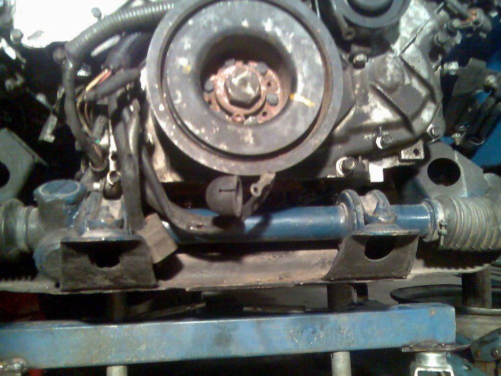

nat0_240_chevZ Posted May 24, 2008 Posted May 24, 2008 ben looks like il be moving my stering rack down not to decrease/eliminate bump steer but to get the vh45 down about 10-15mm lowere, as x-member sits about 30-40mm+ lower than the rack mounting brackets!!!, a worthy mod indeed in this case you'll see what i mean and it really isnt that hard at all, i will document (with pics ) the process to do it simply and mantain the stock mounting rubbers & steering shaft (just new clamp brackets) see pic nat0 Quote

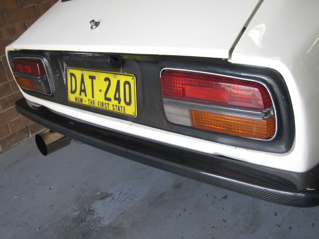

BenZed Posted June 18, 2008 Author Posted June 18, 2008 Just fitted the carbon tail-light garnish from Restored to my car. The original garnish is 1.33kg, compared to 250g for the carbon one, but at $500 I have to admit I just did it because I like carbon Quote
Aaron Neubauer Posted June 18, 2008 Posted June 18, 2008 That looks hot! I wondered what the carbon fibre surrounds looked like on a car. How 'fat' is the zed now? Quote

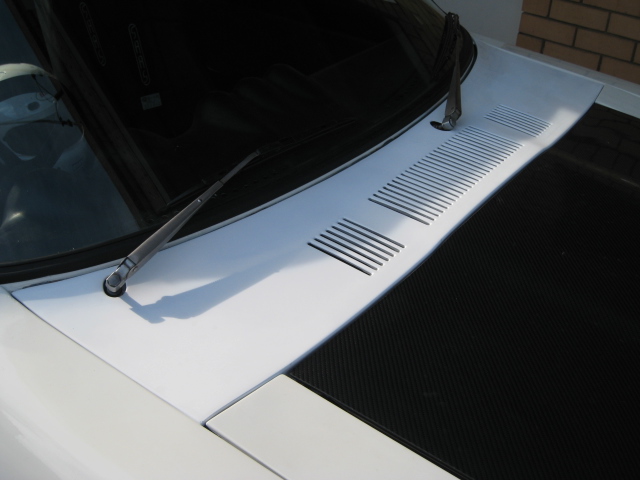

BenZed Posted June 18, 2008 Author Posted June 18, 2008 Thanks. Here's another bit I bought from Kameari. The original cowl panel was 2.28kg, this fibreglass one is 1.36kg, so it saves less than a kilo, but on the plus side it fits perfectly. Quote

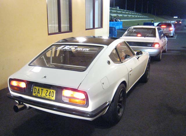

BenZed Posted June 18, 2008 Author Posted June 18, 2008 Took the Zed to WSID today to do some quarter mile runs. The best was a 13.66 at 102.2mph, which was with the original 3.9:1 diff ratio. This ratio really kills it, as you barely get into fourth before the line. I'm fitting a 4.875:1 Kameari gearset next week, which should make a big difference. Also had old, stiff A032R tyres on (they were on the Watanabes when I bought them), so the best 60-foot was a 2.04. I should be able to get that down to 1.7 or so with some drag radials. I'm aiming for 13.2 or better from the current set-up. Here's a little burnout video, not sure why the sound is out of sync. Quote

ZD44TT Posted June 19, 2008 Posted June 19, 2008 I got them on Yahoo Japan, but they're also available from Kameari at about $250. sweet..........i'll get the hook up at tax time. did those tyres give you any grip? the tread looks way overdue but the 60ft is ok though. Quote
