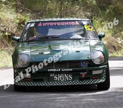

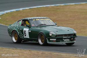

PZG302 Posted January 25, 2008 Posted January 25, 2008 On my racing Z I have a MKII front spoiler and the Nissan Bob tail, as the rules stated at the time the rear spoiler had to be a genuine item. Previous I ran a RX7 series I birdbath. Aside from making the 240 look really tough, well im opinion any way, the bird bath made a huge difference to the aero of the car. After a track session the amount of dirt, rubber, oil and other assorted grime on the rear of the car was incredible. The big wing produced a huge low pressure area behind it and literally sucked the back of the car down. Turn 1 at Eastern creek could be driven on full throttle with out lifting. When we put the bob tail on, we found now where the same amount of down force, or drag. First time through turn 1 I tried it flat and nearly speared off down the drag strip as the rear end tried to overtake the front. The front spoiler makes a huge difference no matter what rear spoiler is fitted. My first Z, an ex rally 260 didn't have one and at about 140km'h you could feel the front lifting badly, with the MKII spoiler no problems at all with the front wanting to fly. Quote
