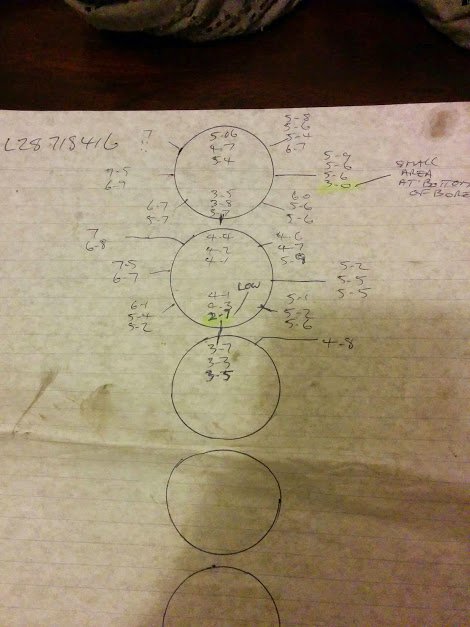

Riceburner Posted May 13, 2015 Posted May 13, 2015 Does anyone know the minimum recommended cylinder wall thickness for an over bored block? I've had one of my spare F54 blocks sonic checked and the figures are 3-4mm, it currently has stock 86mm bores. Quote
Administrators gav240z Posted May 13, 2015 Administrators Posted May 13, 2015 I'll check when I get home but Steve Wilkins wrote down some figures for my F54 block, he stopped after Cylinder #3 because he said it wasn't good for overbore past 1mm. Quote

Administrators gav240z Posted May 13, 2015 Administrators Posted May 13, 2015 I don't know what the unit of measurement is, the writing in the top right says "Small area at bottom of bore 3.0". You can see cylinder 2 had a smaller area at the bottom of 2.7. Quote

C.A.R. Posted May 13, 2015 Posted May 13, 2015 (edited) Gareth, you need a minimum of 120thou bore wall thickness AFTER boring to your desired size.'Correctly' sonic testing the block before boring to pinpoint the thinnest part of the bore, is the only way to determine where you can bore & how big you can go.Check out this photo of a L28 block that Les milled the top off:(Don't despair - that block had a dirty great big crack running along the deck between the stud holes. It was only ever going to be scrap).It's standard 86mm bore N42 block & if you look closely you can see how much core shift it has in the bore walls.After going through & sonic testing 10's of L28 N42 & F54 blocks for customer stroker builds, Les has found no difference between the two types of block castings in relation to bore thickness's.'Most' L28 blocks can safely be bored to 88.5mm (some like Gav's can't), a very small number can go to 89mm, and I've only seen two that can tolerate a 90mm bore safely (Owen's and the US L34).It's just all pot luck - you can can't tell until the block is acid bathed & sonic tested. Edited October 26, 2015 by Lurch ™ Quote
