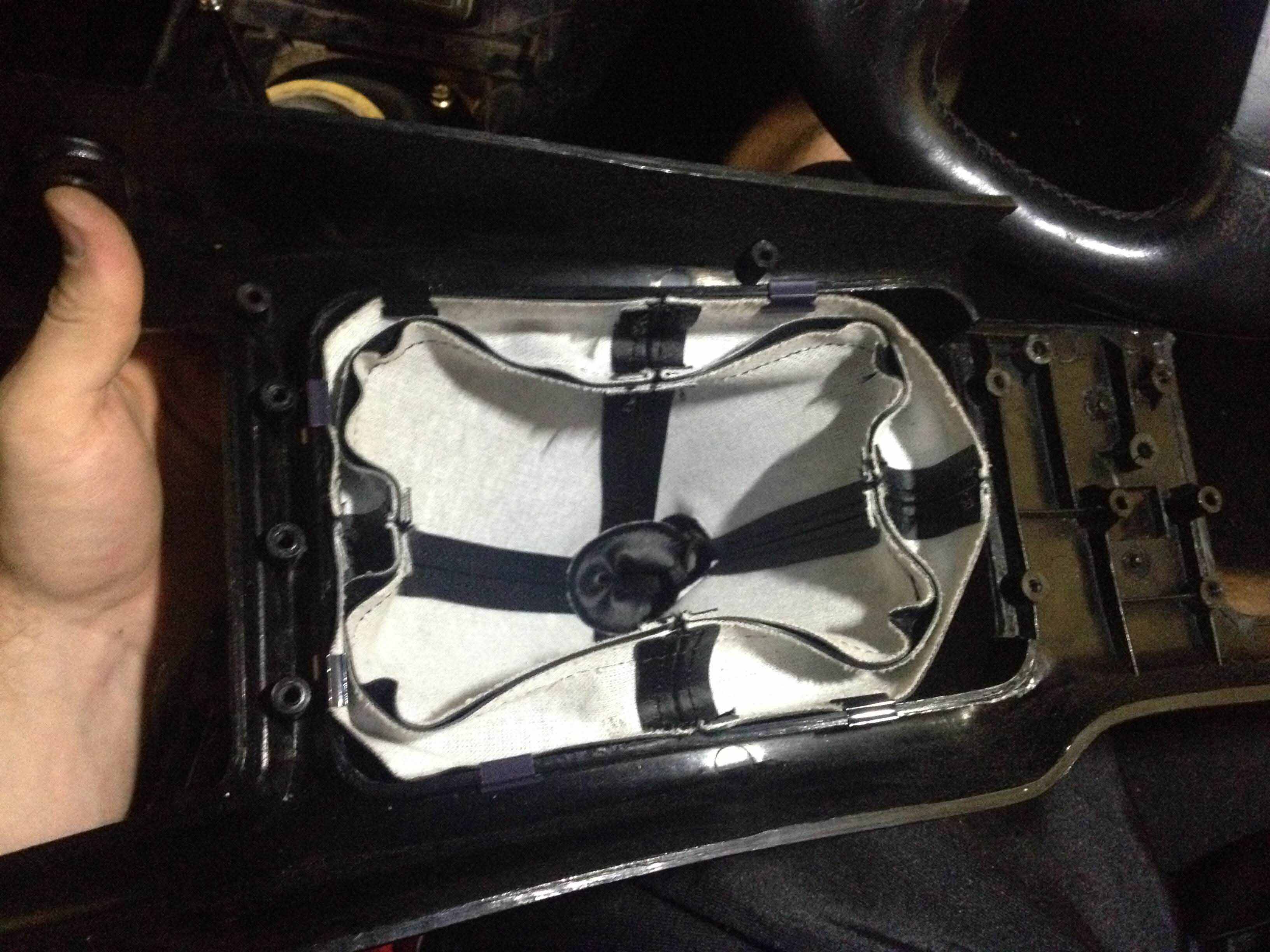

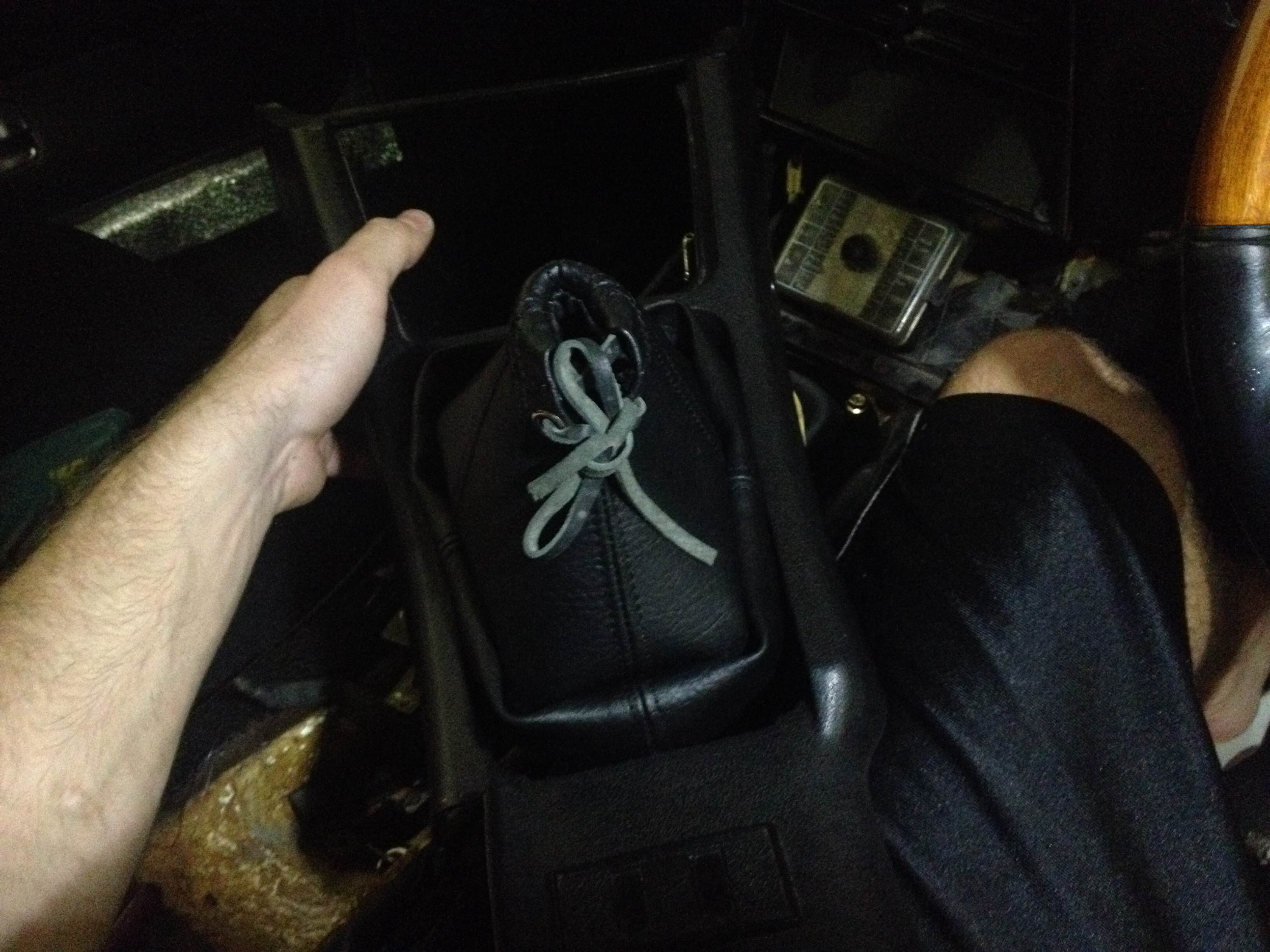

theremm Posted May 5, 2015 Share Posted May 5, 2015 Hi all, I just purchased a genuine Nissan leather shift boot after just converting from auto to manual, however I am unsure how to correctly attach the boot to the centre console. I don't have the genuine clips, so am making do with stationary supplies... Can anyone share a picture showing how/where they are meant to be attached? I can't seem to work it out.. Note in the attached photographs that I have folded the bottom of the leather boot in half, however it doesn't look right from above.. Quote Link to comment Share on other sites More sharing options...
Linton Posted May 5, 2015 Share Posted May 5, 2015 from what mine looked like you haven't got enough of the lower edge folded over the lip, if you get a bit aggressive I would bet you will pull the flap out of the clip. Use a hair drier to warm up the leather it will help stretch it into place if its a bit tight. Quote Link to comment Share on other sites More sharing options...
Administrators gav240z Posted May 5, 2015 Administrators Share Posted May 5, 2015 You need to fold the bottom part over the inside of the console lip, your boot looks like it's sitting a bit proud / high. The clips may not allow you to attach it correctly? If not you can get genuine ones off eBay US. Quote Link to comment Share on other sites More sharing options...
theremm Posted May 6, 2015 Author Share Posted May 6, 2015 I think the clips I am trying to use are restricting me, they probably are too small. Might have to order the clips from ebay however I was hoping to avoid spending ~$35-50 on such a small item(s)... Take a look at the attached photograph - I think I have worked out how the boot needs to be attached to the centre console. Does this look correct? Quote Link to comment Share on other sites More sharing options...
Administrators gav240z Posted May 6, 2015 Administrators Share Posted May 6, 2015 From memory it looks correct. Next time I remove my console I can check perhaps? But not sure how long away that will be. I do know it's a tight fit for the clips to go on. Quote Link to comment Share on other sites More sharing options...
