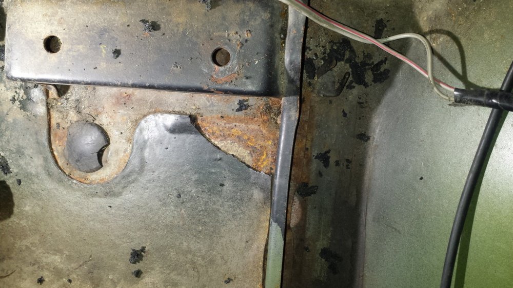

The rust so far is (edit - links fixed):
Small patch on drivers side dogleg which I have followed some advice on here previously

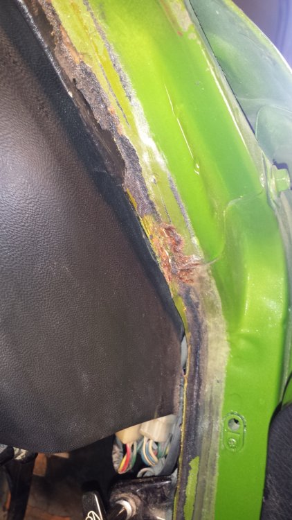

Seam welds on door frames have a few flaky patches:

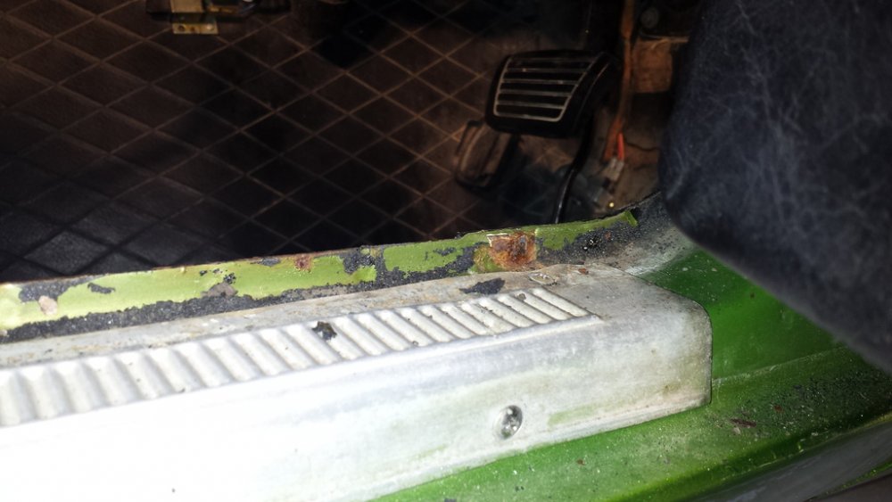

Floor pan had a hole which I also did some temp work on previously, but also has surface rust when floor liner is peeled back
That's mostly surface rust, the A-pillar (dashboard) photo is unfortunately likely to be rusty on the other side (which you can't access) and probably worse than what you see there.
The floor and sill areas look pretty mild, if you rip up the sound deadening and then properly POR-15 it or equivalent product that should take care of it. You may find some pin hole rust, but a MIG welder even in the hands of an amateur would zap that up pretty easily.
None of those areas are seen by anyone but you, invest the money in a manual conversion and enjoy the car. Don't worry about that stuff unless you really want it perfect but I'd save some cash and once you've sorted out other areas of the car and you're ready to pull it off the road do full restoration then.
