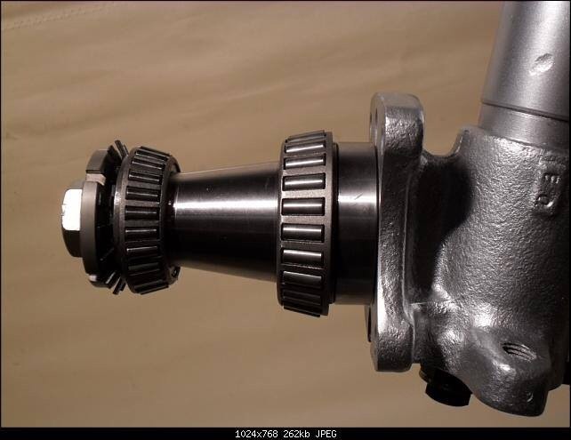

dat2kman Posted February 17, 2015 Posted February 17, 2015 If you are good with front camber settings, get a couple of steel wedges welded onto each strut leg at base to support the stub flange/brake caliper mount ears. Peter Davis Suspension ( rally mob) down there know how to do it, properly. Fully dissasemble and supply them bare struts. Next thing, machine up a stub afle bearing support tube, ( sleeve) very fiddly as you end up taking 2 thou off at a time for final fit and bearing preload. It fits between the inner races of the wheel bearings and acts as a additional support to the stub axle. Have you thrown a dial indicator onto the discs to check runout? An oncar disc skim can do wonders, just disconnect rear driveshaft at outer companion flange to do rears. Booster fitted? The tiny amounts of "play" can add to extra pedal movement. Consider no booster? Quote
luvemfast Posted February 17, 2015 Author Posted February 17, 2015 If you are good with front camber settings, get a couple of steel wedges welded onto each strut leg at base to support the stub flange/brake caliper mount ears. Peter Davis Suspension ( rally mob) down there know how to do it, properly. Fully dissasemble and supply them bare struts. Next thing, machine up a stub afle bearing support tube, ( sleeve) very fiddly as you end up taking 2 thou off at a time for final fit and bearing preload. It fits between the inner races of the wheel bearings and acts as a additional support to the stub axle. Got some pics to help me follow, where you're going Jason? Quote
dat2kman Posted February 17, 2015 Posted February 17, 2015 Above is not Datsun strut, but shows the thick tapered inside/outside sleeve, that slides over stub, it has to be placed inside the hub before you slide it all on, and then fit smaller outer bearing and do up nut. To the right, ( imagine a Z strut) the vertical bit of forging, that caliper bolts to, in a Z, is higher than this pic, You get two bits of trapezoidal shaped 4mm plate, and fit between vertical plate and strut tube. Weld all around. This mod stops the stub mounting from flexing AWAY from strut when cornering, and using 9" wide stocky rubber. The stub wants to tuck under, ie go into positive camber, due to weight transfer and forces exerted. The dirt rally boys did the plates thing to stop stubs from gending upwards ( extreme negative camber) on hard landings on jumps. Reverse for circuit. Quote

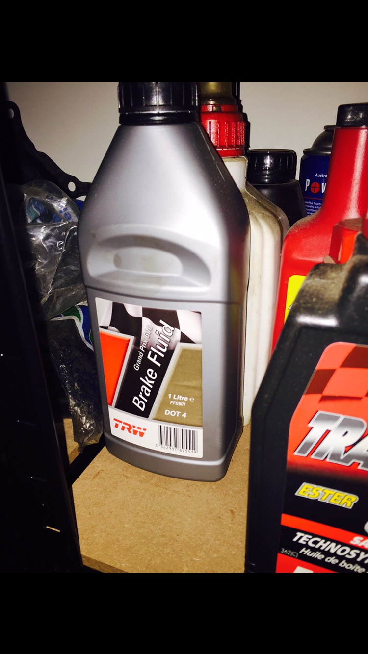

PZG302 Posted February 24, 2015 Posted February 24, 2015 Unless it is still in a bottle with an unbroken seal, don't be using brake fluid that has been lying around the shed. If you have to buy new fluid, the Penrite race fluid, was called sin, not sure what it's called now, will do what you want to do. Quote
