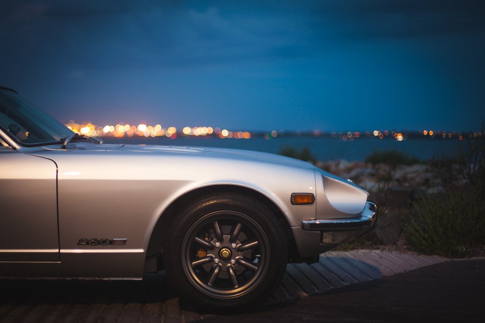

I have the same wheels as you, they are bare or "raw" alloy which are not painted. Some wheel cleaners can stain that kind of finish, it's what I believe happened to mine, and prob yours too. I've been told just wash them with whatever you wash your car with-mild soap, no "wheel cleaners". So I had mine repainted as well, pics courtesy George:
