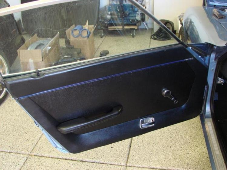

nizm0zed Posted July 11, 2014 Posted July 11, 2014 Dont the doors have a bow in the centre of the panel, eg, the sides of are still all one reasonably flat panel? Edit: added pic. You'd almost be better off making a press for the masonite. Make a buck and plug mold shaped like the panel and then sandwich the masonite between them. Just wet it then add weight to the top of it, maybe 1-2 kg? let gravity to the work for you. If you designed it right, you could do FG skins off the mold, so you could cater to the original type bloke wanting something factory correct, or you do FG for the guys that want to go lightweight or strong. Quote
